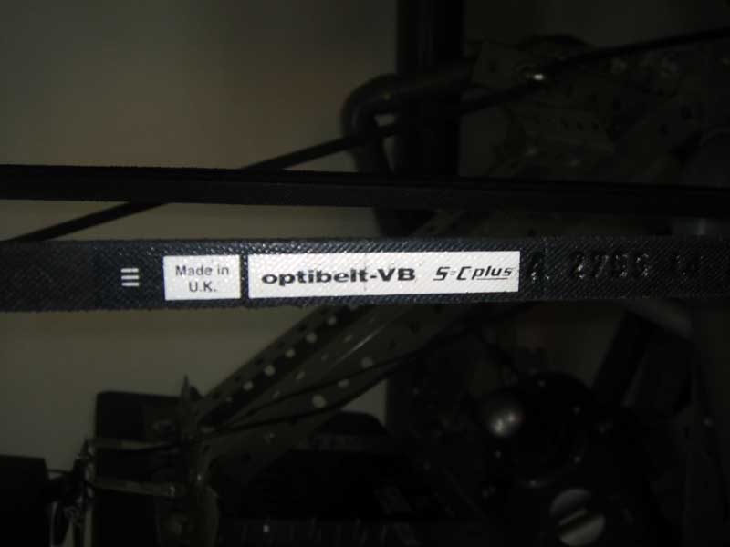

    Some updates... after a very long time. Let's see if i can finnish it on the next year! :D

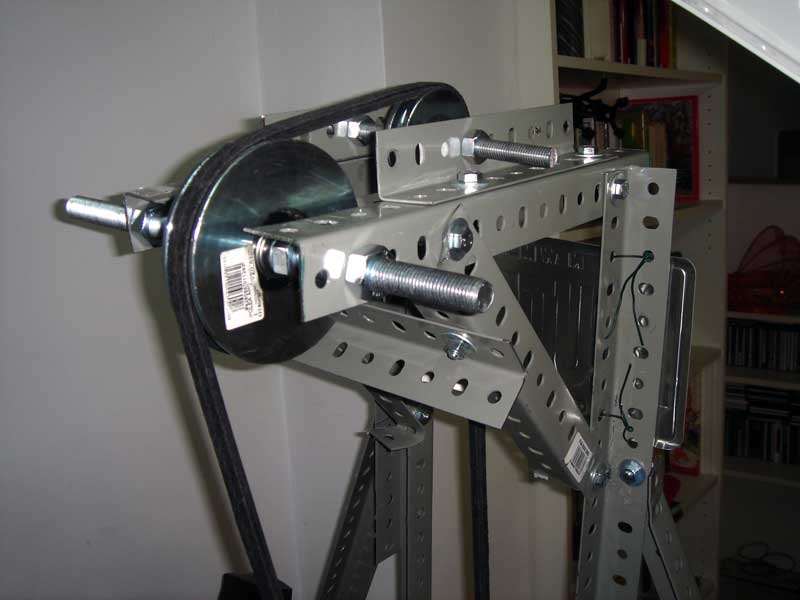

    Finally i found the belts i was looking for. The brand is optivelt, and the catalog is here:
    http://www.optibelt.de/fileadmin/bilder ... DFs/VB.pdf
    Those are the perfect one for my pulleys, and the best of all, they are cheap (12€ each) and very easy to find. There are a lot of different lenghts. In my case, 2735mm the longest and 2530mm the small one.
    Choosing the right lenght of the belt is crucial to keep it tighten. This is how it seems in my joyrider:

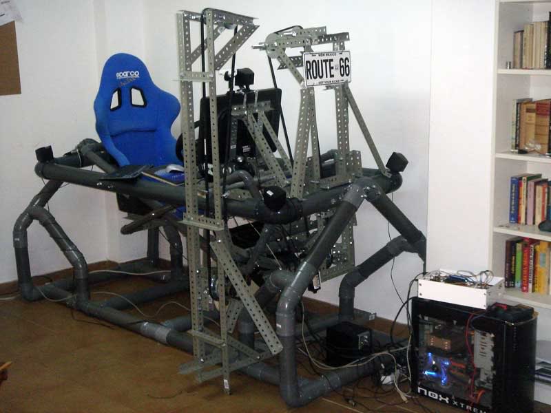

    For the end, just an updated picture of my project taken today. I've mount another frame to allow the Y motor be inside the tube instead the outside. Things became a little unstable the way i began, so i changed it some time later.
    Some more news in following days.

    I don't know why TronicGr didn't use the chain, but for me, mainly is for the way you tighten it. Remember our project is based on those pre drilled shelves. i didn't want to spend time doing the calculations to match the shelve's holes with the holes needed to attach the sprocket, and remain the whole thing very tigth.
    Also, the catalog of the belts i've posted before has almost 100 different lenghts. I have never worked with chains, but i guess you have to cut it with the chain-breaking tool... too much for me :)
    The weigth is another positive point for the belt. The noise, the need to keep it lubricated... seems something a little bigger for my project. And talking about the price: 5€ pulley + 11€ belt. I don't know how much will it cost the chain and the sprocket, but it was easy to find the pulleys and the belt.
    Of course, the easiest way was with the iron cable, but as TronicGr said, he had some problems keeping it tighten. The belts are meant to be used exactly for what we are using them.
    Regards.

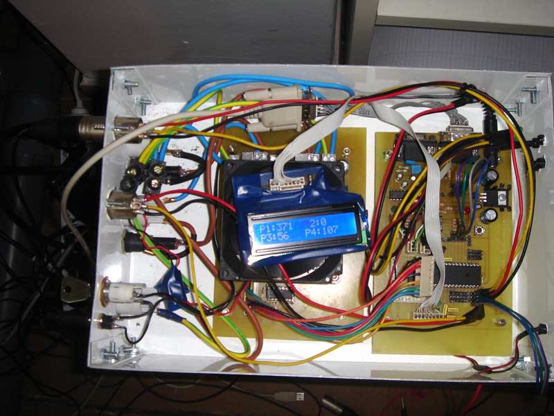

    I have ordered a new sets of PCB (AMC + Dshb) to Platinenbelichter for a friend.
    This is the mail i sent as suggested by egoexpress:
    Don't forget to attach the pdf's files!
    The cost: 33,40€ shipping to Spain included. Not too expensive... if you don't have the time to do it from scratch (my case). This is the first time i order PCBs, until today i managed to do it by my self. Anyway, i think you can use the mail above if you want a brand new one PCB.
