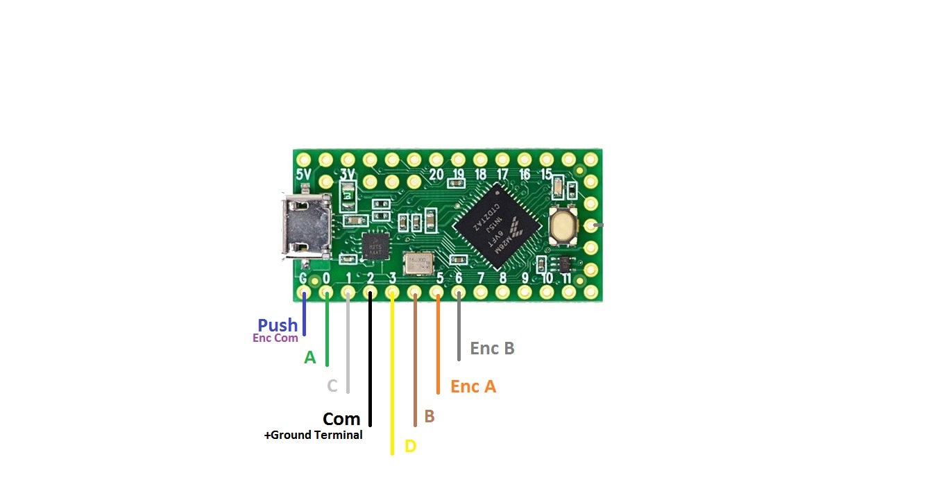

    I would very much appreciate that, There will likely be standard N/O push buttons on all the other pins with a likely hood of needing another encoder added in and maybe even a 3rd encoder(but unlikely) 2 is more than enough for most guys on the wheel. Encoder's being used will be CTS 288's so simple 3 pin hook up.

    Question, How can we improve the signal strength of the Rotary encoder on the Alps.....watching the Controllers window closely it seems to miss some clicks when i rotate the knob, it will be consistent for a few clicks then miss one or 2.
    Ive also now joined the Ground terminal to the com to eliminate one more wire....everything seems to work fine still.

    The code needs optimisation. This tactics is not so good. I forgot to tell you that.. Encoders need to be read with interrupt rutines (when a pulse gets to the teensy the program stops and executes another smal program an then it returns to where it left of). This way no pulses are lost.
    But with interrupts you MUST debounce the inputs with capacitors and resistors!!
    Another theory is that only one pulse from the encoder is used to do the blinking. The other one is used just to see in what direction you turned the knob. Maybe there is no way to eliminate this...
    I will edit the code and try to improve it and i will add other NO inputs and one more encoder..
    Do you have a multimetet? I can read color codes from my head but alot of time i just measure;) (dont hold the resistor when measuring with both fingers, if you have a large value resistor you will also measure your body resistance ;) )

    Hmm then it must be a software problem... I have a mechanical encoder but the Detent points are different from yours... I will try to fix it in a few hours :)

    Please download the attachement... This is only a Encoder test... everything else was removed for easyer trouble shooting
    Encoder is connected the same way (5 and 6 pin) please test and report back if it is better or worse

    Ok so rolling to the left gives me input 11 lighting up but if i roll it 2-3 times quick I will get a hit on the Right Direction #12....if I roll right No matter what i do, I Do Not get a 11 glitch, So something is different between the left and right encoder

    i went back and forth between 2.1 and 2.2 its marginally better, but not i question how sensitive the game will be to those micro presses, I really need to fire it up, IN game and see how it responds to those mis clicks.

    I will post the complete version.. But I doubt we can get a better response...
    The main problem here is the encoder.
    There are two types of encoders , mechanical and optical.
    Mechanical have problems with debounce because they have switches inside that get pressed in a certain order when you turn the shaft.
    Optical encoder work differently. They have a glass dick inside that has black lines on it. They pass trough two light barriers. The fotoresistors record the lines that pass trough.
    Otical encoders don't have debounce problems and can be turned very fast.
    Chinese clones can go up to 5000 rpm.
    In your case i don't think you will find any optical types that include the d-pad.
    But manufacturers typically have these switches custom built and have some kind of pulse shaping schmitt triggers between the encoders and microcontrollers.
    The biggest problem is that I don't have one of your d-pads. So i can't test myself.
    I will post you the complete version amd you will test

    a fellow buddy who's actually making the PCB for this Alps switch has asked me to ask you this.
    "Have you tried running the encoder in Interrupt mode rather than polling ?
    In interrupt mode you wouldn't have the issue of running too slow, you just have to worry about denouncing"
