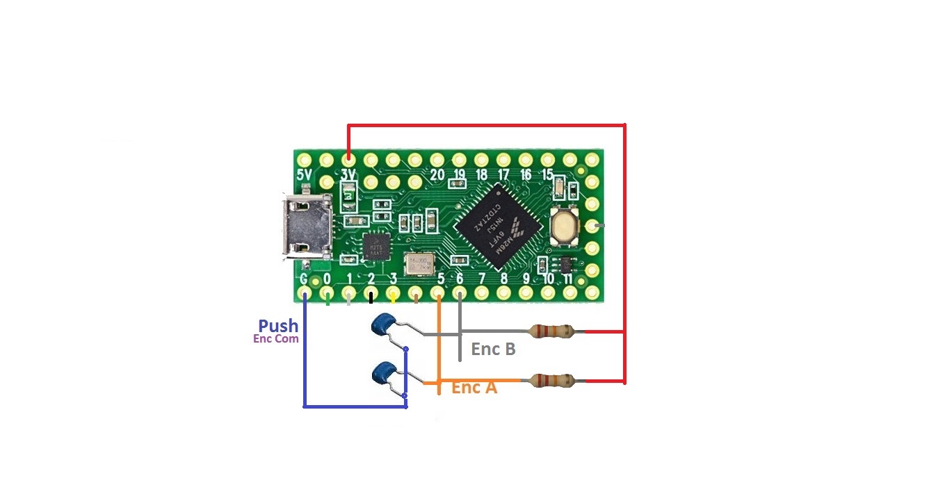

    Yes I made about 3 posts about interrupts:) I was trying to advise you to using interrupts. But you said that you don't want to mess with resistors and capacitors:) so I stopped mentioning them:)
    With interrupts you would chatch every pulse. Regardless of the loop speed :)BUT you need hardware debouncing and not software. That means you would need to add one fapacitor andcone resistor for A and one resistor and one cap for B :) i can show you a schematic on how to do that
    If you don't use debouncing you would most likley get false pulses (if you turn the encoder by one click you could get 2 or 3 or maybe 4 pulses)
    Just say the word and I can make a interrupt driven code:)

    ok lets try some interrupts and get me a diagram for resistors and cap, Sorry lacking the knowledge on what all does what is the only reason i didn't do it the proper way the first time.

    That made it worse and not recognize more then half of the rotary clicks. :(
    I have a friend who is a master at this stuff, and agrees with your Debounce idea, I guess we should proceed with that way then. So I would need a little PCB board and some Resistors...what else ?

    Sorry for a long response I had some work to do :) Anyway here is version 2.4.. thisone uses Encoder library. With my encoder it works but it some times activates the wrong button ( if i'm turning left i see button 11 blinking and sometimes button 12 blink... and the same if I turn in the opposite direction)
    Anyway this is because my encoder had a detent point exactley at the edge of one of the outputs. So if I turn the encoder in one direction and stop, one of the outputs "jumps around that edge.
    Your encoder however should work because in the datasheed I can see the detent points are in the middle of the pulse ... So please give it a try.
    As for interrupt and pooling mode... Encoder library works with interrupts. But this program is not time consuming. I measured the loop time of the program and it was 40uS. That means that the program when it is running can read the state of an input 25.000 times per second. So here if we use interrupts or pooling it doesnt matter.
    You do need to make hardware debounce. If you don't you will most certanly have strange behaviour!! I will draw you a simple schematic for encoder debouncing!

    Simple debounce... Resistors are 22K and capacitor is 100nF this gives us 3ms debounce delay... should work. If debounce time is too smal you can try increasing the resistor or capacitor
