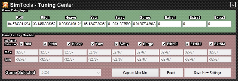

  16. value1
    Jan 9, 2011
    2,192
    Zug, Switzerland
    14,305Coins
    +3,363 / 13 / -1
    @Fraza44
    This plugin is kind of a proof-of-concept.
    It collects the data from DCS, converts it into LFS format and outputs to UDP port 192.168.0.105:25010
    Currently only pitch, roll (bank) and yaw (heading) are implemented. If succesfull, I can implement the other values too (they are currently all 0)
    I have tested the plugin with DCS 1.2.6 because this was available on my PC.
    Edit: 1.2.9 worx too.
    • Open SimTools_PluginUpdater.exe
    • Drag-n-drop the plugin into SimTools_PluginUpdater.exe
    • Close SimTools_PluginUpdater.exe and open SimTools GameManager
    • Patch DCS with SimTools GameManager
    • Run SimTools GameEngine
    • Run DCS
    • If SimTools and DCS connect, you will see flickering numbers in the Tuning Centre
    • Carefully startup your FD301 and see if it connects
    Please report back :)

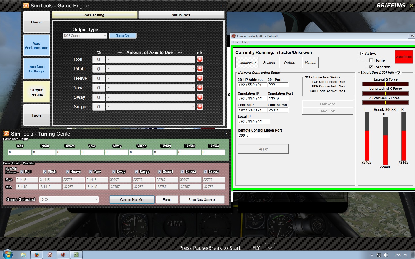

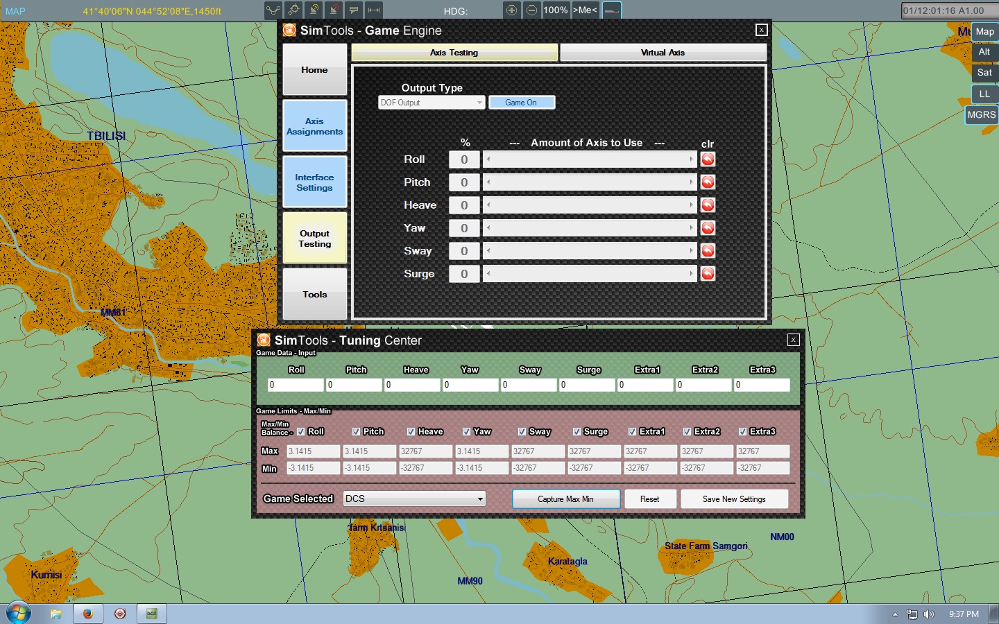

    Value1,
    YOU ARE THE MAN!!!!!!!!! :grin This is the closet we gotten to communication. So here are the results of following your instructions.
    1. As the screenshots will show, I was able to establish comm between DCS and Simtools Game Engine. The "Output Testing" tab showed "Game On" when I started DCS. When I opened "Tuning Center" I could see the Max & Min data, (see screen shot).
    2. Once I configured the Game Engine Network Output with the correct IP and Port number, the FD301 Force Control recognized the IP and allowed data to flow through it to the Platform.
    3. The platform would only shake when I pressed "Fly" within DSC but once I exited the flying it stopped shaking. It did not respond to any movement on the joystick just continually shaking with a very slight bobbing up and down of all three axis. The shaking was not violent but at a level of about 3 with 10 being the machine thrashing and coming apart as a force guide.
    4. It appeared the the platform did not know what to do with data it was receiving. I have not configured any of the setting in the Game Engine because I don't know what the correct values are for allot of the fields, especially the 'Network Output".
    Fraza44
    Screenshot1.jpg Result of DCS to Simtool comms
    Screenshot2.jpg Comm btw Simtools and FD301 Force Control Software
    1. You can see in the Force Control/301 software, in the "Simulation IP" box that it has an IP address. This means it's receiving data from the Simtools on IP 192.168.0.105 (game computer IP), Port 25010.
    2. The IP address 192.168.0.105 Port 25010 is configured in the Interface Setting "Network Output". I don't know what to put for Output - Bit Range, Output - Type and the rest of the fields which are in the Network Output.

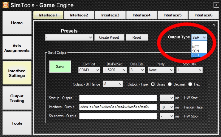

  20. value1
    Jan 9, 2011
    2,192
    Zug, Switzerland
    14,305Coins
    +3,363 / 13 / -1

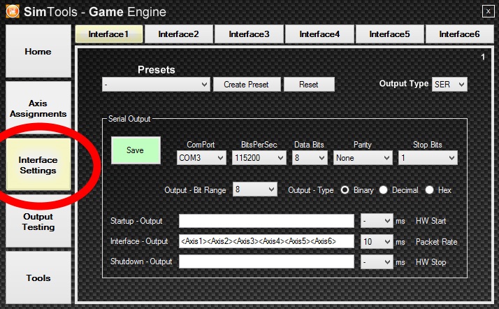

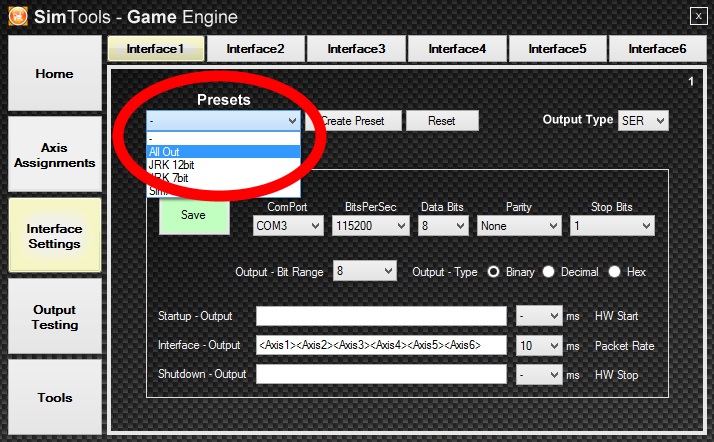

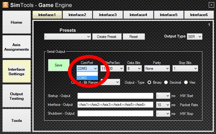

    Hi @Fraza44
    Have you set an interface in SimTools? It's a little counterintuitive but you must assign an interface for SimTools to output the data although you're not going to use it at all.
    • Open the GameEngine window
    • Click on InterfaceSettings
    • Select Output Type SER
    • Select Presets All Out
    • Select any unused ComPort
    • Click on Save
    While flying you should now see changing values in the Tuning Centre:
    With a little luck, your FD301 will move now ;)
