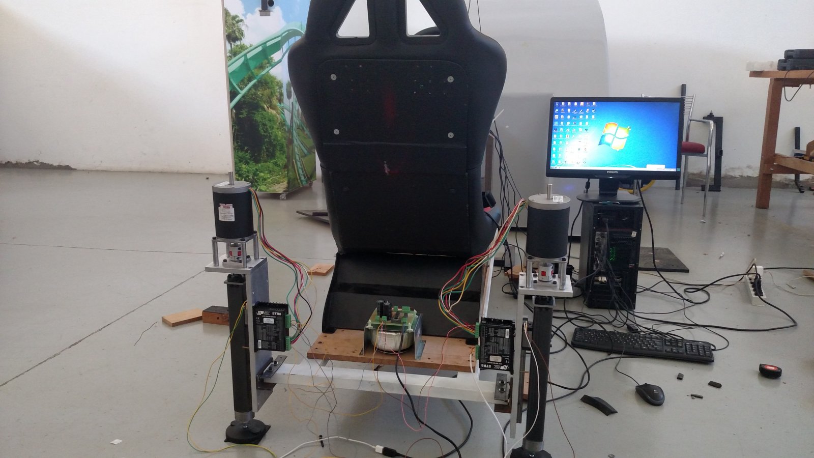

    Hello @mariano68 yes i changed the splind step i was using 4mm/per revolution, and now i'm using 10mm/per revolution
    Hello @noorbeast Thank's for the inrfomation, a check the threads and now i set to 20% (pitch, roll, surge, sway and heave), and adjust the values manually in the tuning center, I will post a video later. Thanks
    Hello @SeatTime :) the noise is because this motor's are little bit big, if I take nema 23 the small step motor you have less noise.

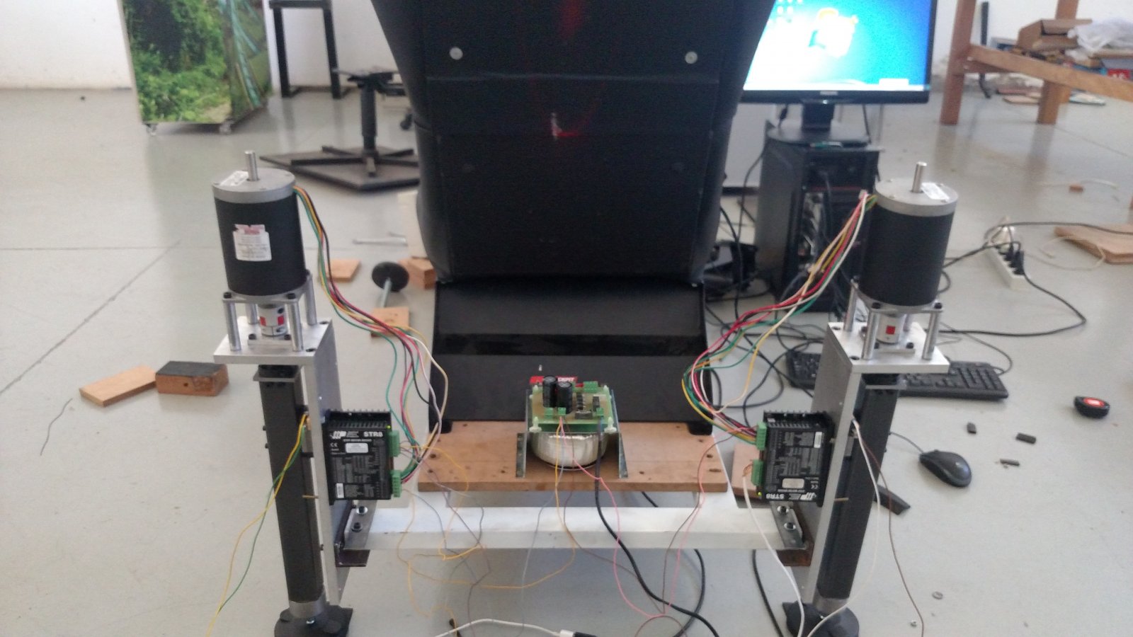

    +98 / 1 / -0
    @mariano68 i don't know with sure because It depends of the number of pulse you program in the drive, i belive that it's arround 5000 rpm like a servo motor, but this kind of motor with you increase the speed you decrease the torque, so we use a nema 34 (http://www.kalatec.com.br/motor-de-passo-5034-349) with 3.15Nm.

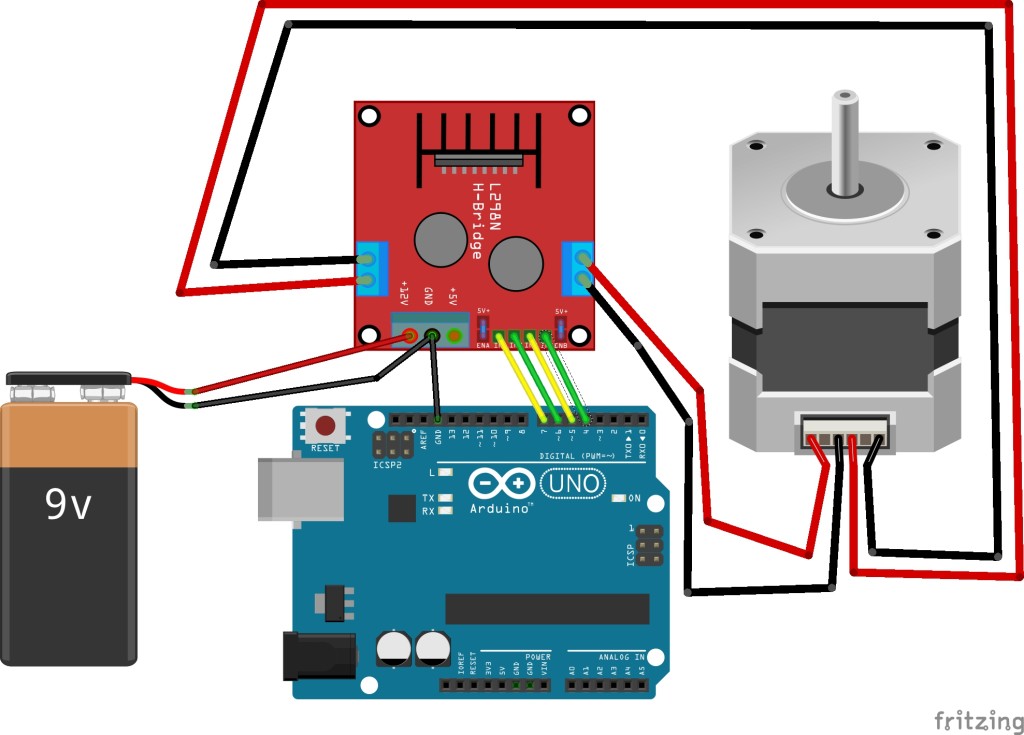

    +98 / 1 / -0
    @ferslash i looked for information about MM's of sparkfun but i didn't find much, but i find this module is like a MM's but to 4A, and it's possible connect the step motor, but we need change the arduino program because to work we need to send commands in (A - A/ - B - B/) , i thinks it's better use a driver to stepper motors.

    Hello Bordiin,
    you have totally right. The stepper drivers you use have sinusoidal outputs and automatic idle-current reduction (for holding positions) and the motors need up to 48V. That can't be done with a MM.

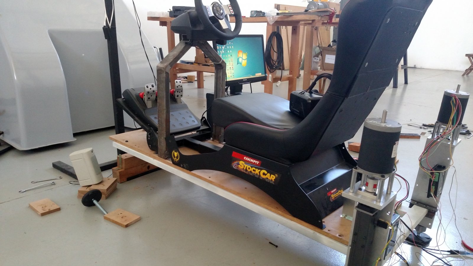

    I contact the brazilian company that sell stepper motors and the max rpm is about to 1200 a little bit more, but you loose torque.
    I'm using nema 34 with 3.4NM and my drive adjust give me 100mm/s, i test with 90kg and works fine. i don't know with we really need 416mm/s.

    +98 / 1 / -0
    Hello @mariano68, i test this morning and the max speed i can reach is 125mm/s more this i started to lose torque, i'm finishing the mechanical adjust and will make a video, but i'm think that is ok with this speed.

    I found this video on youTube that shows the sizes of the various common stepper motors.
    The little one is a NEMA17 witch is used in the SCN5 actuators, the middle one is a NEMA23, used in the SCN6 actuators, and the big one is a NEMA34, used here by Bordiin. Now you can estimate how strong this rig must be. I thought this might be interesting.
