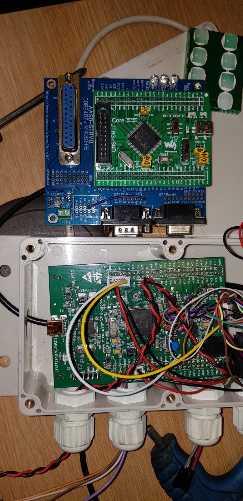

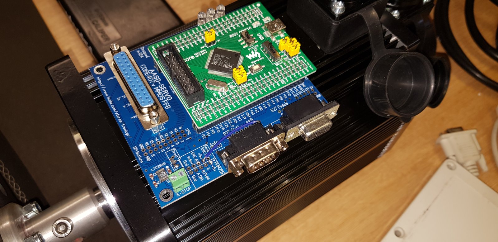

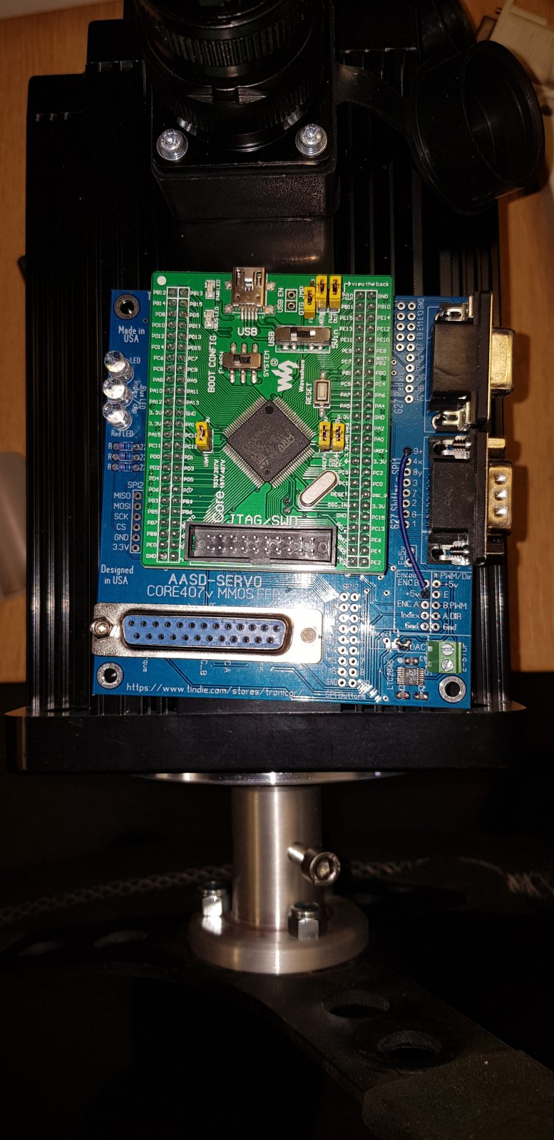

    Finally the board has arrived after getting stuck at the airport for nearly a month !
    Pic attached, you can see it is neat and smaller than the disco board.
    I will map the pinout to fit the mige servo driver and take it from there
    Cant wait to get it working

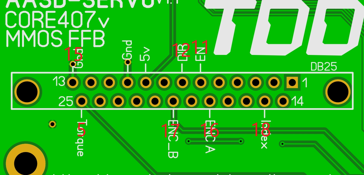

    @Thanos
    can you confirm that these pins are the same as the D25 connector that is the output on your board
    are all pins used ?
    1 GND
    2 PV pulse input
    3 PP+ port
    4 PD+
    5 PD-
    6 sig in 1
    7 sig in 2
    8 sig in 4
    9 DC 12-24v
    10 COM / GND
    11 sig out 1
    12 sig out 3
    13 AGND Analogue Gnd
    14 PP-
    15 PZ+
    16 PZ-
    17 PB-
    18 PB+ encoder output
    19 PA- encoder output
    20 PA+ encoder output
    21 sig in 3
    22 OZ
    23 sig out 2
    24 sig out 4
    25 Vref +/-10V'
  3. Thanos
    Jul 6, 2017
    1,380
    Electronics Engineer
    United States
    2,925Coins
    +1,080 / 10 / -0
    No, you only need these:

    NOTE EN should be pin 12 and DIR should connect to pin 11 on CN1 servo drive

    connect as pic and will see if you can at least enable servo first.
    need to know whether you need can use 5v to enable inputs
    might be easier if you do away with the TDD board and connect directly to the STM32 board

    connect EN to 12 on CN1(servo enable DI1)
    and DIR to 11 on CN1(CINV DI3)
    DI2 can stay to as Alarm reset if you want to connect button
