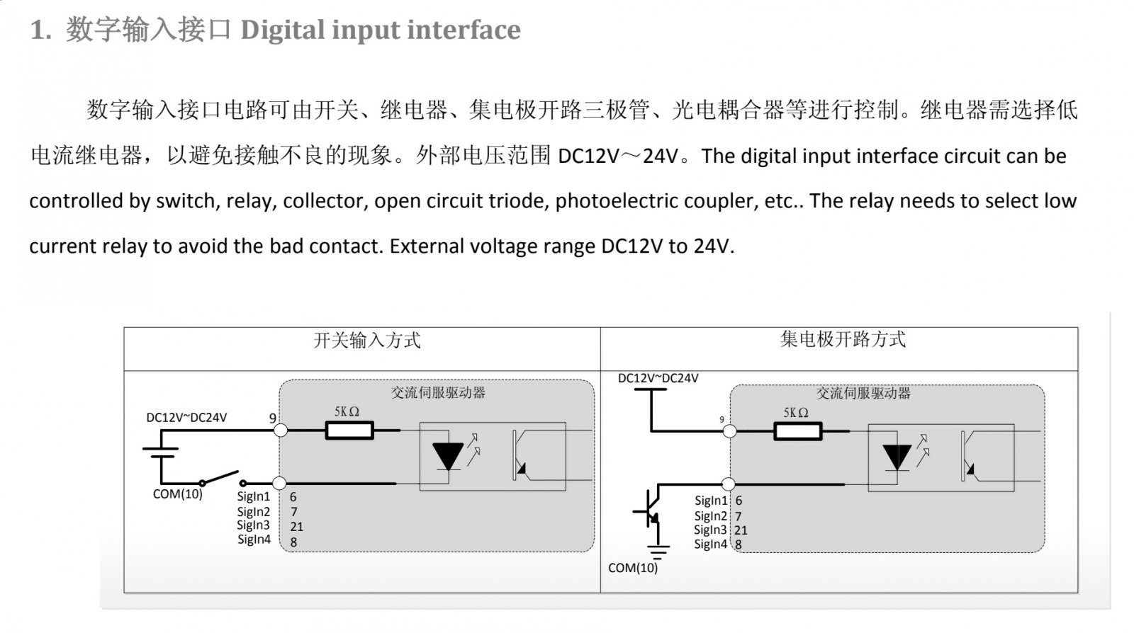

    3DOF, DC motor
    @Gadget999
    NO!!!!
    don't connect 12v directly
    you will need to use optoisolators

    you are trying to put 12v through the stm32' ports hopefully you haven't blown them.
    You need optocouplers so that you can drive the DI's
    3v signals from stm32 - opto input and 12v opto output to servo DI's
    Thats why I was suprised that that AASD drive accepeted 3v for its inputs...

    The AASD has bypass pins for 5v logic input... they have additional pins with resistors for 12-24v power input.

    The DIs just connect to optocouplers with a series resistor to limit the current to the IR LED, I can't remember what value they are but it would be sized for 24vdc@~20mA.
    You may be able to drive the IR LED with 3v3 or 5v,.
    The LED will still consume ~1.2v - 2.2v but due to the series resistor it will only pass less than 1mA of current, however it may be bright enough to activate the transistor on the optocoupler.
    The DI's inputs are sinking circuits so they are active low.
    I would suggest to test this out by doing the following:-
    If you have a female DB25 connector it would be easier, if not just use the TDD and remove the STM32f4 board.
    Try 3.3V power first and connect +ve to PIN 10 on the servo drive CN1.
    Apply 240VAC power to the servo drive, it should display SOFF or something like that meaning the servo drive is off.
    Now ground pin 12 of servo drive CN1, if it successfully works it will display now SOn, RdY or something like that.
    If it doesn't make a difference try 5VDC on PIN 10 and see if you get a result.
    If 5vDC doesn't work you will have to probably use a transistor or optocoupler to switch 12V
    If you are successful with 3.3v or 5v you can test the drive still without the STM32 by using a 1.5 battery to input to PIN 5 & 15 of the servo drive, it should activate the motor, then you can ground Pin 11(dir) and the motor should change direction.
    After you do these test successfully you can connect to the TDD board and insert the STM32 board.

    Pe11 seems to be used as a mere switch.
    hi=3v3=off, low=0v=sink=gnd=on

    The way I see it now is the DI inputs are buffered with optocouplers, the servo manual states that they require 12-24vdc to its pin 10 COM + (DI Power Supply).
    Looking at the connection diagram there is a 4k7 resistor in series to the opto, I take that as being the current limiting resistor which is sized for an voltage input of 12-24v.
    I don't know what opto is being used in the servo drive but I am hoping that 3v3 or 5vdc is enough to atleast drive the IR LED in the opto on enough to switch, hence the tests.
    After all an IR LED requires the least amount of forward voltage and current to light up compared to red...blue leds, also the IR led and light sensor in the opto is in a sealed package so ambient doesn't interfere.
    I don't know about what the manual says but to me, being that the anode being connected to +com you would require gnd or lower voltage than com+ to be supplied to the DI input for the LED to turn on, hence "active low".
    If you mean that it is ok to use 12v to com+, I pretty sure the stm32 can't handle 12v on it's ports.
    Even if it can, I don't see how the opto's led would be turned off being that gnd would forward voltage of 12v and @ 3v3 would still see a forward voltage of 8v7.
    Thats why I said if <=5v didn't work gadget would need to use a transistor or another opto.

    It's rather simple. To enable the servo you need at least 5v, which I supply by the stm32f4:
    Or if are brave enough you can open the servo drive and change the 5k resistor to 2.2k resistor so it will work with 3.3v power.
    But you can use 3.3v on the outputs just fine as there is no limiting resistor (stm32 pull up).
