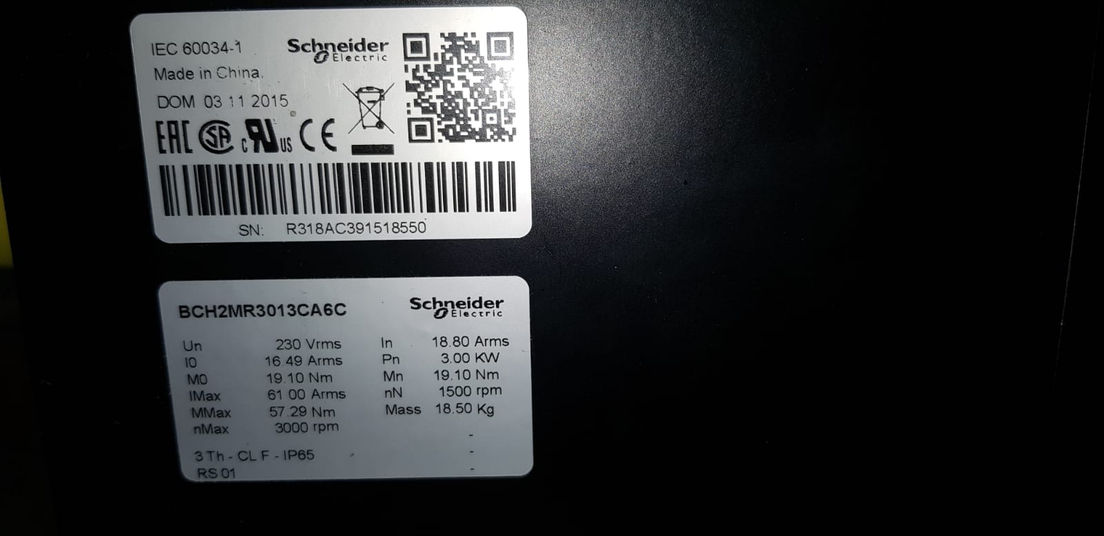

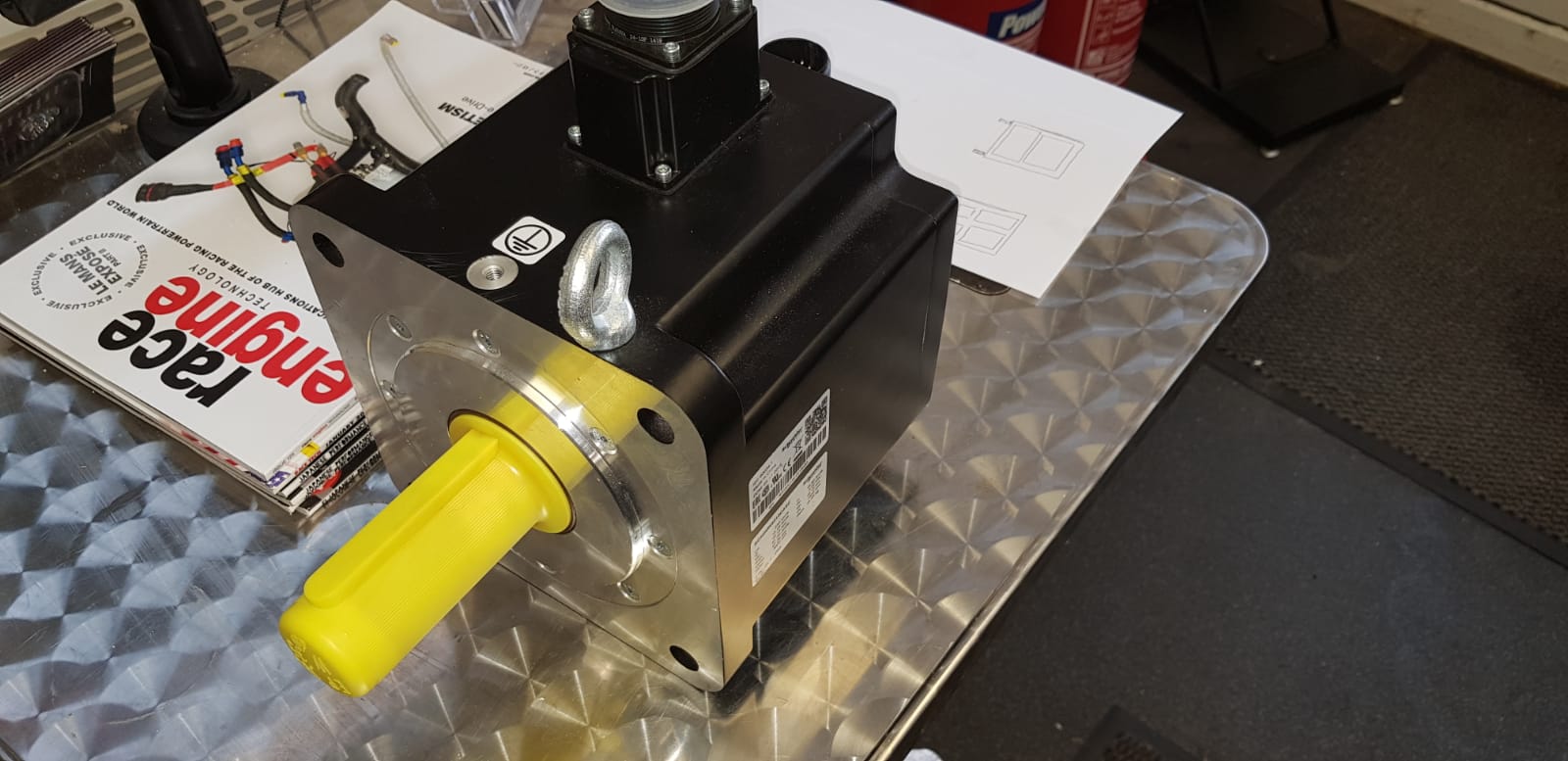

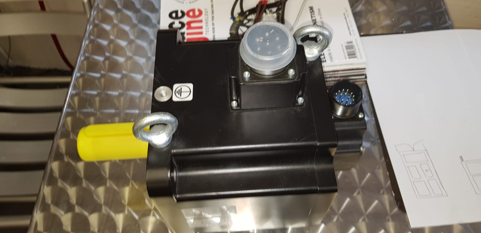

    quick update - I have had the wheel working using a H Bridge to flip the voltage from + to -
    the support from MIGE has been very poor and I have purchased a AASD-30 so i can use this wheel the same as the rest of the community. Waiting for it to arrive
    on a more positve note i have enjoyed playing and learning about servo motors
    this 'little' toy has arrived today
    its a 180 3kw servo with a 20 bit resolution (i think that is over 1million steps per revolution !!!!)
    I bought it as a bit of a bargain and have not decided what to do with it - i may fit it as a external motor for a wheel or use it as a sim actuator
    3KW and 57 NM - its got some balls !!

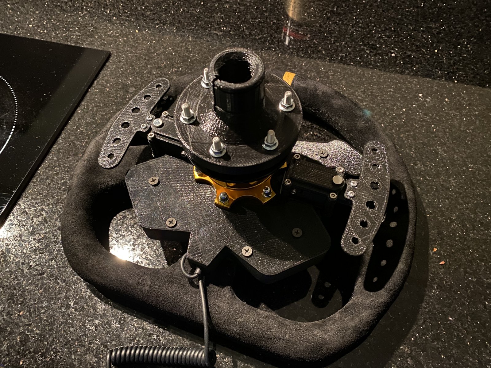

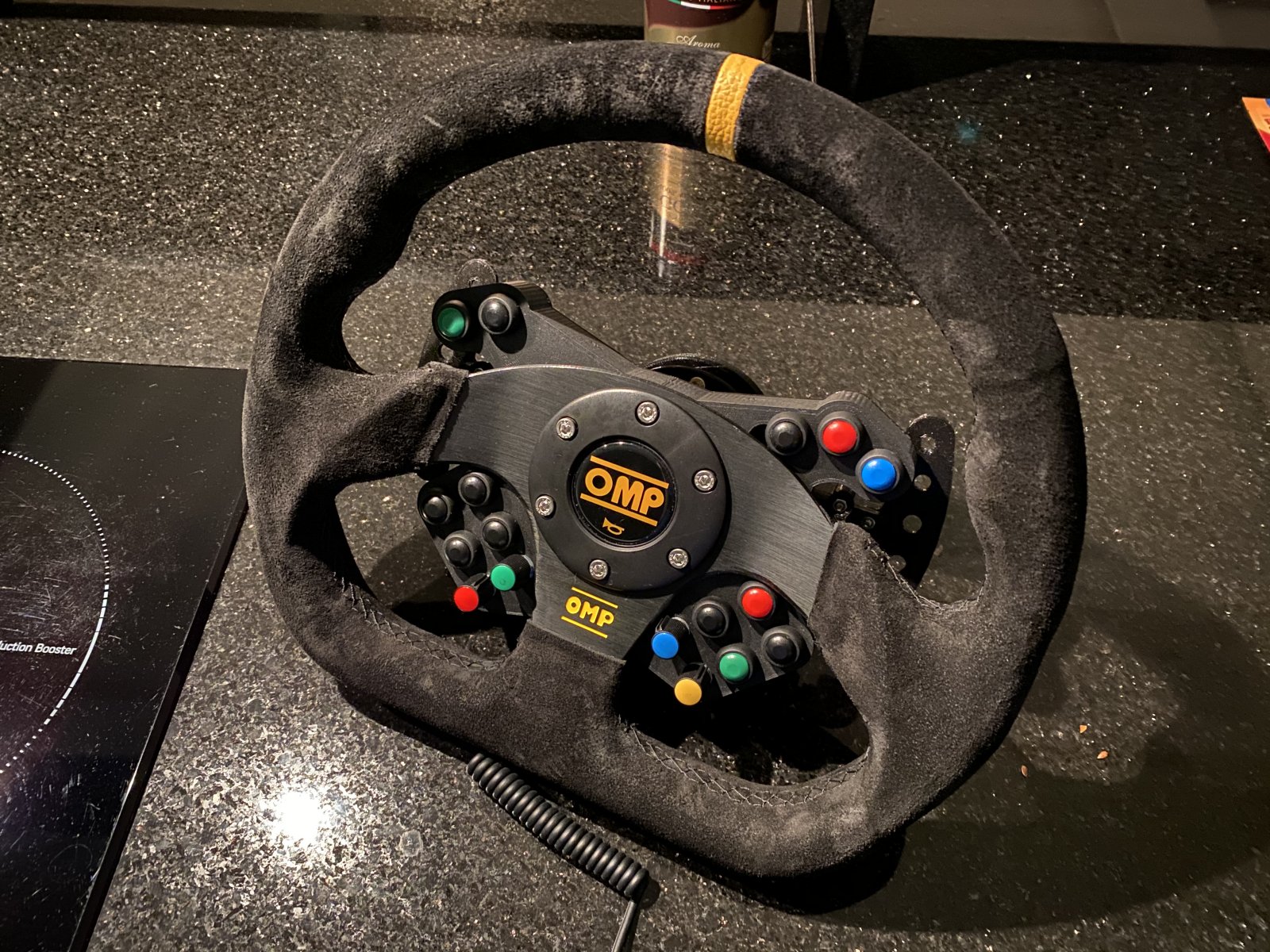

    Quick question - I'm about to order 130st but i have doubts if the 30nm version is really needed or can i take 25nm one. Fanatec dd1 vs dd2 is 20vs25nm... The bigger one is 4kg heavier.
    I've already prepared the wheel:
    8CFE9131-0516-4571-B734-3626D03FCA47.jpeg E40E5D77-D08E-4B0E-B7E6-042DF41D6260.jpeg
