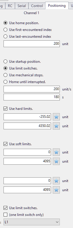

    @JAD
    Axis 6 & 1 are good. Would need to use longer power cables any other way. they also have a different gear ratio. 4095 units = 57000 lines for 6 & 1. 4095 units = 38000 for 5,4,3,2. in DEScribe.
    Slight variation from your Diagram,

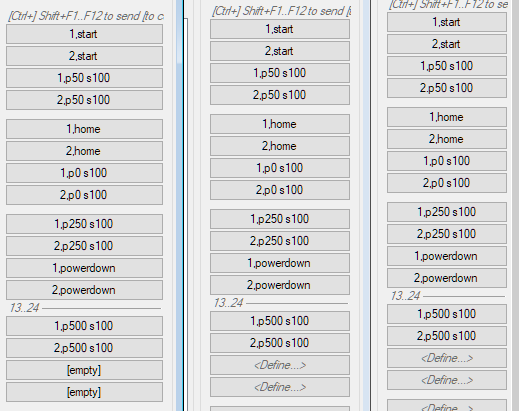

    YAT works fine to this. No unit conversion!? Why would it be going to full travel with an input of only p500? I'm not seeing where Yat works with 500mm I thought DEScribe would have set it to travel 4095~ Would there be a unit setting kept from other lines being sent earlier?
    I'll go on with the list when I get this sorted.
    I would have never gotten through this. Thanks so much for the help!

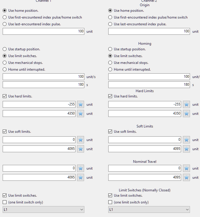

    The machine zero of 100 looks too low for the hard limit of -255.
    If you home to the bottom limit switch, and if the machine then advances 100 to the machine zero, then a -255 from machine zero would be beyond the lower limit switch.
    This needs attention but wouldnt be the cause of current issues your getting now.
    Im not sure what you mean in the above.
    Im a bit puzzled as you mentioned in post 49 and and 59 that YAT was working fine for 500-580mm of travel.
    Are you sure you were achieving this by sending a p0 and P4095 command with YAT?
    We just need to get back to this point.
    I dont see P4095s100 in your shortcut list so I guess you were typing this manually?
    You showed me its entered in DEScribe so it doesnt need to be sent again manually using YAT
    When you entered the units values with DEScibe, are you sure the correct COM port was selected so that the 2 different setups got the correct values written to it?
    Sometimes windows mixes up com ports if the usb serial adaptors are generic clones.
    Can you also check that whatever values your entering in DEScribe is written to the device permanently and appears again when you download from device to be sure the values are locked in on power up. Especially check the units stays locked in.

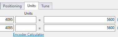

    I can only think the units ratio is incorrect, but again still puzzled why it was working in post 49 and 59.
    Can you check again the number of machine lines between limit switches using DEScribe. I mention a method to check this manually in my video.
    For 5,4,3,2, I am expecting a number a larger than 38000.
    If P500 gives you full travel, then its wrong and we need to fix this before trying out Mover. We need P4095 to be full travel (between soft limits).
    Im not sure what you mean.
    If its set with DEScribe, we never have to enter units again.

    That took some doing. Chair is lifting to 4000 equally with all actuators. I think YAT was holding the unit setting somehow. now its 1 to 1
    How do you know the # of the posts? I don't see the #s.
    I'll start working on the previous post again. : )

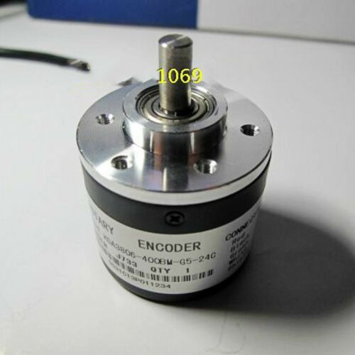

    Using a can type encoder 100 ppr on the motor shaft of wheelchair motors.
    Not sure if it's gradual or just when I hit a wall. Sorry, just put everything back together in the last couple of days.
    not sure if one or more are losing position. Been working on the motor shake issue.

    That encoder drift can be a tricky one to solve.
    Im speculating that it will be due to signal noise.
    Some things to try is to keep all the encoder wires away from any high current motor wires.
    And earth everything you can get at. I mean all the metal parts of the rig all connected back to earth, motor bodies, anything that can conduct. And use screened wires where possible.
    Screening and earthing to improve signal noise is bit of a mystery to me. Since most of us do not have the tools to measure noise it seems like a black art to me. So thats why I just go overboard with the earthing and screening to minimize noise being a problem.
    Signal noise is something I struggled with myself early on. I suspect its still happening now on one actuator but its a slow drift and re-homing every now and then resets the drift problem. For me, it only started to slow drift when Im doing short and sharp movements. ie a very rough off road surface in Dirt Rally.

    I have 2 chokes on each of my encoders. That really helped the drifting of a previous rig.
    Do the encoders you use have index? Mine don't. I'm hoping that switching to encoders with index will solve the drifting issue.
    As far as Hall Sensors go, I'd like to stay with encoders as I know nothing about the setup of Hall Sensors.
