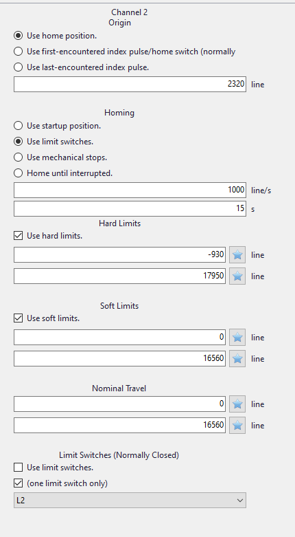

    I have DEScribe working in the proper direction and to the correct limit switches. It's when I run Yat it starts in the opposite direction to the other limit switch. I had DEScribe, Yat and FlyPT all going in the same direction to the same limit switch when I left it a few months a ago, and I haven't changed anything in Yat. I need Yat to work in the same direction as DEScribe, so I can start FlyPT.

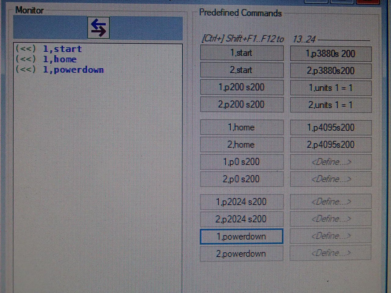

    Can you post a picture of the commands you are sending with YAT
  6. PaulB
    PaulB Titanium2dof
    Apr 15, 2017
    121
    Canada
    723Coins
    +57 / 1 / -0
    This is what I use to test and center the actuators for running FlyPT. Worked perfectly till a couple of days ago.

    OK, theres mothing there that affects the homing direction.
    I can only think of testing the wiring by changing polarity. Have you tried that yet?

    I also want to clarify your understanding of YAT. The developer of YAT will have no clue about what is on the receiving end such as kangaroo. We are using YAT to send typed commands to the kangaroo that the kangaroo is built to expect. YAT is just dumbly sending out bits and bytes in a format that only the Kangaroo is going to understand. If the kangaroo does somthing unexpected, it is only due to what we typed into the text lines that YAT is sending.
    From the picture you sent, there is only 3 commands sent to the kangaroo, and none of these will affect homing directions. So the issue with direction can only be settings made with DEScribe and/or wiring changes to the motor or limit switchs or the AB encoder wires.
    When in DEScribe, you can use the pretune tab and check the directions of the motor, and see the L1 and L2 switches activating, and see the encoder count incrementing in the proper direction. If this is the same for all 6, then it should all behave in the same directions when homing and sending position commands.

    When I send the command to home, it feels like it goes full tilt for a second and it shutdown then I get E3 [Control error, channel disabled. Check to make sure your feedback sources are working and the system matches how it was set up during the tune]
    is the error code on the Kangaroo, 3 flashes.
    I send the powerdown command just to stop power with YAT.
    I'm sending Start, Home and Powerdown seperatly.
