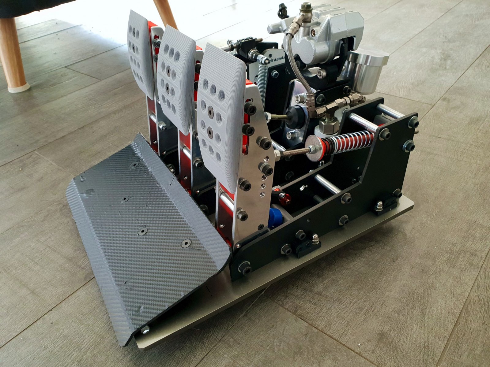

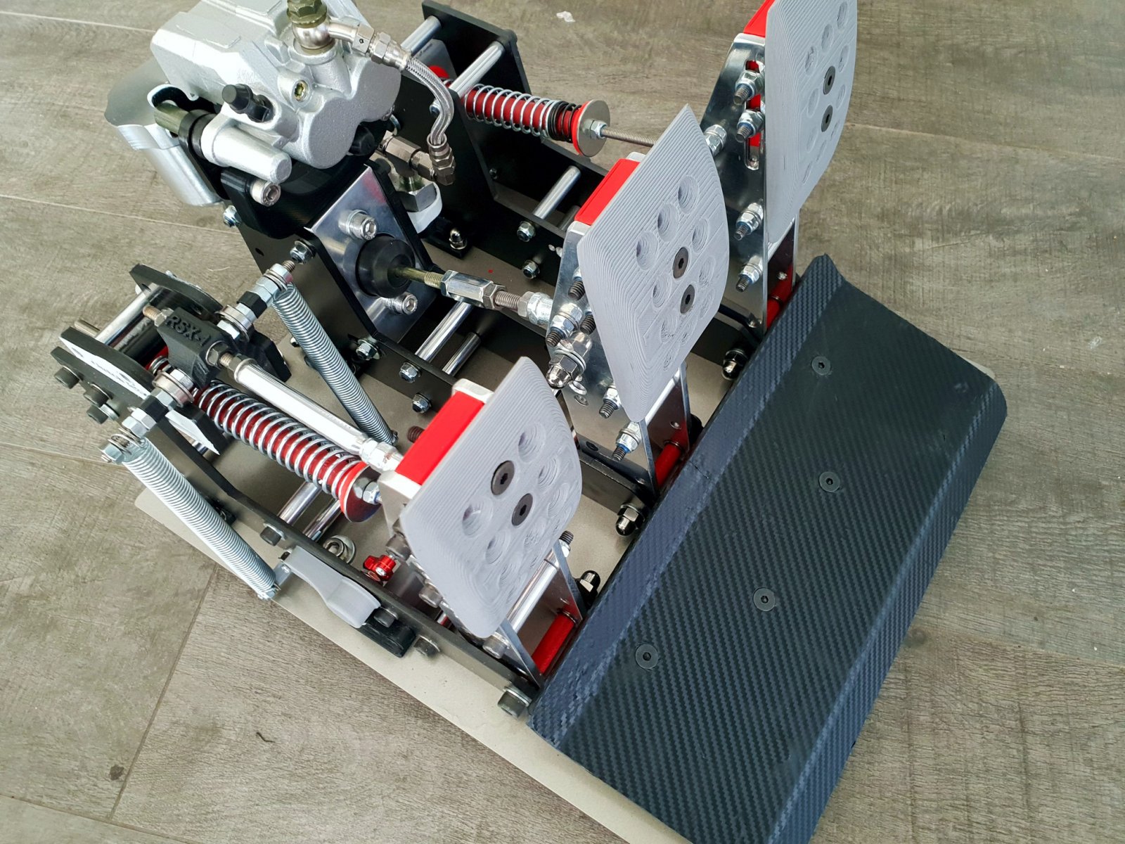

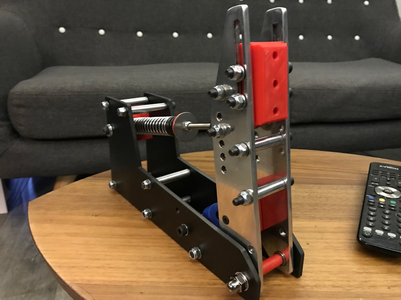

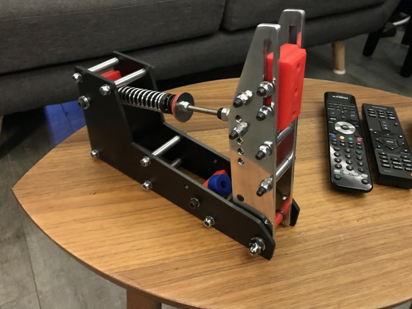

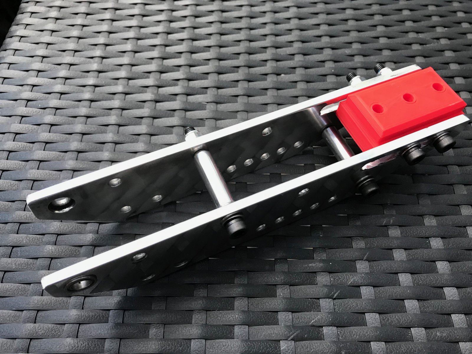

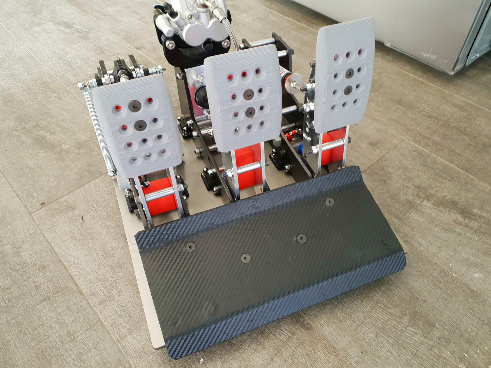

    Heel Toe plate and Base plate installed (please excuse the shitty excuse of a wrap for the heel toe plate as apparently one may or may not have the natural skills required to apply anything down with a glue backing.... :oops:)
    Rest Assured that the final finish on the HT Plate will be chromium or anodised or maybe even the new black chrome type powder-coat... Has anyone got any experience with the new powder-coats that are available?

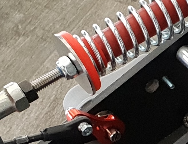

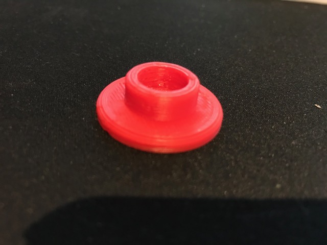

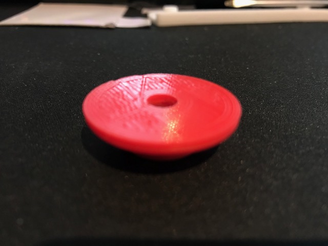

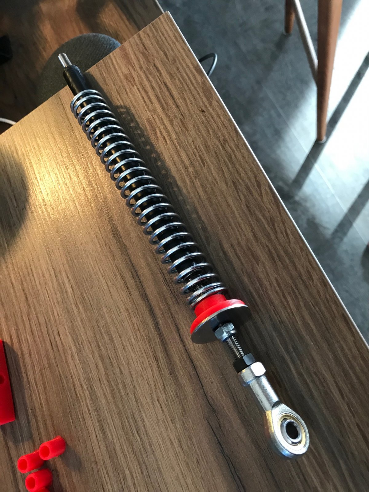

    what are the red plastics you used in your pedals (inside the springs)? i have seen them in some other builds but i have never understood what they are. :(

    @ferslash
    They are spring retainers that I designed and 3D printed myself. When I get back I'll post some pics for you

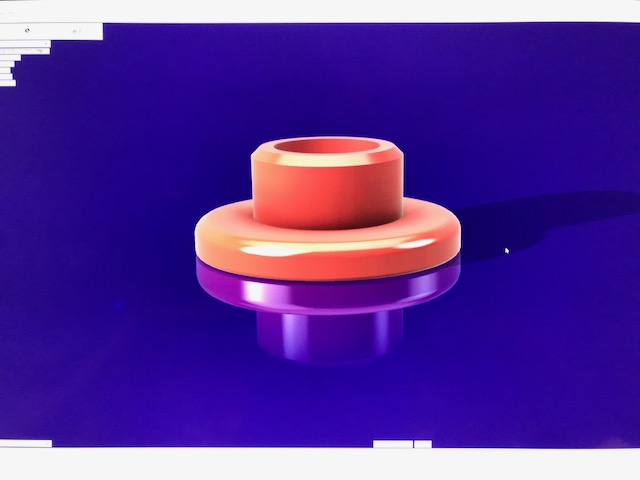

    @ferslash
    As promised sir
    Here they are
    This was the design in Fusion....
    Refer to this photo from a previous post... See how it's used? They stop the spring from moving sideways and allows it to stay in its intended spot

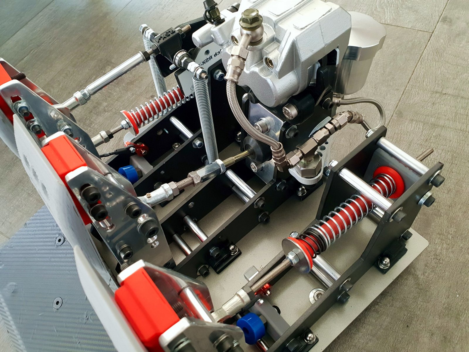

    What type and parameters of resistance You have in caliper? Is it just piece of cast iron or some kind of plastic?

    overtime! I built my dynamic station using the 3D printer for different pieces .. I wanted to ask what pressure sensor you used for the brake caliper. I'm about to change the load cell brake (200kg) in the hydraulic.
