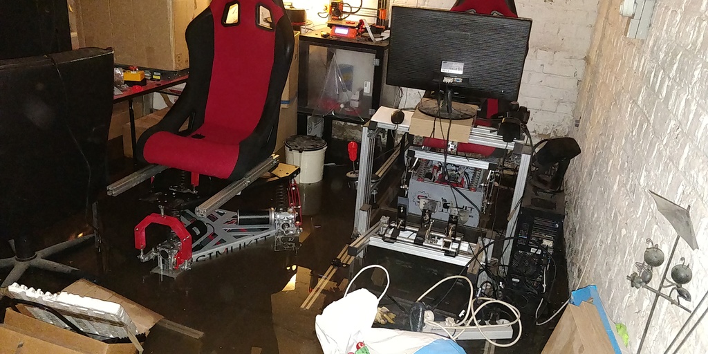

    I get some water in my cellar... So I could not do anything :(

    What a disaster, it is painful to look at let alone to cope with the damage :(
    Is the water from rain or a busted pipe?

    The city sewers that went up. I let you imagine the dirt and smell

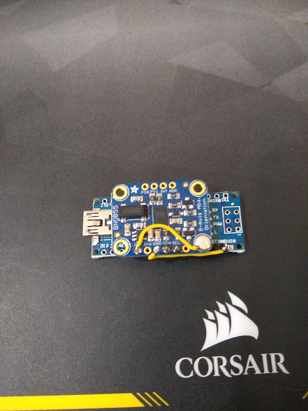

    OK. I loaded up a nano and piggybacked the sensor on to it.
    It is displaying X Y Z on the monitor. The axis all display properly..

    Perfect! I'm just about there, stay tuned!
