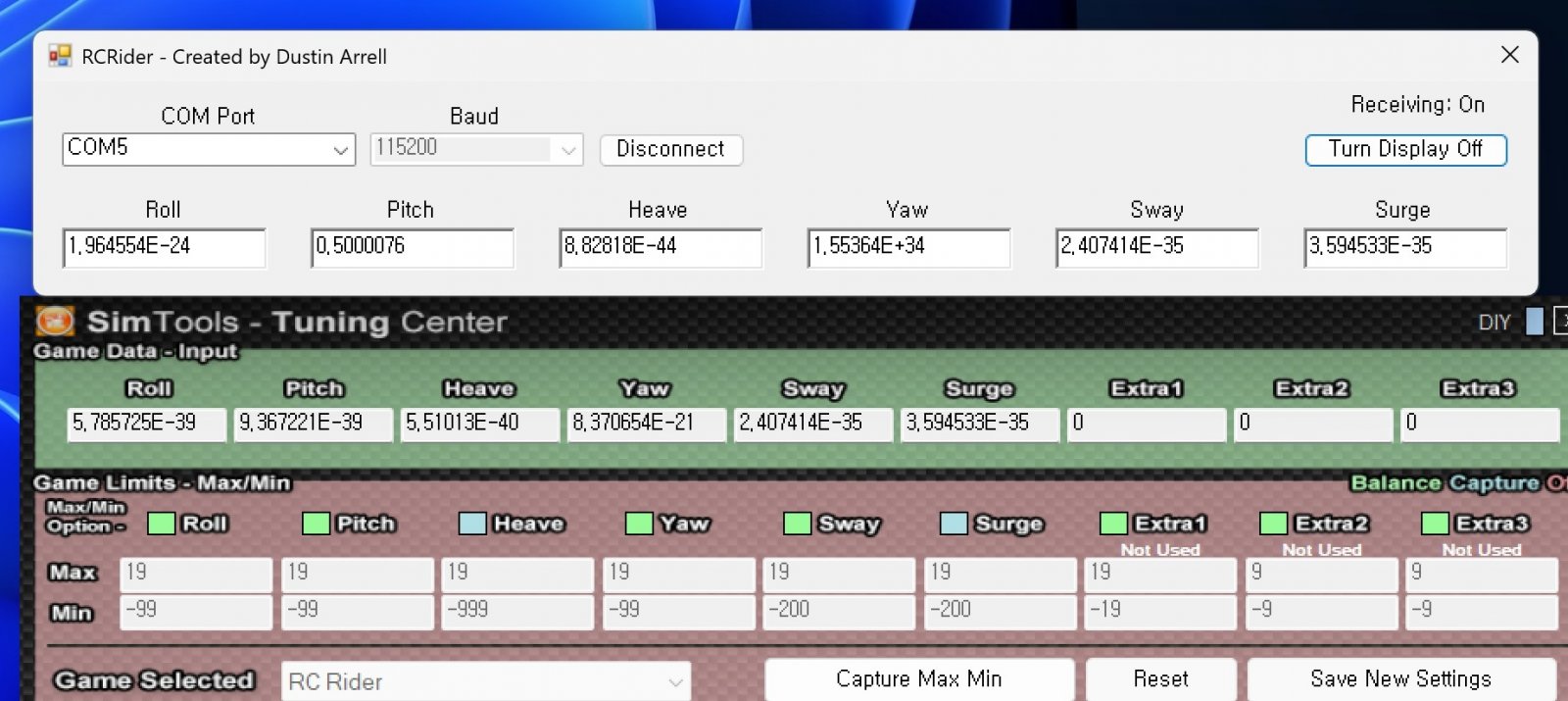

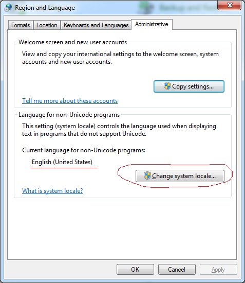

    Got a bit problem, when I moved the imu and looking at RCRider.exe. I got good values, but in Simtools v2.6.1 in Tuning windows I'm getting values but without commas or dots. example, in RCRider a value is 15.750 but in Simtools getting 15750 (without a dot). I saw video in this thread, in the Tuning windows has both of them. Matches between RCRider and Simtools.
    Also, values are jumping around by itself even I didn't touch the BNO055 imu. Tried delay(250) got better result but after few second values are all over the place again.
    Can anybody know what is going on?
  10. yobuddy
    51,351Coins
    +5,200 / 19 / -0
    Hi deeph,
    This sounds like a region problem to me.
    Do you use a coma or a period for the decimal point normally?
    If it's a coma, this should fix it I think.

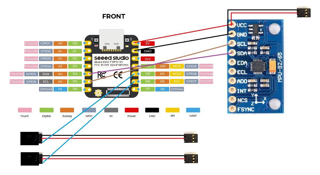

    For a v3 version of RC Rider thou, I'm thinking of using an esp32 (with wifi built in) for a faster back-end.
    I'm hoping with a faster chip (240mhz vs 8mhz) and a faster backbone with wifi, we can get a good 100htz signal without much delay.
    I was also thinking of trying to use a dual core chip, and have one core sending the telemetry in a loop, and the other core allowing me to control the rc car from a pc cockpit (wheel and peddles). But I have not had any time to whip up some code for a test, so I'm not sure it will work yet. (But I have collected all the hardware shown in the pic below)

    Yup it was the region thing, comma showed up in Tuning Center, Thanks Yobuddy...

    Hello, I'm trying to work on this project,
    and it's been three weeks and I need help.
    The RC RIDER app is receiving data fine, but the game data coming into the SimTool Tuning Center is delayed too much. It's the same whether I plug it into USB 3.0 or 2.0. I'm not sure what the problem is.
