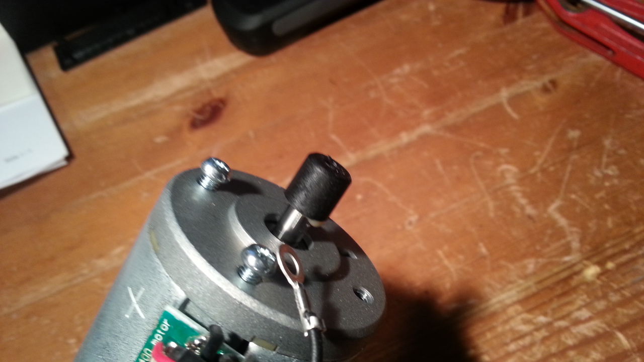

    IMO I am not able to dismantle the magnet and the belt pulley

    is the pulley made of metal?
    (just a thought .... some years ago i managed to remove a press fit pulley from a turntable motor after putting the motor in the freezer for some hours).

    If somebody knows where to buy any timing pulleys please HELP :)
    EDIT: no more pulleys needed (see below)
  5. Pit
    3,007
    30,501Coins
    +3,098 / 31 / -0
    Yes, it seems to be metal...great idea to try out the freezer...thank you :)

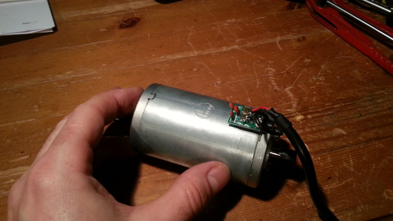

    tataa
    The magnet cylinder is a little bit broken but not really damaged.

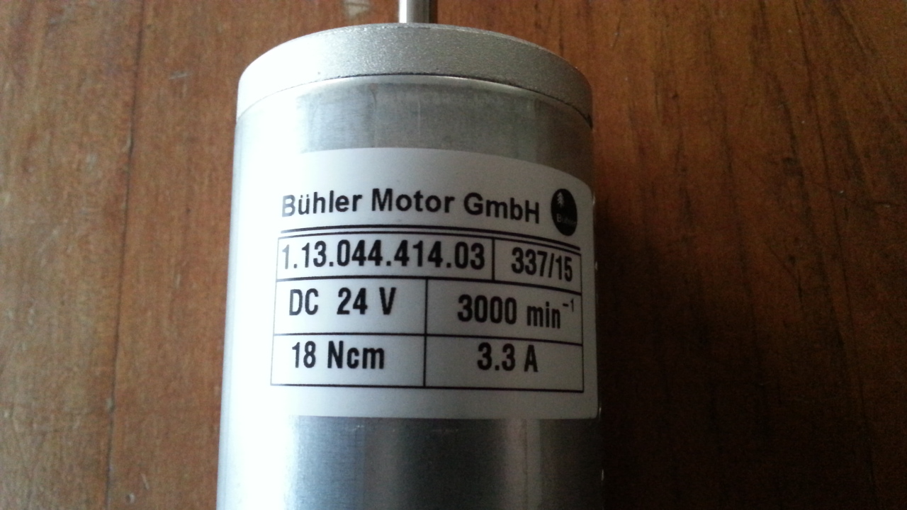

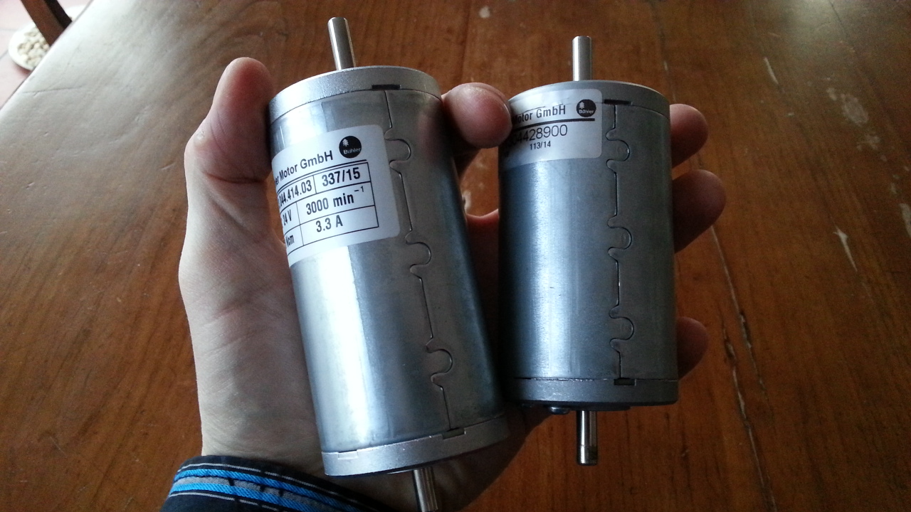

    The upcoming weekend is tinker and solder time! The replacement motor is being to be delivered this morning, the wheel is dismantled and is waiting for the big baby :)
  13. Pit
    3,007
    30,501Coins
    +3,098 / 31 / -0
    BTW I didn't find many information about the mosfets sticked on the board obviously they should handle up to 110A...theoretically.

    one quick question.
    supposed you cant change the current flow and stay oem.
    if the bigger motor has bigger armature (coil), is that enough to produce more torque with the same (stock) amps?
  17. Pit
    3,007
    30,501Coins
    +3,098 / 31 / -0
    we will see...

    Tomorrow (or better said today) is my day of burning things ;)
    BTW what I expect from the stronger motor: less clipping.
