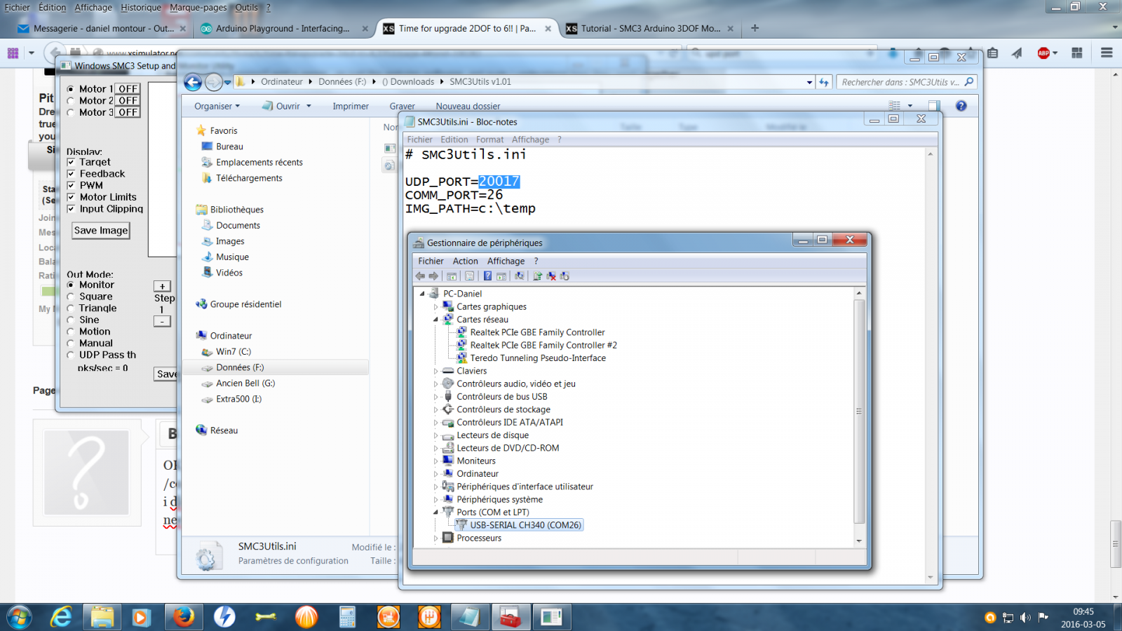

    OK, tks @Pit . I didnt knew what SMC3 was standing for, but finally found the thread here: http://www.xsimulator.net/community...3dof-motor-driver-and-windows-utilities.4957/
    i dloaded the SMC3 util v1.01 and the SMC3.ino as required, followed what to do but i am stuck on the UPD value i need to change to have the communication going on, here is a screenshot of what i have...
    So where can i find the UPD code ?
    I also would like to understand if the SMC3 replace the program i would need to put in arduino? edit: after reading a bit more, it looks a bit like the software for the Pololu...a bit lost there (scratch my head) :)

    The UPD value has not to be changed in any case. Only the COM Port has to be set (shown in the device manager of the Arduino)
    You upload the Arduino sketch to the Ard only and then start the SMC3 utility.
    Using the SMC3 utility you can adjust all parameters of the sketch on the fly in real time.

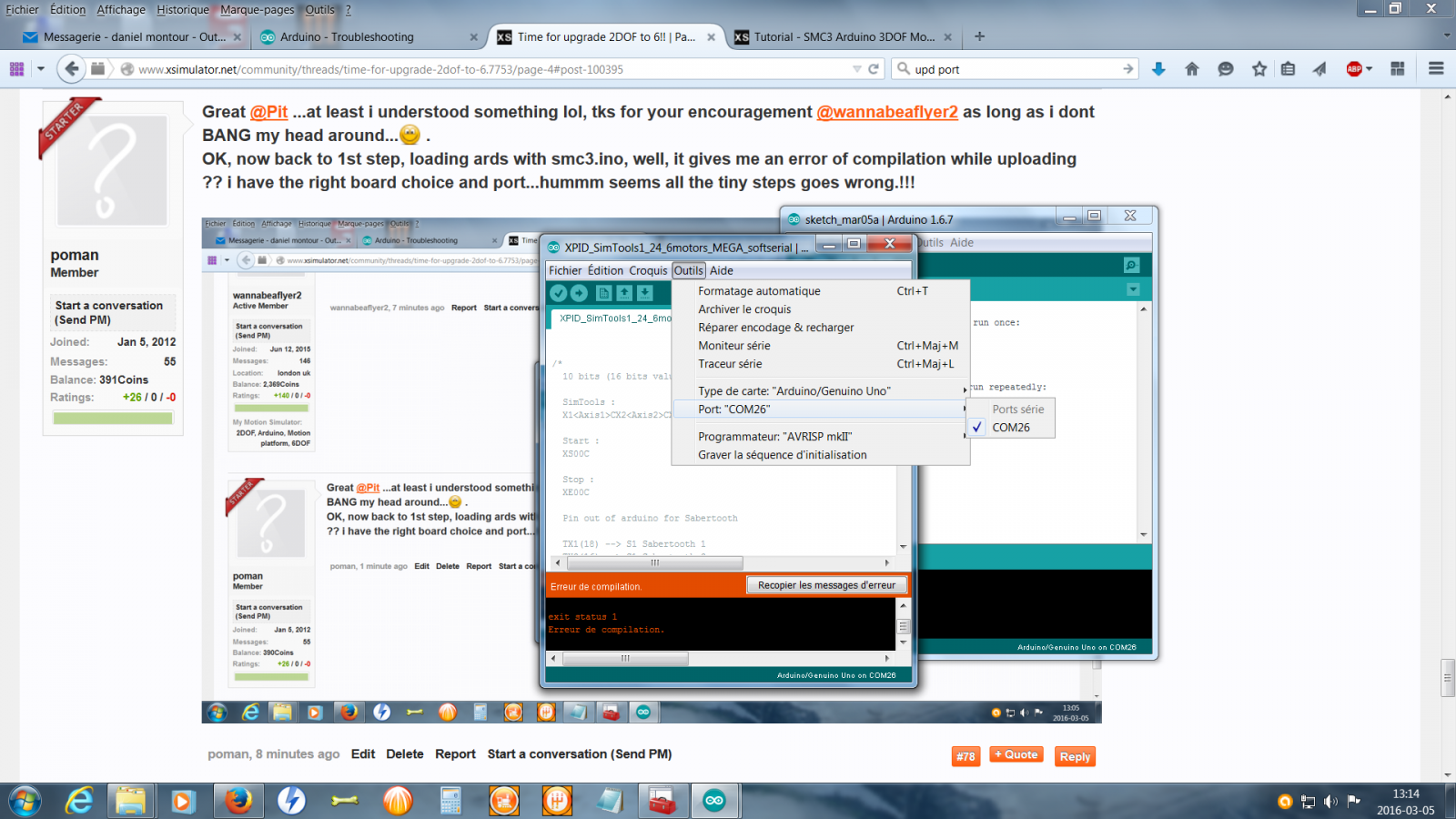

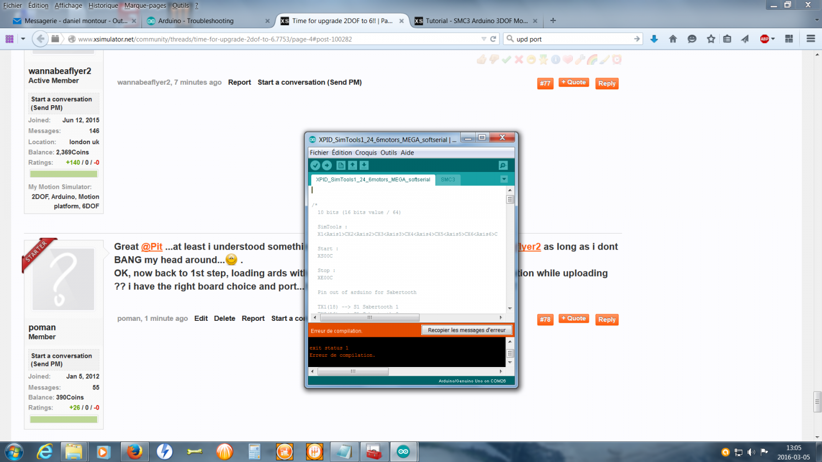

    OK, now back to 1st step, loading ards with smc3.ino, well, it gives me an error of compilation while uploading ?? i have the right board choice and port...hummm seems all the tiny steps goes wrong.!!!
  19. Pit
    3,007
    30,510Coins
    +3,098 / 31 / -0
    Are you familiar with the Arduino software? you know that you hat to set the Arduino type and the COM port first? And which Arduino software you are using?

    yes, as on the screen...
    and i did tried the sample as per the tuto on arduino site, the blinking led, i could see the TX and RX light, but i didnt had an orange led blinking like supposed?? the L light is green and was green to start with
    edited: well for some reason, the 0.63 version worked, i had taken the 0.7 version before...edited again, found out how to make it work the file had to be in a SMC3 folder, but now i am supposed to make the choice with mode 1 or 2, i believe it will be mode 1 @Pit , but how do i edit the program?? tks
