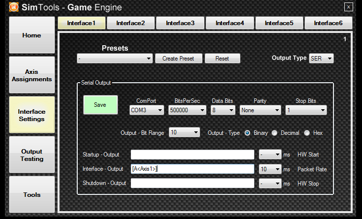

    have you tried [A<Axis1>] ... [A<Axis6>] one per interface as described in previous posts.you have to type the brackets too in interface output too
    EDIT:
    Set 500000 baud rate and 10bit binary output
    • Winner Winner x 3

    Interface output is wrong, please check again the SMC3 thread.

    I believe insanegr has nailed down your issues. Even though I looked at it, I completely overlooked the necessity of using brackets too. :oops: And when the baud rate is set incorrectly you will either get no motion or erratic motion.

    Well, ill be dammed...IT WORKS!!!!!!!!!!!!!!!!!!!
    i am VERY sorry as i didnt thought of going back to the SMC3 page where it clearly says baud rate at 500000 and 10 bits output. The place i did thought of checking is in the SMC3.ino i could see 115200 in there so i thought i was ok
    And also, yes i forgot to mention in my video that i did tried the brackets, but since i didnt had the proper baud rate it didnt worked...wew!!! i was hoping it was only a small thing.
    TKS SO MUCH FOR HELP!!

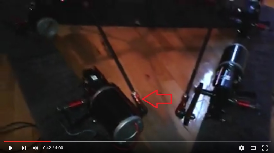

  7. poman
    poman Active Member
    Jan 5, 2012
    128
    154Coins
    +95 / 0 / -0
    Well, i am a bit dissapointed as you will see in my video, the structure is a lot more sloppy than what i expected, and i didnt showed it moving but i have an issue with the hysterisis i think(goes back and forth quickly), i know there is a couple of ways of fixing this issue with SMC3 and probably simtool, havent had time to play with that much, but as i am putting gas shock, i have been told it will help, plus the weight of everything including me. i have quite some adjustment to do i knew that, but i need to be sure the design is not to change/modify before i keep going. The changes i tought was like moving the upper ball joint on the other side of bracket, or maybe change my attachment point, or the starting position etc...tks
  8. bruce stephen
    Jun 7, 2015
    1,286
    general contractor
    michigan
    9,115Coins
    +1,243 / 9 / -0
    maybe spin the motors so they face out this will give more of an angle? have you tried turning the starting points 180 degrees this will also change the angle.
    22,185
    154,750Coins
    +11,196 / 57 / -2
    That is an awkward angle.
    Perhaps flipping the top ball joints 18o degrees and mount them om the inside of the bracket may help with the angle. If that is not viable then I suspect some significant design changes are needed.

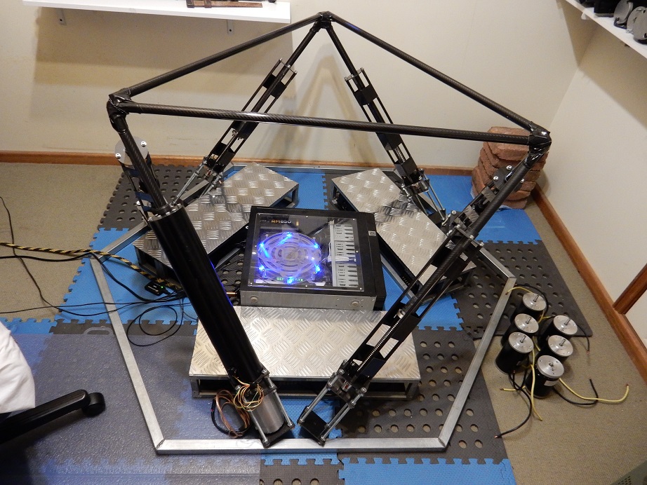

  10. SeatTime
    2,572
    Hard to tell from your video but you need to check how well you are forming the right angles so that each pair of arms will support each other. A property built Stewart Platform should be self supporting and not move at all unless it is driven (its based on intersecting triangles like a bridge support). Recommend therefore you have a look at how @SilentChill has built his sim which is similar to yours.

  13. SeatTime
    2,572
    The two triangle base and upper are not aligned in a stewart Platform. Below is a old mockup of mine when I was building it - As you see it is all triangles and once it was attached to the frame later - very stable and strong. Not exactly like yours or @SilentChill , but I hope you get the idea. You are very close - it just that the angles are not quite right.
  14. SilentChill
    2,645
    20,604Coins
    +3,570 / 34 / -0
    Flip your arms 180 degrees make much more of an angle on your connecting rods to the platform
  15. bruce stephen
    Jun 7, 2015
    1,286
    general contractor
    michigan
    9,115Coins
    +1,243 / 9 / -0
    Like I said to begin with spin the arms and motors 180degrees. Also as @noorbeast suggested put your platform push rod mount on the inside. If you insist on having the motors facing inside a larger base may be needed.
    Wow @SeatTime that is one of the best examples ive seen of the triangles formed in a stewart. Ty for posting it.

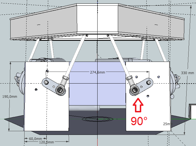

  18. noorbeast
    22,185
    154,750Coins
    +11,196 / 57 / -2
    I do like the overhead projector mount :thumbs
    The COG needs to be determined with the loaded weight, with all peripherals attached and with you sitting in the seat: http://www.xsimulator.net/community/faq/find-the-center-of-gravity-to-balance-a-motion-simulator.55/
    Just a design observation. Maximum effective torque is delivered at 90 degrees and falls off rapidly at an angle, and you have a significant lever to rod angle at rest. You can have a play with this online calculator to see what I mean: http://hyperphysics.phy-astr.gsu.edu/hbase/torq2.html
    • Agree Agree x 3

  20. noorbeast
    22,185
    154,750Coins
    +11,196 / 57 / -2
    Let me try and explain further about what I mean by the angle resulting in the ineffectual use of torque.
    If you look at the design for @zigzag49's 6DOF you will see the motor arm is roughly 90 degree to the rod and maximum torque is transmitted that way: http://www.xsimulator.net/community/threads/6dof-dc-24v-smolka-zigzag49.7490/
    At the moment on your sim it has a severe angle between the motor lever and rod, which will be very ineffectual in making use of the available motor torque.
