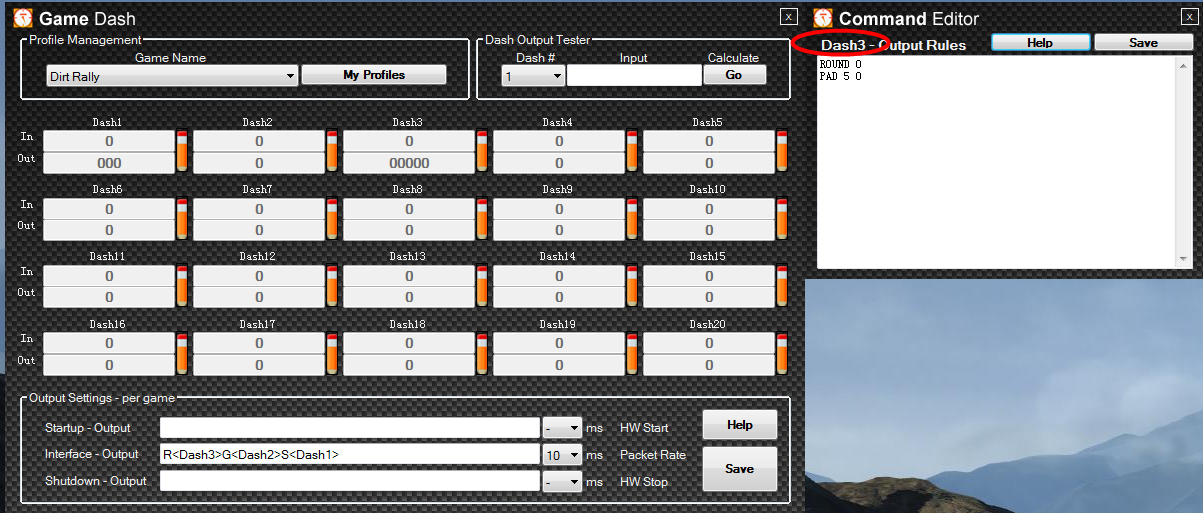

    Hi,thanks for the project !it works good,but here some little problem when I use it in the DIRT RALLY,it often shutdown when i restart a racing, any body have the same problem?
    and i have to restart the game and the arduino ,then it will work again .
    and when I closed the game ,the 1638 is still stucked in the last display ,and i must reset the arduino to make it work.

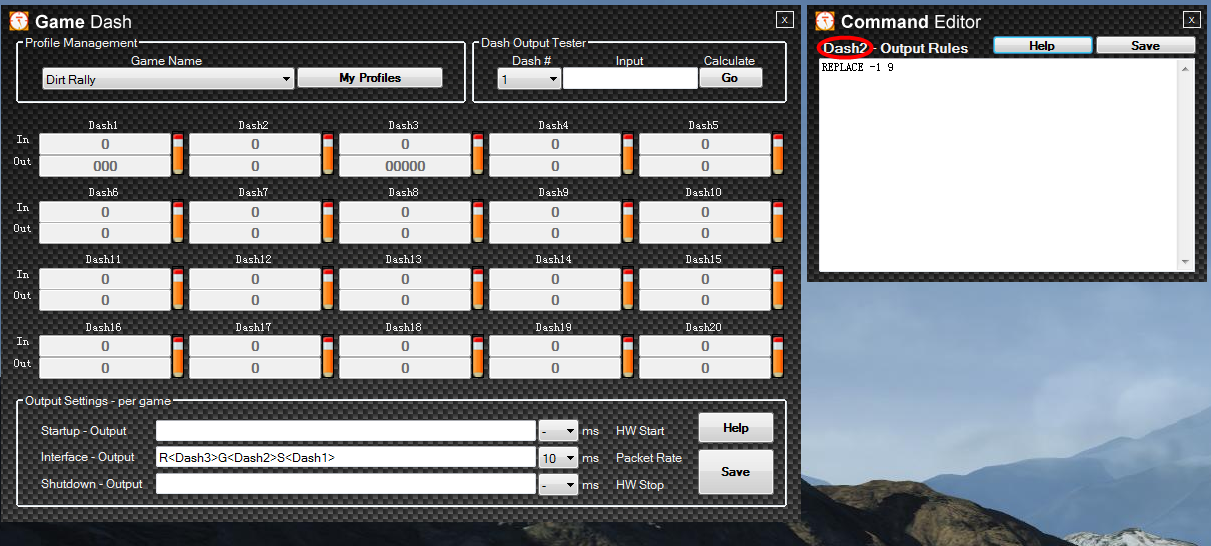

    @bsft ,have you change the rules of the game dash in Dirt Rally? if you dont change ,the 1638 will not work ,because the Dash2 is Gear ,and Dash3 is RPM,and the rules is below,you may try my rules , maybe it can help you.

    and i have tried some other conditions ,
    1:change the rules form Dash1 to Dash3,like what i pictured up;
    2:change the interface-Output: R<Dash3>G<Dash2>S<Dash1>(because the Dash2 and Dash3 is different from the other games.)
    3:change the Packet Rate to :20ms(When i use 10ms,it does not work )
    4:if you did 3 steps above is still not work, you can change the language in the "location and language" in your OS, and i changed the 'format' and the 'Unicode' to english(USA), and then restart the PC ,and it works.
    maybe it can help you to fix it.
    and about the crash, i found if i shutdown the game window in racing ,it will crash ,but if i press 'esc' to stop the racing ,and then shutdown the game window ,and to start the game again ,it will
    works again and no need to reset the ard.

    I have tried 3 different GameDash Arduino codes:
    1. from @eaorobbie in first post
    2. from @soraz - http://www.xsimulator.net/community/marketplace/arduino-and-tm1638-for-simple-dashboard.79/
    3. from @vthinsel - CarDashX http://www.xsimulator.net/community/threads/cardashx-tm1638-sketch-for-gamedash.7276/
    Dirt Rally doesn't work on neither of those.
    - Tried @welen123 suggestion to change Dash output settings
    - Tried changing my region and locale to US
    - Language changed to US although I think this has no effect anyway
    Eventually I've found another code on the internet from this guy: https://github.com/Billiam/pygauge
    Which require to upload Arduino code and run a small .exe file before the game.
    So now when I want to play Dirt, I need to upload that code and when playing other games like rfactor2, pCars, AC etc, I need to reupload CarDashX for example.
    I think it could be a plugin problem?

    I use @@eaorobbie 's code ,do you change the Packet Rate to 20ms, and the output rules must be cooperate with the code , like RXXXXXGXSXXX, if your rules are wrong ,it will wont works .
    when you change the setting , try to path the plugin with game again,and reset the arduino ,and then open the manager/engine/dash ,set the right port and bounds ,and then strart the game , look at your 1638 ,if it display "NUKEM"for about 3 seconds ,quit the game ,and reset the arduino ,wait for a few seconds ,and start the game again,if display "n" in your 1638 ,yes ,it works .
    if 1638 crashed ,try what i posted above.
