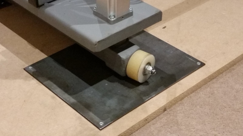

    I was also worried about wheels creating flat spots. i had mine machined from hard nylon as this does not flatten and is extremely smooth. I had 6 made for £60 total including bearings
  2. crammy
    Feb 23, 2016
    563
    Fabrication
    essex
    4,633Coins
    +326 / 2 / -0
    SCN6, 4DOF
    There is a fair bit if weight on them and they have not flattened, even sat for in exactly the same position for weeks at a time.
    Edit. They are also 60mmØx 40 wide for reference

  9. crammy
    Feb 23, 2016
    563
    Fabrication
    essex
    4,633Coins
    +326 / 2 / -0
    SCN6, 4DOF
    That is what id did with the steel plate for smoothness. i screwed it down where the wheels are to an mdf sheet. it is very smooth and absolutely silent.
    they are like skateboard wheels but a lot harder. I was going to use skateboard wheels originally but remembered a few years ago when i went round my parents to clean the garage out and my skateboard was in a corner and the wheels had flattened so it put me off.
    I will try and find out a spec for the nylon for you tomorrow at work if you want to get some made.

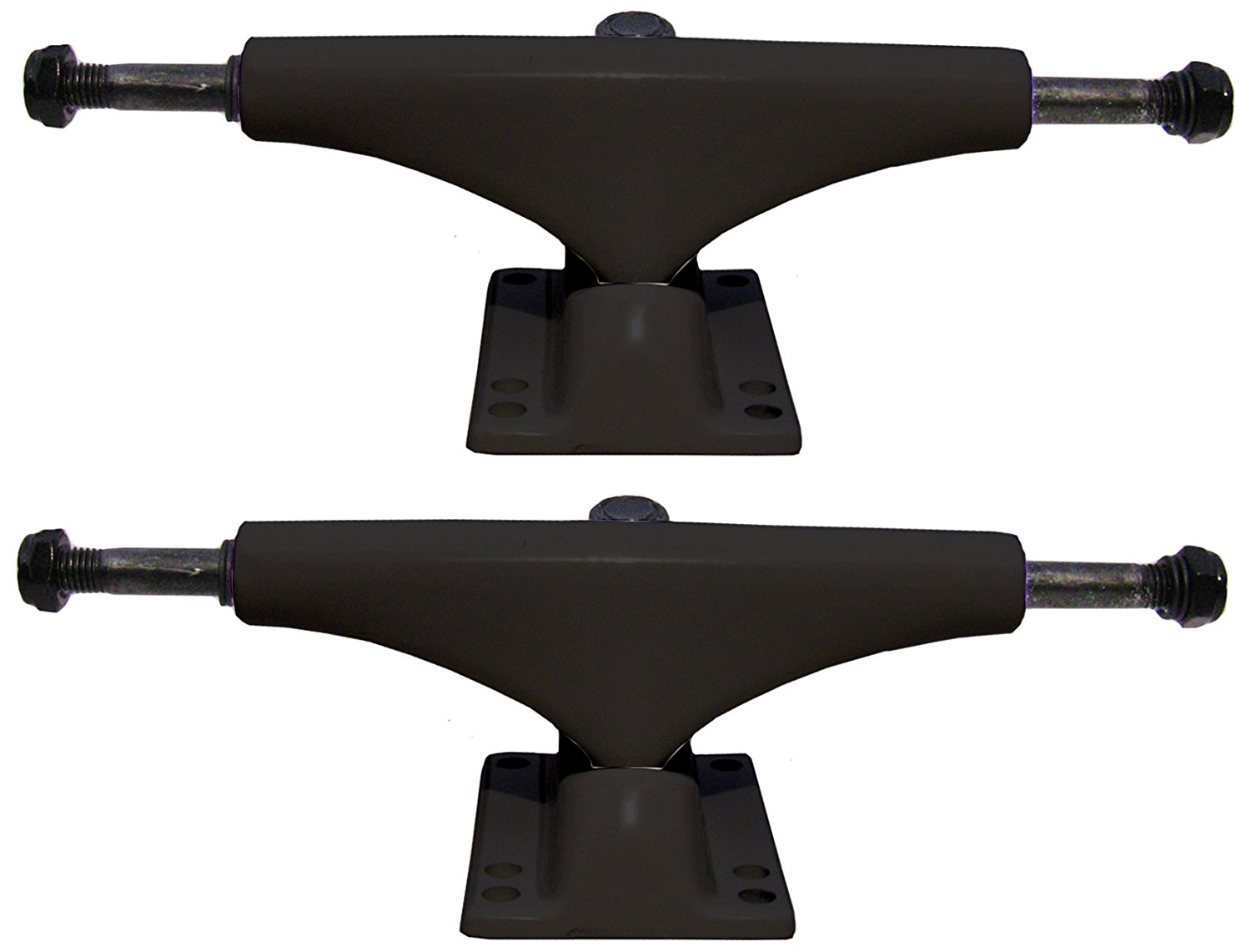

    So I ordered these today, cheap to test out another idea. Ill be able to clamp these of the back under the back 1" squared tubing at an angle. I can 3dprtin a piece to lap over the bar and line up to the holes. Im going to tighten the trucks down so they dont have as much flex but this will essentially make this more of a bolt on solution. Where the back have goes is sunk down about 1.5 inches so while this might not make sense when you hear it here, once I attach and share pics it should help.

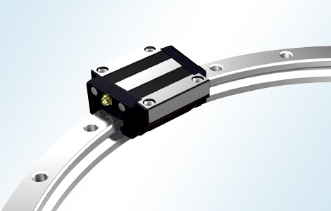

    Curved guide are very,very and very expensive. Last year I asked for them to me friend that have relations with rollon and he told me that 100cm of linear guide may cost more than 700/800 euro!

    Yeh, not completely giving up on the thought for now. I believe if I can sketch out the length and ark that I could bend some stock steel to achieve what I needed or perhaps print tracks in sections. Creating the slide out of aluminum and ball bearings wouldn't be that large of an issue.

    solution to which I had thought for Tl and calendering of a tube on which to slide the concave rubber wheels. I did calandrare a tube but as has been made clear calendering the tube still undergoes a small deformation in its diameter

    Another solutiont for Tl is calendering of a tube on which to slide the concave rubber wheels. I did calandrare a tube but as has been made clear calendering the tube still undergoes a small deformation in his diameter

    oooo I like that! I have access to a tubing bender as well, I certainly could bed a bit of round bar stock much easier. I printed a CNC machine and I think I could use those type of roller guides

    These rolled in today...gonna take the top part off, single bolt,,,then they will set pretty low profile. Seem to roll pretty smooth. With any luck I get this done this weekend.
  18. crammy
    Feb 23, 2016
    563
    Fabrication
    essex
    4,633Coins
    +326 / 2 / -0
    SCN6, 4DOF
    I would be worried about flat spots on those wheels though mate. At least you can change them if you get issues.
