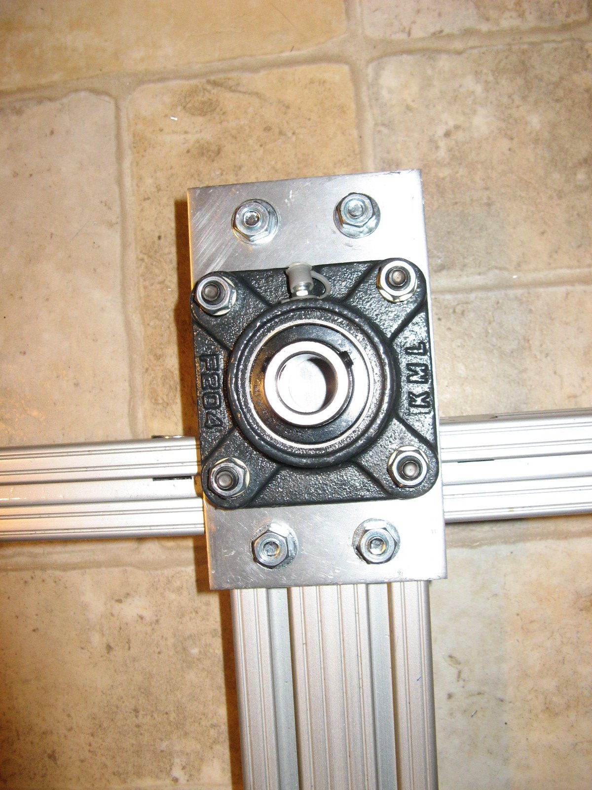

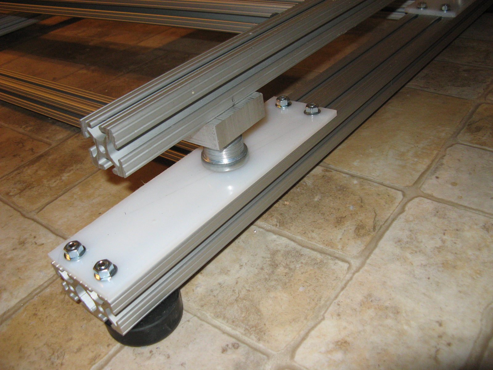

  8. Hmaia
    Hmaia Member
    Dec 24, 2012
    51
    Engineer
    Portland, OR
    136Coins
    +24 / 1 / -0
    3DOF, SCN5
    I chose a more conventional approach. Pivot point is a pillow block IMG_5825.JPG
    and the rear bearings are stud mounted ball transfer 1" dia. They run on top of 1/2" plates of UHMW hih impact. If grooves get formed with use, they can be reversed to extent the life.

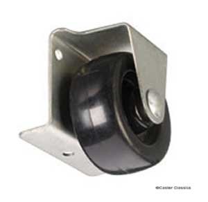

  12. shannonb1
    shannonb1 Well-Known Member
    Mar 12, 2008
    1,107
    Sales Intelligence
    Virginia
    8,909Coins
    +598 / 5 / -0
    I was thinking about using these casters , 2 in front and 2 in the back. Im using 30 series 80/20 now So I think these would low profile and line up well with my lazy susan I purchased
  13. Nick Moxley
    17,056Coins
    +2,506 / 30 / -2
    I will no longer be suggesting lazy susans for TL, Mine has started to make some noises as of late, Ya not terribly loud noises or anything and it's not like its going to out right fail, but the "track" isn't 100% filled with balls, there's a gap so they don't Bind on each other...well when all the balls line up on one side and you get a Full Travel movement from 1 side to the other, you can often Hear the balls doing their thing and all moving in unison....I thought about adding some oil to the ball track, but haven't gotten around to it. I would assume there is some light thin oil already....tho maybe not.
    Either way, Pillow Block bearing's from now on for sure...easier to mount and easier to separate the 2 frames If ever needed.
  14. shannonb1
    Mar 12, 2008
    1,107
    Sales Intelligence
    Virginia
    8,909Coins
    +598 / 5 / -0
    YEh I bought 2 of those but got 1" and they are way too big.
    ok just ordered a 1/2" ID 4 hole. I can take the lazy susan back to lowes tomorrow.
