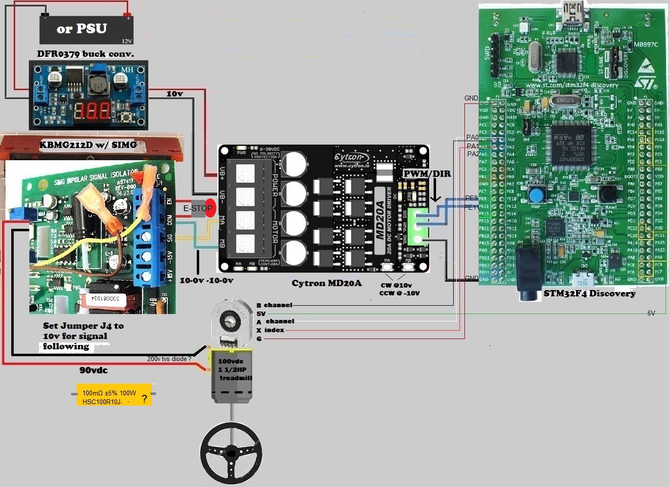

    Hi guys,dont know if anyone will be able to assist me,I have a treadmill motor which I am using as a direct wheel drive,dont know any specs of it.I have connected it to my arduino and IBT2 motor driver,it works but seems as if it lacks power,specially if I try to counter the wheel I easily overcome the wheel torque power.I am using a transformer 24v 70 amp power supply,so it has enough power.The IBT2 driver does not even get warm during use.I thought using a high voltage motor at low voltage will draw high current and therefore increase torque,but it isnt ,thats why the IBT2 is not even getting warm during use.Any ideas?

    Hi, you cant connect the 12V and 120V power supplies like you are showing. The 12V is the mosfet driver power supply and the 120V supply is for the wheel. This design is extremely dangerous if you don't understand how it works :)

    A big switch mode power supply would be the best way to improve this for a larger motor. As it is, the power supply isn't even regulated!
    You need PWM, DIR and !DIR for this to work as is. You could use a transistor to get the !DIR if you needed to though.

    I tried direct and it got soo hot it melted the wheel hub I printed and smelled of burning brushes. I guess the motor isn't meant to provide full power at a complete stall. I used the pulleys from the treadmill so maybe they are specifically chosen for the characteristics of the motor. It didn't feel any better direct drive before it melted.

    My treadmill motor was rated at 160V. That is why I use the arcade transormer to give me my HV supply. I used 36V on the bench for testing and it was less powerful than a G29. I also found my motor hated being in a direct drive configuration, getting extremely hot and burning the brushes, even with a custom blower fan.

    Only change I'd like to do now is add more caps to the PSU as it gets mains hum when above 30% (saying that 30% is too hard to drive for more than a few minutes) and add a PWM controller like a KA3525 to do closed loop current control on an additional MOSFET instead of hacking the PWM of the MMOS into the shutdown pins.

    Where I'm at with this; I can get reasonable torque at software end stops and return to center spring effect. (Moving from a G27 with over sized wheel!) The direct drive mount and encoder is a nice change from plastic.
    I've only tried some older sims like GTR2 - maybe why I have little road feelo_O. Canned effects they say. With MMOS I have to run at higher frequency 16.3?hz and PWM/DIR or I have no FFB.
    The PWM from the STM32F4 seems to convert reasonably well through the H-bridge as
    -10 - 0 and 0-10, supposed to maintain same frequency through it. KBMG picks up analog voltage faster now that I adjusted the pots for accel/decel, there is many to adjust to suit this application :eek:.
    Moving forward I'm unsure how long these brushes will last and getting a lot of noise, harmonics.
    A symptom of the SCR that might be helped somewhat with a class a or b line filter from the mains.
    I cut out the center of the treadmill pulley, welded to a plumbing floor flange makes it rough through the wheel.:grin
