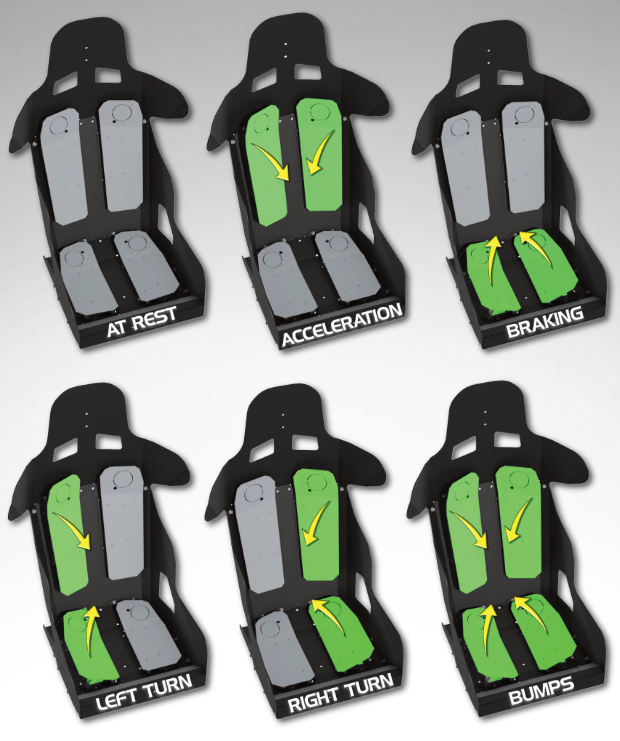

    Just out of curiosity I put in an inquiry about the cost of an ACME DMS G-seat since their advertising is loaded with "cost effective" claims. They indicated that a minimum budget of at least $50,000 for the G-seat is appropriate! D=
    I had guessed $20,ooo to $30,000 and thought that was crazy. And I thought $3,000 or so for a simple four paddle SimXperience G-seat was bad! Speaking of which, in verifying that I remembered the price correctly I just happened upon this on their site.... they called their G-seat "6DOF" and followed it with this image.
    LMAO Apparently "at rest" is a DOF, left and right is two DOF's so we could build a three DOF with one motor! We've been doing it all wrong!

  9. RacingMat
    2,234
    21,094Coins
    yeah, it's stupid marketing shit calling this seat a "6DOF"...
    it's a nice 3DOF gseat though

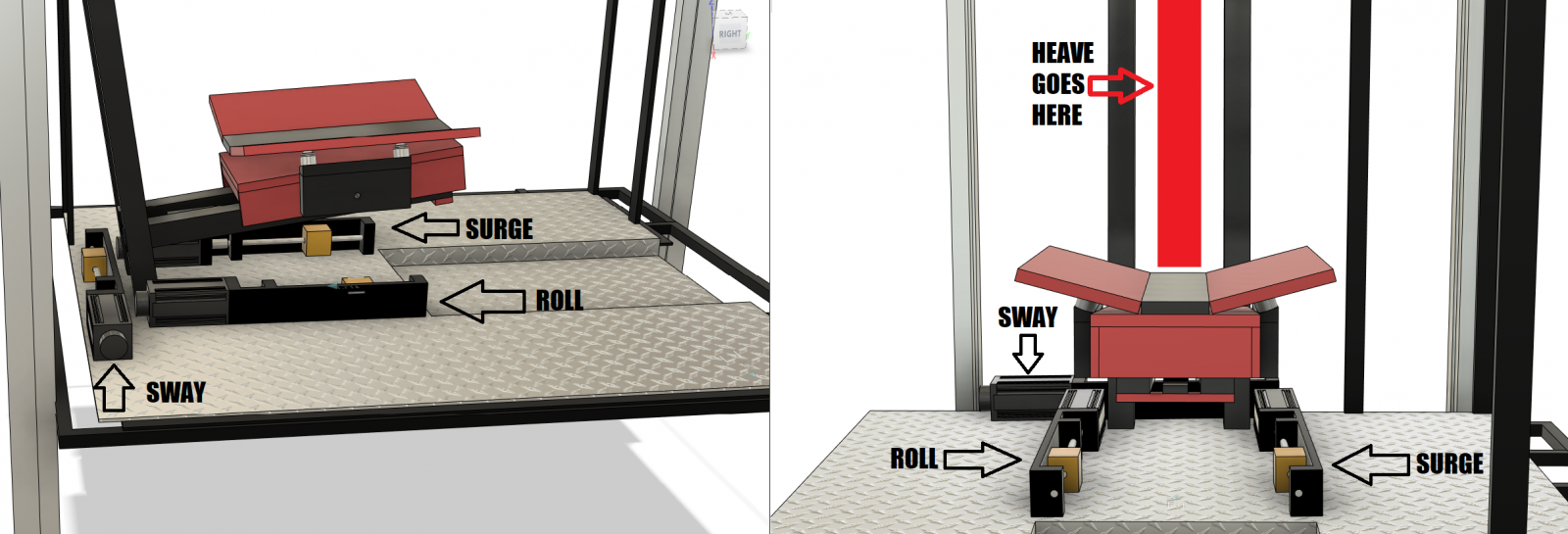

    Simulator Design Evolution
    The biggest news is that I've decided to add a small surge and sway table to my design! Approximately -4/+4 inches for a total of eight inches on each axis. That's -100/+100 mm total 200 mm each axis for people on the logic system. This will make much better use of the servos I have that are massive overkill for the G-seat.
    The surge and sway axes will simply be hooked up to the same actuators running those axes on the G-seat by linkage of some kind. This will give me an additional way to really sell the onset cues for snap rolls and carrier launches and landings etc.
    I've also decided to go back to running the G-seat bottom cushion roll on the sway actuator. I feel more comfortable having the three motors powering the heave elevator instead of just two. Two can handle the load, but I was worried about the load being imbalanced. I think I'm fairly likely to add a seventh channel for that so I can adjust "roll" separately from sway in the software but I'll try it without that feature first.
    Also, I'm adding a description of the mostly finalized design to the original post here. It's mostly copied from the conversation in that other thread.
    Edit: Trying to fall asleep I remembered a couple inconvenient facts about the decision to switch back to three actuators for the heave elevator. First, I only ordered two of the 1500 mm ballscrews so I'd have to order a third. That's another $75 or more. Second, I remembered the specific reason I really wanted seat bottom roll tilt separate from the seat back sway. For sway cue I want the seat back sway and seat bottom roll to move together (for knife edge flight, tilting on the ground) and for roll rate I want them to move opposite, the bottom rolls the direction of the actual roll and seat back sways opposite to create the lateral g-force from the sudden change in rotational velocity. I edited the OP again to correct that, and also to add the active harness tensioner system which I had forgotten to put in there.
    I either have to go back to only two heave actuators or commit to adding another actuator system to go to more than six actuators. I'll try the former first. If I have problems then I'll get another controller (Thanos) and at least one more servo and ballscrew. That's a lot of extra expense. If I do that I almost might as well get dedicated servos for the surge/sway table too which is even more expense. Down the slippery slope I slide. Again. =D
    I think I'll be ok with just the six.

    Hey, for once it was easier than I expected to figure something out!
    I think all I really have to do now before I can start building is finish the G-seat drawing to make sure there isn't anything I'm overlooking.
    I might be cutting steel within a week or so. =)
