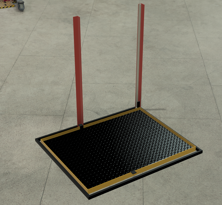

    Progress update: Today I hit a landmark. Welding has begun! All of the elevator parts have been cut, and I've welded up the four half-frames for the perimeter frame that holds the towers in place. That's all I can weld for now without causing problems later.
    Next steps are drilling the elevator lift frame for the bearing blocks at the four corners, drilling the corner towers to attach the guide rails, and drilling the lift towers to attach the actuator parts.
    I'm a bit tied up now waiting for a new drill press to arrive. My old one wasn't very good to begin with and after 25+ years of use it's got issues, not the least of which is run-out. The drill press will arrive between Wednesday and Monday, so in the meantime I'm going to work on my drawings for the G-seat itself and the details of how to mount the servo motors to the lift tower actuators.
    If anyone has built ballscrew actuators on steel angle iron, feel free to drop me a link here. =) These will be my first ballscrew actuators. The motors will be mounted beyond the end of the 2" x 2.5" x 3/16" steel angle at the top end. The bearing blocks will be mounted to the wider side of the angle.
    I believe I've got the mechanical design of the seat all figured out, but I've changed what materials I'll be using to build it so I need to rework the structure.

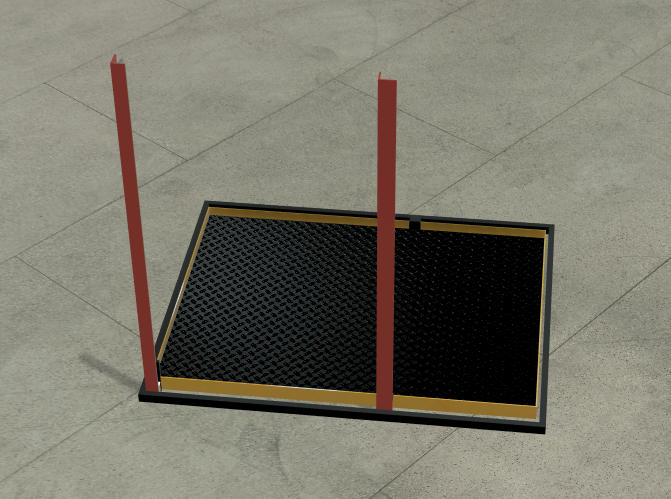

    Here are a couple very incomplete images. I don't want to waste time finishing the drawing, too much to do! The yellow part is the angle iron frame that goes up and down. The G-seat and the entire cockpit will be built on that.
    The black frame on the floor is the bottom "perimeter" frame. There will be another identical one three feet or so up from that one, and these are stationary. They hold the towers in position. I want to weld them to the towers rather than bolt them, so I split them in half to make two assemblies (left and right halves) that can be moved through doorways. Those frames are what I welded up today.
    About the towers (red):
    The tower at the corner is one of the ball bearing guide rail towers. There will be one at each corner (four total), attached at the side of the elevator platform.
    The one that isn't at a corner will be one of the two lift actuators. There will be one to match on the opposite side. The black "tabs" on the yellow frame will be welded steel angle, and are what will be attached to the ballscrew nuts. They too are 3/16 steel angle, but I think I should probably add some extra support structure to them as well since the dynamic load of the entire platform will be supported on them alone.

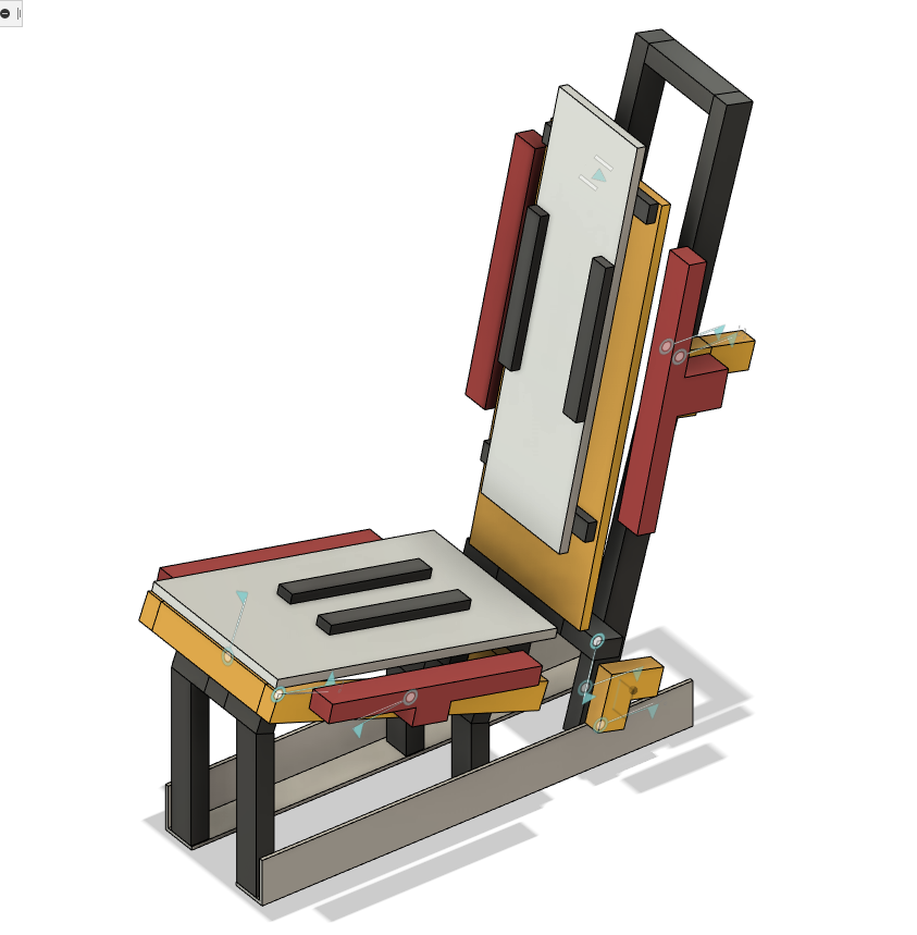

    The G-seat final schematic is mostly done, and it's bed time. =) It's missing lots of detail because in this case all I'm figuring out is the structure. I'm using 1" x 1.5" 11 gauge rectangle steel tube for most of the construction. Not too heavy and easy to work with.
    I'm also making the seat bottom and seat back completely separate assemblies bolted to a pair of angle iron rails at the bottom. This will allow me to adjust the angle of each independently and also how far forward/back the backrest portion is relative to the bottom cushion. This way if I decide I don't like the way it feels I can adjust it fairly easily.
    I also want to be able to tilt the whole thing back significantly for the F-16, and also potentially F-1 cars though I've never done the F-1 thing before.

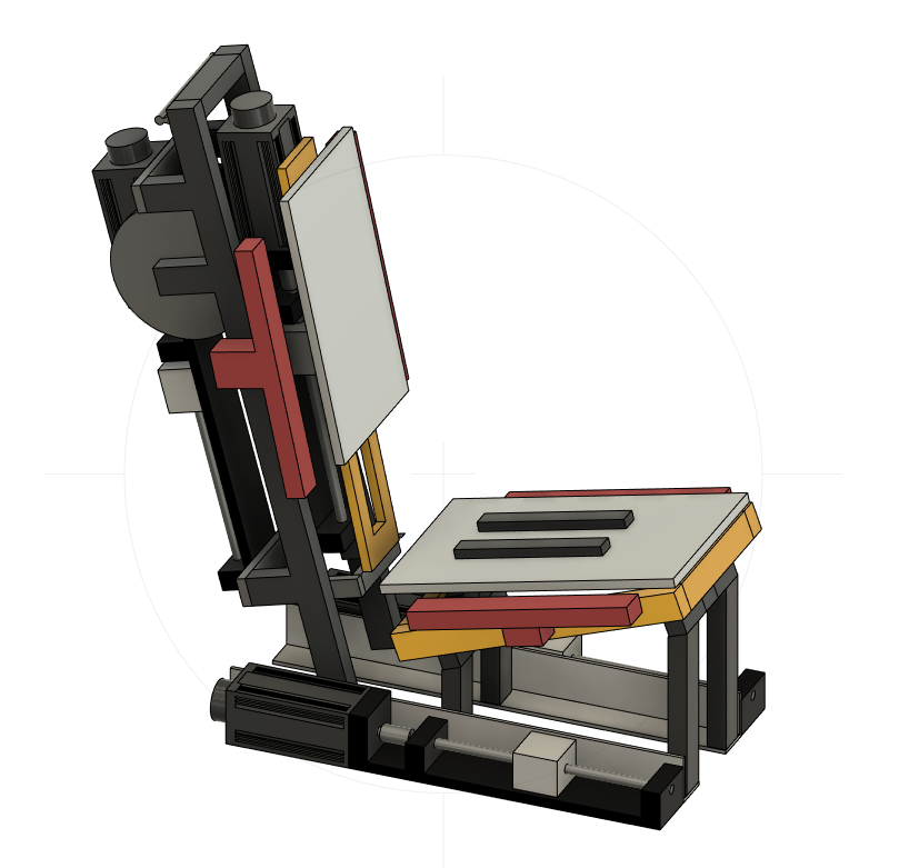

    It's been a long road with an unbelievable number of iterations drawn up in Fusion 360 but the G-seat design is nearly finalized! =)
    Still have to work out the details of the harness tighteners, head loading, and G-vest but most of that is Bowden cable stuff and should be very easy.
