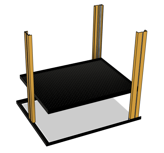

    Thanks for the reply @Trigen I'll have to look at your build as well. I have thoughts of using some air stuff too, but no idea how to build an air system until I look at the threads of some folks here.
    My project is sadly on hold for at least a few months while I deal with my father's estate, move back to my own house, and then build the room that will contain my simulator. I may build a CNC router first as well, which should aid in the construction of my simulator and other projects.
    I stopped by these forums because I again have my thoughts going to the possibility of driving my entire "heave elevator" with one motor instead of three. This will solve the problem of a malfunction setting my towers out of sync, and also allow me to add two channels to my G-seat which I very, very much wish to do. The compromise of limiting my G-seat to three motors has been an unhappy one, and has wasted quite a lot of my time in design.
    Is anyone here able to tell me whether a gear belt or chain drive setup might be appropriate to drive all three of the towers in my elevator design (with some modifications of course)?
    Note: For scale, this platform is around four feet wide, and the towers will move it up and down more than 1300mm with a 1500mm long 1610 ballscrew in each of these three steel towers. Any drive system for all three towers would have to be added at the bottom, not the top.

    After SeatTime's reply on his thread this is what I'm thinking:
    I had considered using a counterweight system so that the load of accelerating the platform up vs. down was closer to symmetrical. A counterweight system could also drastically reduce the torsion load that would result from driving the platform from just a single point along the perimeter. That along with the guide rails should be enough to make driving the sim with a single servo motor an option.
    Alternatively or supplementally, direct drive one actuator tower with a 1.8KW servomotor, and connect the other two ballscrews to the first using a gearbelt setup located at the bottom, essentially below the simulator as I have drawn it so far.

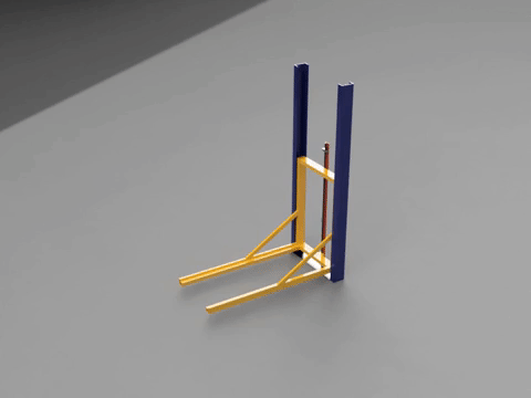

    @SeatTime @Thanos @Dirty Do you guys see any problem with me using this servo with Thanos AASD to use as a single motor for driving my "heave elevator"? The ballscrews I have are 1610. I could get a single larger ballscrew if needed.
    https://www.aliexpress.com/item/32817083774.html?spm=a2g0o.cart.0.0.1b813c007PvtBh&mp=1
    The design I'm contemplating is similar to a forklift.
    The fantastic news about Dschadu's Motion Compensation solution for VR motion sims has got me thinking hard about my sim build despite the fact that it will be a while until I'm able to resume work.
    I'm thinking much harder about possible ways to build my long travel heave elevator using only one large servo motor.
    I'm looking at things like 2-post automotive lifts and forklifts and thinking that all I need is an adequately strong (and smooth) linear guide assembly and I can do this easily. This should actually simplify the construction a little bit as well.
    What I'd like to do is have the entire lift and lift guide assembly be at the back of the seat. This would also make it much easier to swap on different cockpits that I build in the future.
    I can also add a counterweight if needed so that the elevator actuator isn't "lifting" the entire weight (probably 700 pounds plus), but rather just accelerating the total weight of elevator and counterweight.
  7. SeatTime
    2,572
    May need a drawing of this new design to comment.

    @SeatTime Here you go, very rough drawing of the general design idea made just for you. ;)
  9. SeatTime
    2,572
    Ok that is pretty much like how the commercial ones work and similar to how I am building mine, as the drive unit design really does not change - either driven from the side, or back as you have shown. I may end up testing both to see what works best. Note that the further you move the load away from the drive/support point the more the possibility of the rig bouncing/oscillating at changes of direction - that point + foundations and the rig in general needs to be very solid. I don't think that a single 16mm ball screw would be too happy taking all that load.

    I too was thinking I'd either need a bigger ballscrew or perhaps could use two of them, one on each side driven from a single motor.
    EDIT: After much internal debate I think I'll more or less go back to the original plan. The "Forklift" design would have quite a few benefits for me, but the additional engineering challenges and expense are probably not worth it.
