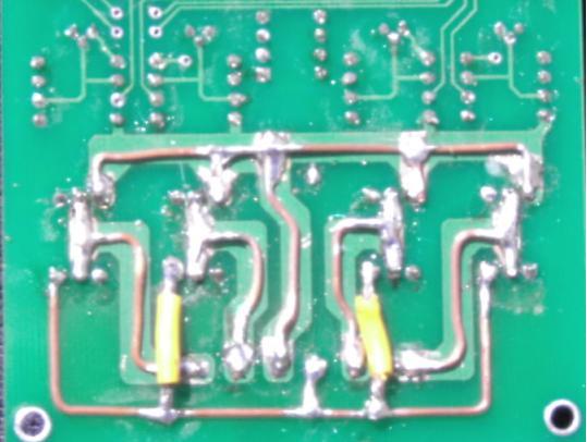

    Hi yes I recognised the circuit and also the 74HC08 of the KT-5198. Nice to know you've hacked a proven circuit!
    Yesterday I powered up a similar H_Bridge circuit from Ocean Controls (Kit 166V2) using the same fets and one of the FETs (Z44) blew a hole in itself with a very loud bang. And only using 12V.
    This was because the cheap PCB copper melted in 3 areas and the FETs overheated very quickly.
    So the PCB will have to be a heavier micron copper than what they use and most definitely FETs need fan cooling.
    #update#
    I discovered 3 of the 4 mosfets blown. It appears a common problem for mosfets is if one blows it tends to short across Drain-to-Gate, and then the power surge shoots up the driver circuit and the other FETs blow like dominoes. Some circuits add diodes across source-to-gate to reduce the problem. Anyway..
    A request: When you layout the H-Bridge onto PCB can you design so the Mosfets are really really easily accessible to replace, like isolated away from the rest of the circuit. The kitset design I was playing with (kit166v2) is just too tight and close and is a real pain in the #### to work with.
    This way we can easily and quickly replace them if they overheat and fail.

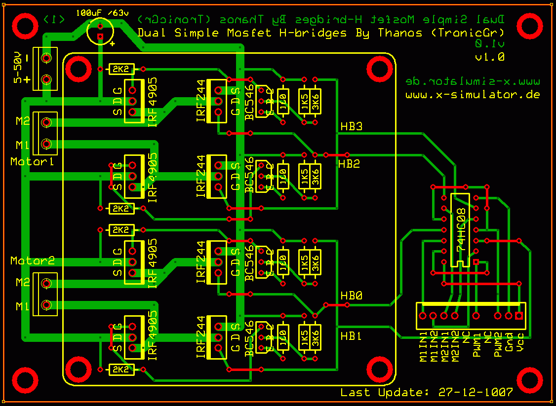

    First of all I finished with the design of the new simple H-bridge motor controller! Implemented almost all of your requests, except the diodes cause I didin't know how to properly place them (EvanF please help me in this...)
    [​IMG]dual_simple_hbridge.pdf (190.95 KB)
    [​IMG]dual_simple_hbridge_bottom.pdf (46.33 KB)
    I prepared the layout of the simple H-bridge motor controller in such way that you can mount it directly on top of the AVR motion controller with some distance holders.
    Also I put extra holes to be able to mount on it a standard 80mm PC case fan to cool the Mosfets! And I leaved enouph space on the back of the Mosfets to place some heatsink (such as a drilled piece of aluminium) for cooling too. Just be aware to use insulating bushes and washers to ensure that there is no electrical connection between any of the FET’s as they do not sit at the same potential.
    To mount the motors wires on it I used a PCB type cable connector with bolts, and the same for the power cable from the battery.
    Here is the link to the connectors:
    You can Power it with voltages from 5Volt to 50Volt if you want, and the maximum continuous current it can handle is 49Amp if cooled well. But to reach this 49Amp rate you have to strengthen the power lines (the thick ones) with lots of additional solder!!!
    *Update: another way to strengthen the power lines is to solder thick wires like in the photo that Erich sended me:

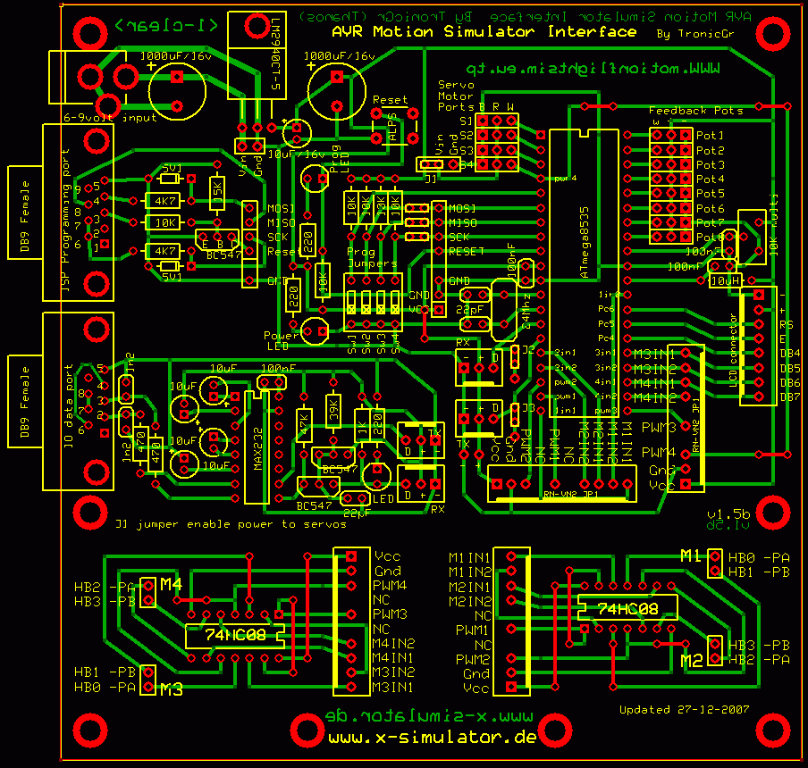

    As if this present was not enouph I also prepared a new AVR motion controller v1.5b layout that contains additional circuits to handle four external H-bridges if you own a commercial type ones:
    [​IMG]AVRmotionsimulatorcontroller1_5b.pdf (375.17 KB)
    [​IMG]AVRmotionsimulatorcontroller1_5b_botttom.pdf (50.77 KB)
    [​IMG]AVRmotionsimulatorcontroller1_5b_botttom_filled.pdf (73.06 KB)
    Its the same as version v1.5 in dimensions except from the extra PCB in the bottom that contains the simple H-bridge driving circuits.

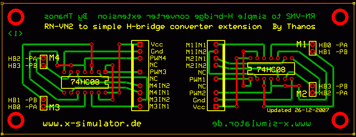

    And in case that you already ordered a AVR motion controller v1.5 layout here is a separate extension PCB that has this extra circuitry to drive four simple H-bridges:
    [​IMG]PWM_to_simple_hbridge_dual.pdf (121.09 KB)
    [​IMG]PWM_to_simple_hbridge_dual_bottom.pdf (28.12 KB)

    *EDIT: One thing I need to implement to protect the Mosfets from overheating (and eventually failing), is to add some sort of thermal protection cuttoff! One way to do that is to use an unused ADC port of the AVR controller to measure the temperature using a simple temperature sensor (with variable resistance output). So in case the temperature goes over a certain temperature I could shut-down the driving on the h-bridges to avoid more troubles... Just a thought!!

    Remember to use silicon paste between the mosfet and heatsink too!
    From what I have read about H-Bridges when they fail they often go short-circuit drain-to-gate. This can put the drain voltage back onto the gate where of course it feeds back into the 74HC08, possibly blowing that section. This could be time consuming if not disastrous! It could be a good idea to add a source-gate zener diode; zeners fail short circuit and it could limit the damage in a failure! You can also add subminiature gate resistors -- which tend to fail open-circuit (like a fuse) under this overload, disconnecting the dud MosFet's gate.
    For a 24volt supply a 16V zener for each mosfet should be okay.
    #update
    Here is another place to add diodes according to http://roko.ca/articles/hbridge.php?page=3
    EvanF

    @Evan
    I am not sure if the first schematic makes sense, as it seems to me that it just bypasses the cuircuit!?
    The second schematic look way more reasonable to me.

    RE: Zener Diodes in H-Bridge
    Numerous reasons.
    I think one of them is to keep the voltage below the rated VGS-max of the mosfet in case of a breakdown elsewhere. (Gate-Source Voltage =
    the voltage of the gate relative to the source,) The rated VGS of both FETs are 20V. If you exceed this voltage limit, you will destroy your mosfets. If you are running with a voltage higher than the rated VGS-MAX, you need to limit the VGS voltage difference. The easiest way to do this is to use Zener diodes to limit the voltage.
    2.The power FET is characteristically very susceptible to static electricity between the gate and source; therefore, the Zener will be used to combat this potential problem.
    But it is not really necessary if you know what you are doing regarding static protection and you keep your supply voltage below 20V.
    Regarding ByPass: PWM logic is 0 - 5V, in this instance I'm not sure if a 16V Zener acts as a shunt regulator, and maybe it won't even conduct at 5V anyway?, I dunno enough about Zeners to say for sure, but Nchannel mosfet switch when voltage is greater between the Gate and Source threshold and Pchannel mosfet switch when the voltage at Gate is less in comparison. Maybe this helps understand why the Zeners are there.
    EvanF
