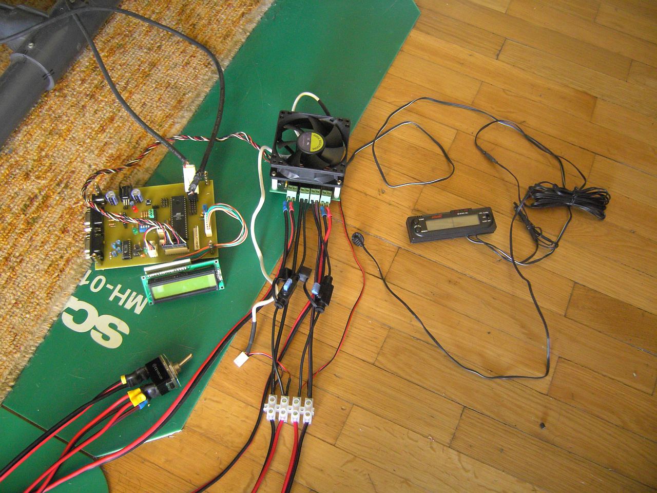

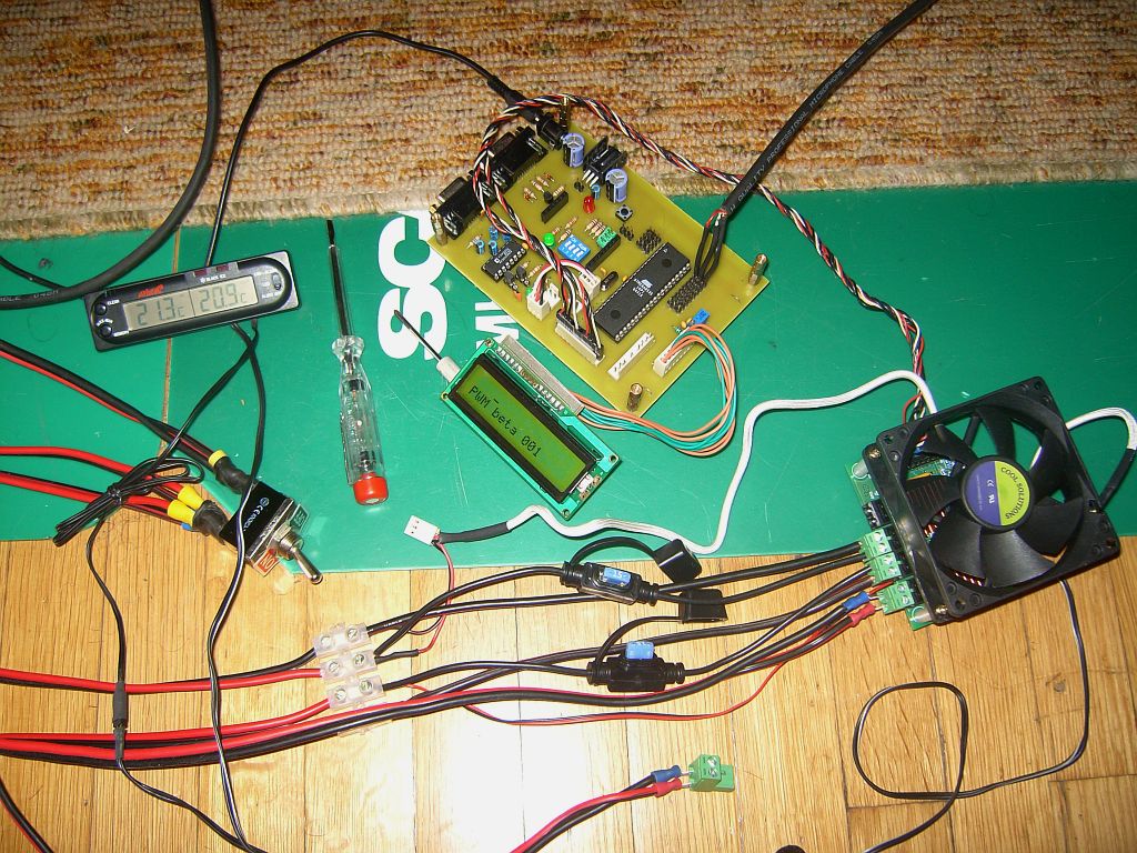

    I found some time during weekend to attach the AVR motion controller on the joyrider using the RNVN2 motor controller:
    But I noticed some strange behavior on the wiper motors, that I explain in Bug-Tracker:
    bugtracker/viewbug.php?b=12
    Regards, Thanos

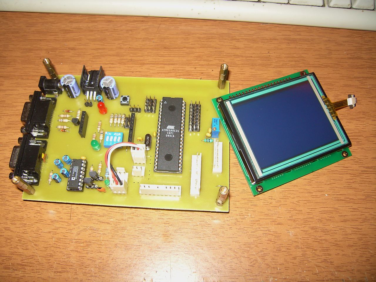

    I received my new graphics LCD (128x64) with touchscreen and backlight! See how large it is:
    It can be great add on for the simulator as I could implement a graphical interface to control all the parameters of my AVR motion controller while playing! And since it has touchscreen no extra buttons needed! The way I see it I could use a second atmega that drives the GUI and reads the touchscreen, connected to the main avr motion controller with I2C...
    I could even use it to display other stuff like Gear number, Speed, or RPM maybe ;-)
    Any ideas?
    Regards, Thanos

    Would be cool to interface it with the profiler, in order to be possible to display DIY gauges.
    But imho virtual gauges have a low priority currently
    Your screen looks way more square than 128x64 !??
    regards
    Christian
  12. tronicgr
    tronicgr
    Re: Tronic's PWM/servo control Interface with encoder/pot input
    Yes, but If I fix it, that way, that retrieves the gauge data from AVR motion controller, it will be much faster! With profiler2 this would be piece of cake! :schreiben:
    Yes, its more quare than others that I've seen around...! Have a look on it, in operation:

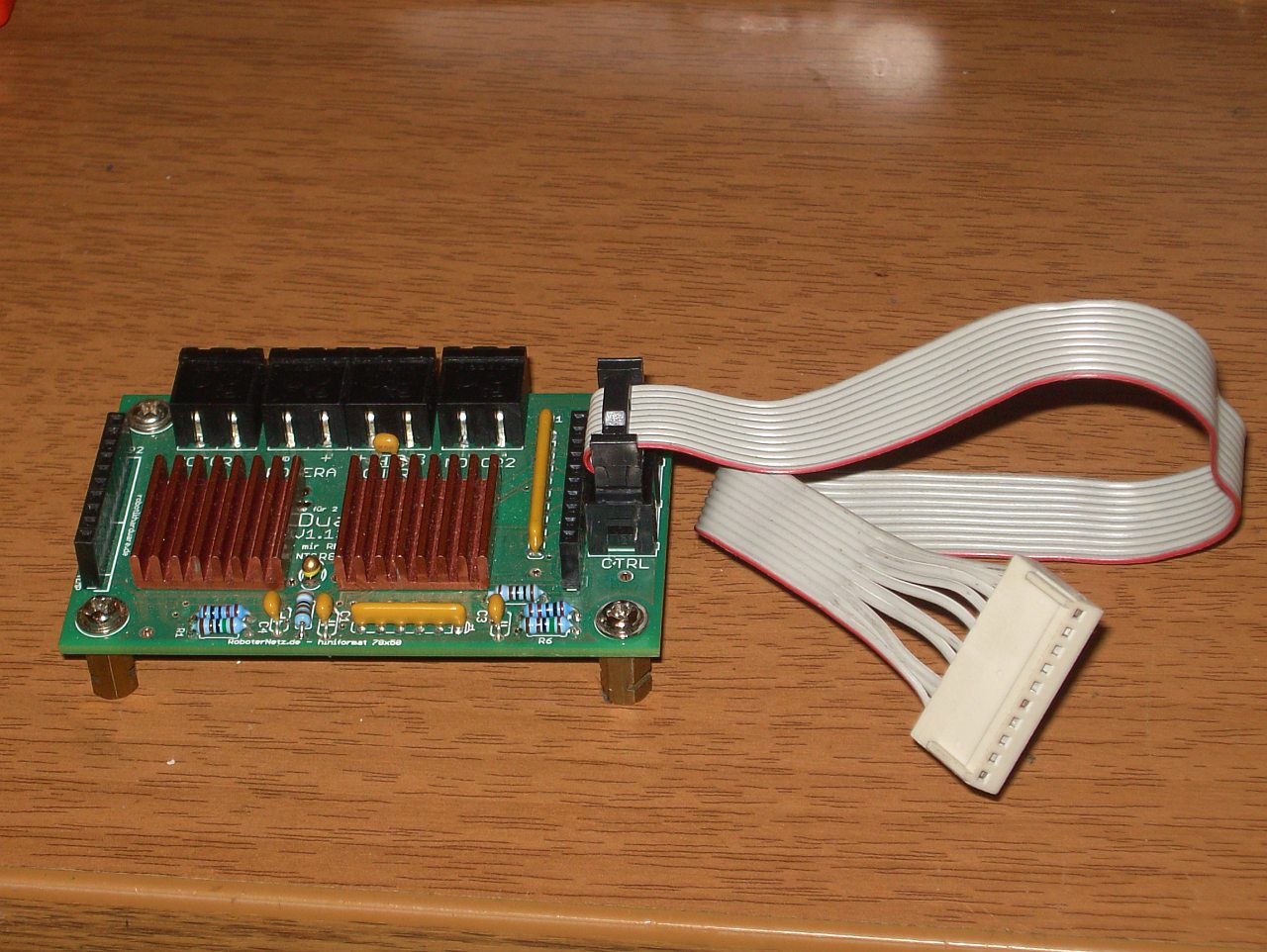

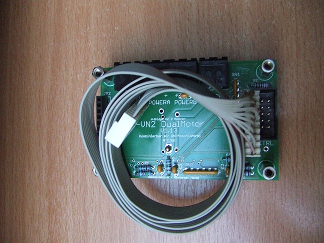

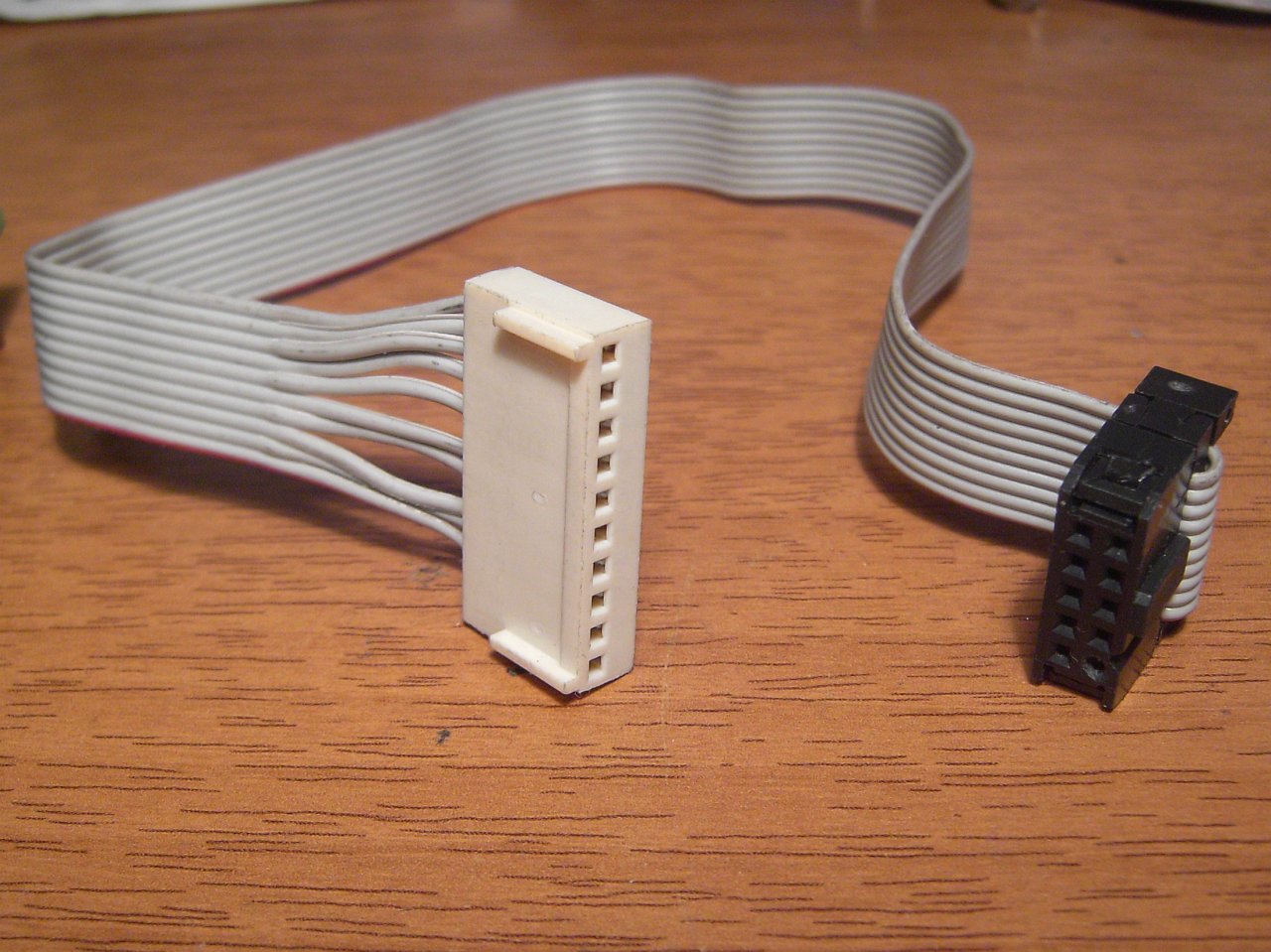

    I wanted to mention something important about the wiring between RNVN2 and my AVR motion controller.
    From the version 1.5 , I changed the pin outs of the molex headers by swaping the pins 7 and 8 to be easy to attach an IDC connector on the RNVN2 side using a flat ribbon cable.
    Here is the pin definitions from the RNVN2 manual:
    CTRL (10PIN socket IDC)
    Pin 1 engine 1 IN 1
    Pin 2 engine 1 IN 2
    Pin 3 engine 2 IN 1
    Pin 4 engine 2 IN 2
    Pin 5 return signal of 0 to 2,5V Current measurement for engine 1
    Pin 6 Enable Motor1 (PWM)
    *Pin 7 return signal of 0 to 2,5V Current measurement for engine 2
    *Pin 8 Enable Motor2 (PWM)
