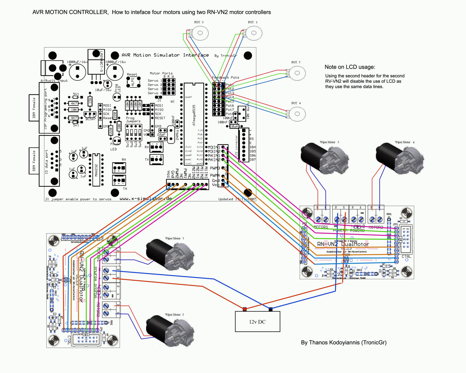

Tronic's AMC motor motion-controller with pwm/servo output

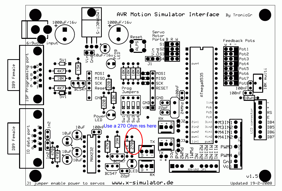

    I got several complains that there was problem with communication of the AMC (Avr Motion controller 1.5) with USO. So I made a one by one compare of my prototype AMC with the plans I gave... Guess what... I found that I gave wrong value to one resistor... It supposed to be 270 Ohm, while I gave a 220 Ohm value for it on the PDF plans and the Part list...
    Here is the resistor that causes the problems and need to be changed with a 270 Ohm!
    I wish I had seen it before, but I when I used this resistor on my prototype PCB I had it in bag marked as 220 Ohm... So during checking it again now I noticed the different color stripes on it and measuring it with a multimeter ended up to be a 270 Ohm :-( I still can't believe that this 50 Ohm difference is so critical!
    I Updated the PDF plans on the first post and I'll fix the part list too later.
    Sorry for the inconvenience! Its under beta yet after all!
    Regards, Thanos
  10. egoexpress
    egoexpress Active Member
    Dec 13, 2006
    3,839
    Germany - Frankfurt/M
    421Coins
    +10 / 1 / -0
    Re: Tronic's PWM/servo control Interface with encoder/pot input
    Its a pity that I've sent you my interface yesterday.
    Dont mind. Now I've waited so long to move my sim, now some days more wont make a difference anymore :)
    I just have been wondering how I could have made a mistake. Just some res and caps, and all critical parts socketed and I was not able to establish an USO connection :jinx:

  11. tronicgr
    tronicgr
    Hi, Christian,
    Yes, I hope that this was the last bug ... I want to move on to the 6 DOF AVR ultimate motion controller and these kind of problems just keep me back, trying to find solutions...
    :sos:

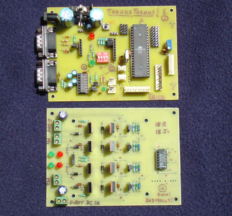

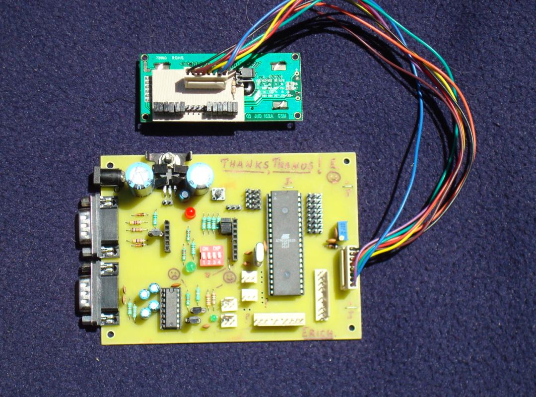

  13. tronicgr
    tronicgr

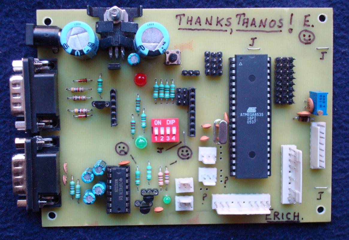

    It will be not much time before we will see some motion sim cockpits fully working and interfaced with my AVR electronics!
    I almost feel shy that I had not much time to put all the parts together and use them on my joyrider first. :blush: Any time I wanted to focus and finish it, something new was getting in the way...
    One of them, that have all ready, is Erich, that he kindly send me some photos of his boards!
    8
    9
    His motion sim is a 2DOF joyrider-like cockpit but with all-metal welded frame! I hope that we will have video from it in action soon! At least sooner from mine... :)
    Thanks Erich! :cheers:
    Regards, Thanos

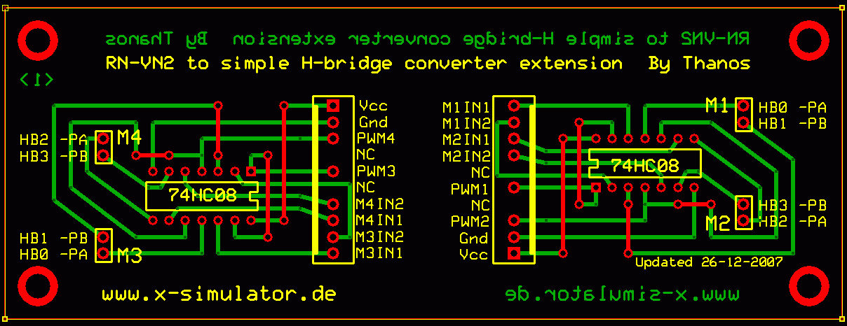

    After general request for PDF PCB layouts that are placed in single page, I made single pdf layouts for some of my boards:
    avr_motion_sim_PCB_single_1_5.pdf
    avr_motion_sim_PCB_bottom_single_1_5.pdf
    avr_motion_sim_PCB_bottom_single_1_5_filled_ground.pdf
    And the PWM signal to simple h-bridge inputs converter:
    Dual_PWM_to_simple_hbridge_v1.pdf
    Dual_PWM_to_simple_hbridge_v1_bottom.pdf
    Also included Top and Silk layer for reference reasons only. Use only the PDF that is marked as bottom to send to the etching service.
    Thanks,
    Regards, Thanos

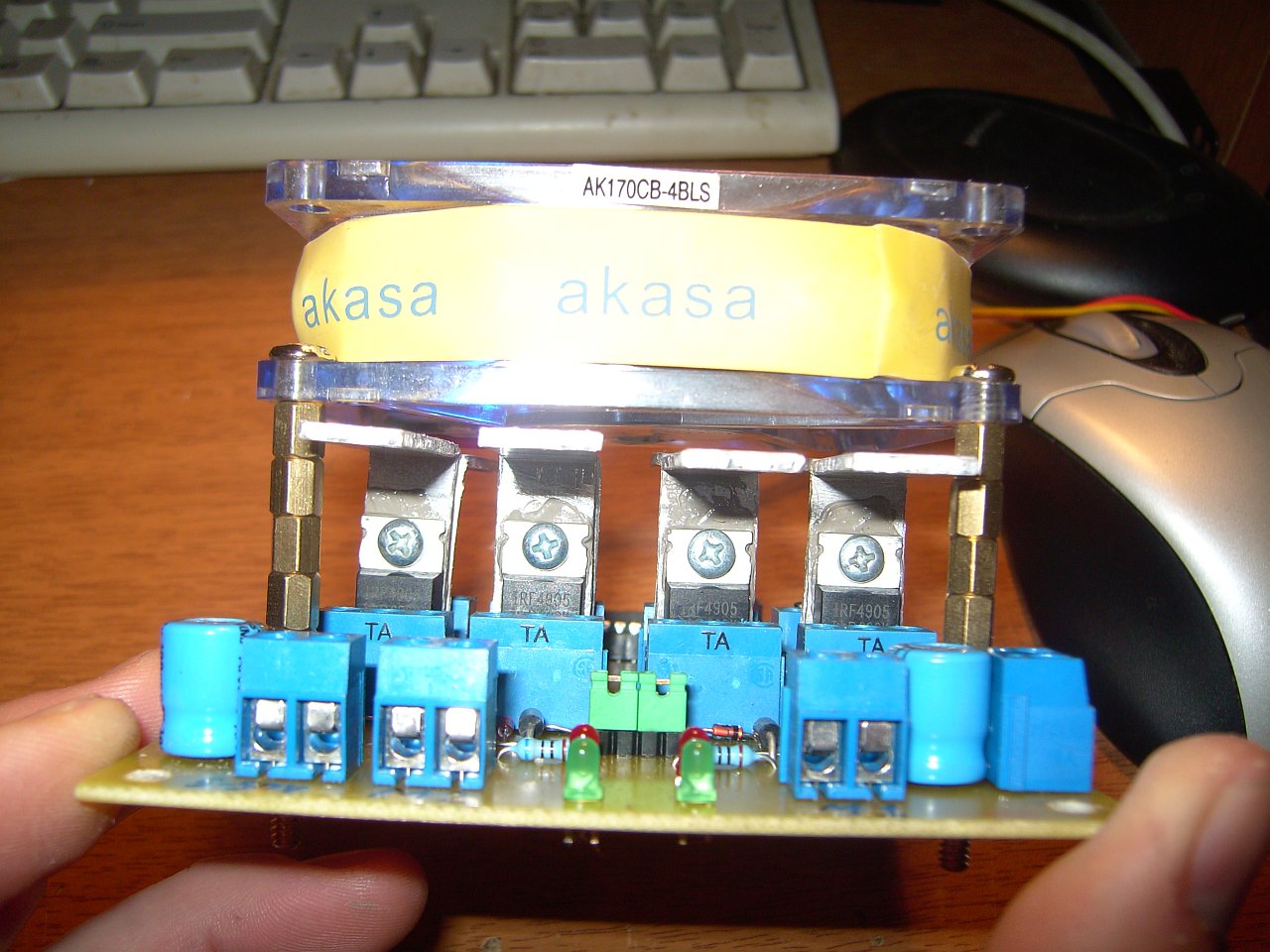

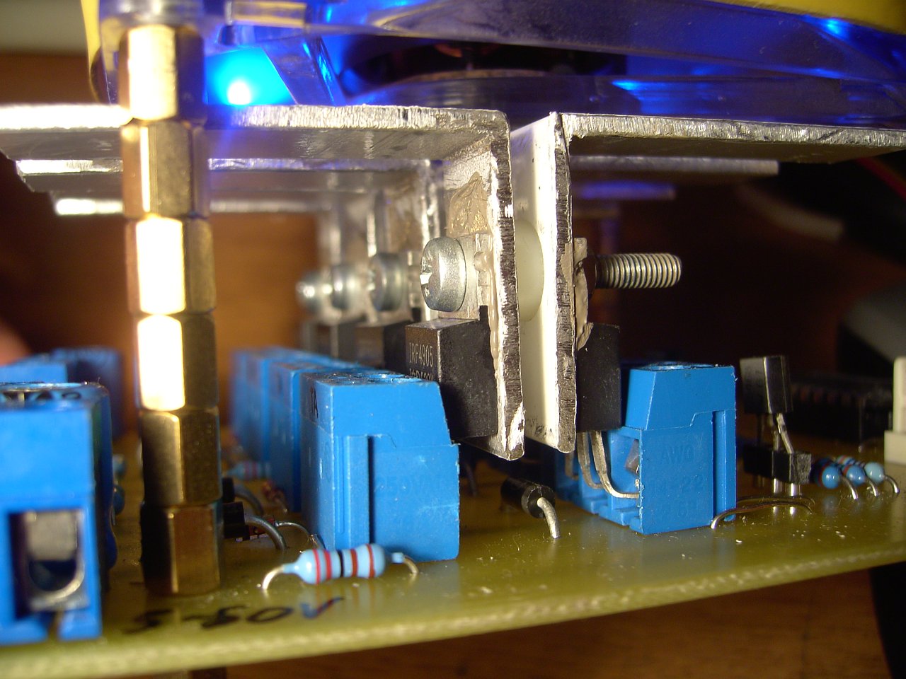

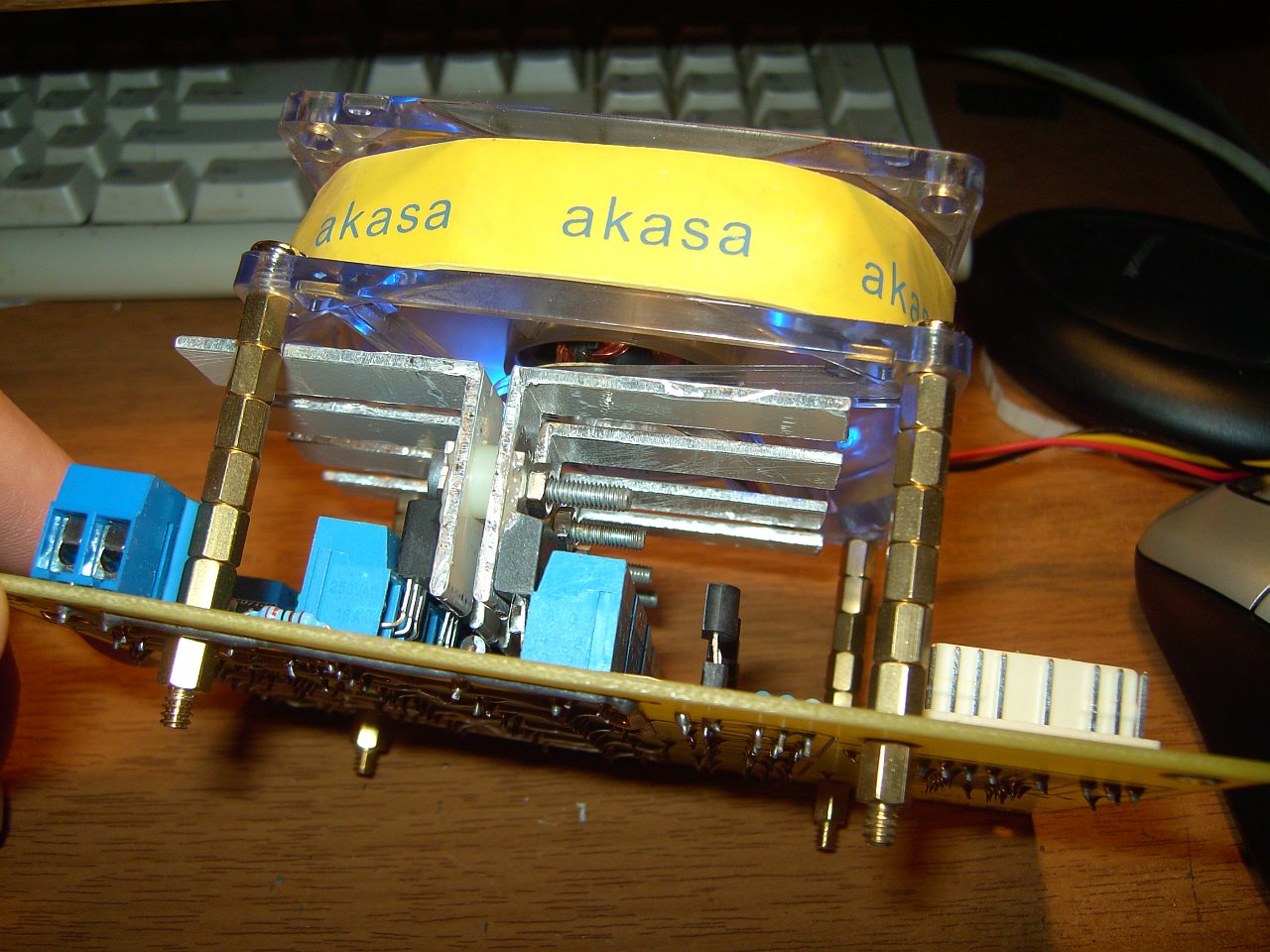

    I had a little drawback. Today I noticed that the GND of the actuators pots have connection to the case. This causes some trouble. Now, I have to find a way to isolate the pots from the case.
    Just wanted to tell you guys that it is nothing caused by Thanos' brilliant interface. Its just my acutators! :jinx:
    Regards
    Christian

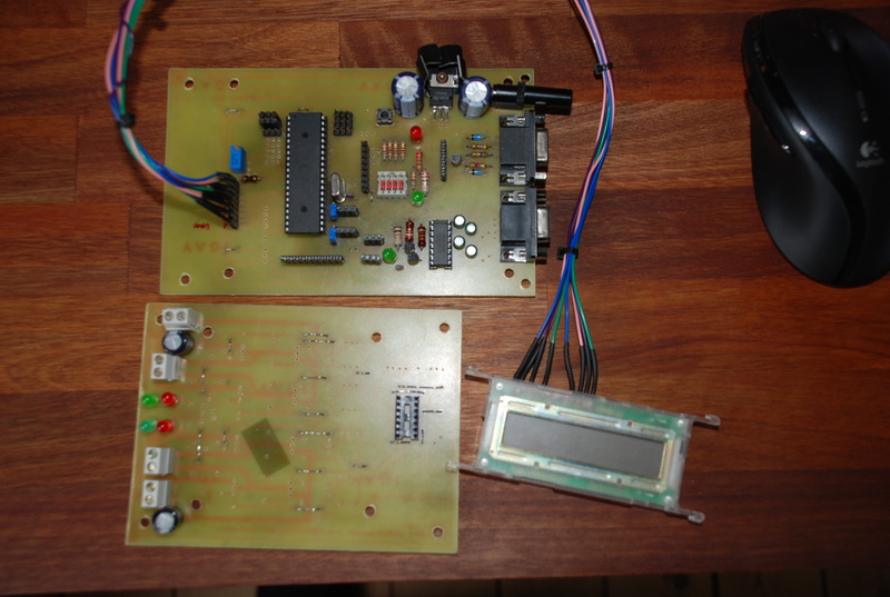

  19. Ferrari_Man
    Ferrari_Man Member Gold Contributor
    Jul 17, 2007
    107
    Copenhagen
    - 5Coins
    SCN5, SimforceGT
    Hey..

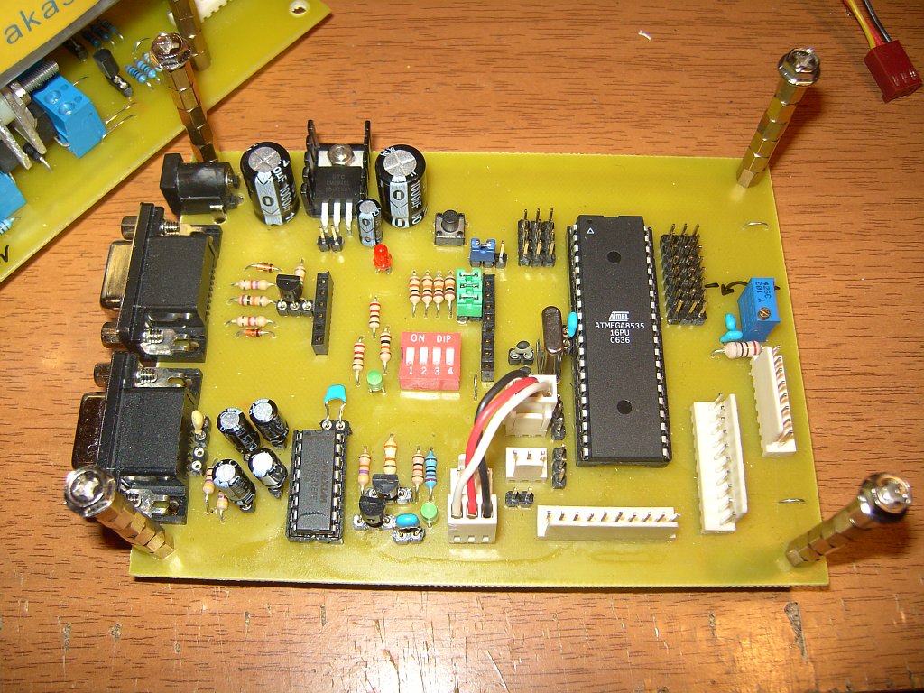

    Any news on the projekt, I am very interrested in hearing about it. Here are some picture of mine, its not finished but I hope to get the last parts monday or tursday.
    I also bought 3 motors and some pots... ( only need some gears for the pots )
  20. tronicgr
    tronicgr
    HEY!!! Is this a mirrored photo or you have etched WRONG your PCB boards?????????? :eek:
