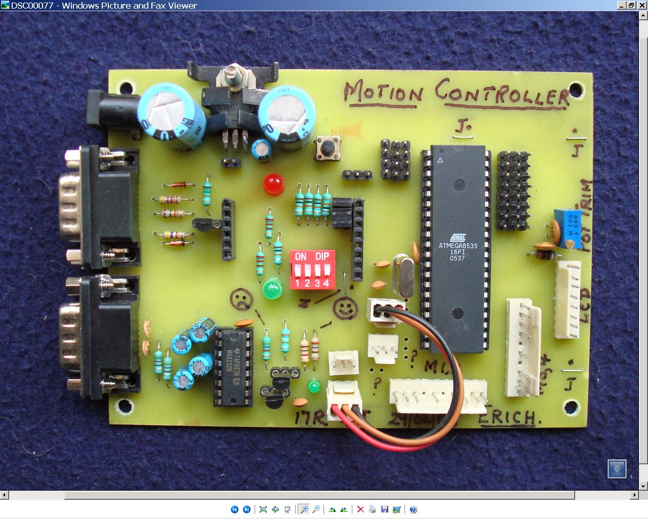

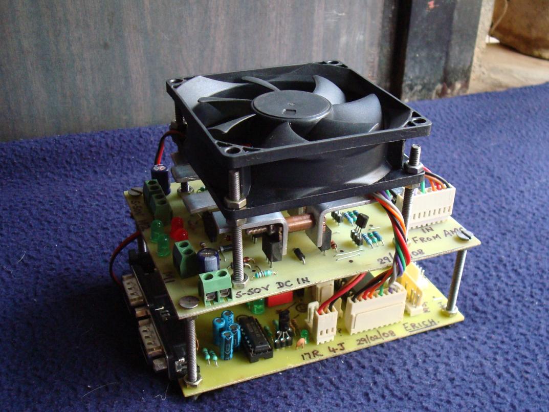

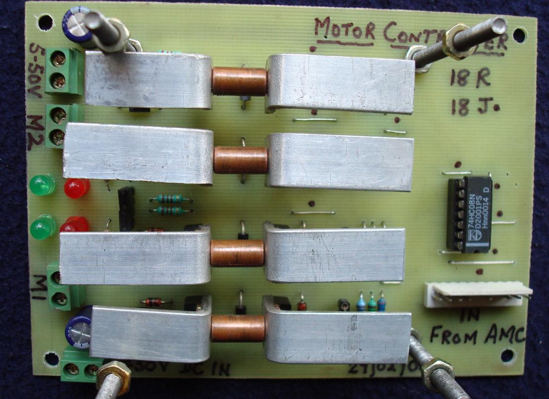

  5. tronicgr
    tronicgr
    Re: Tronic's PWM/servo control Interface with encoder/pot input
    Hi everybody,
    Erich has sended me more photos from his boards that now are complete and ready to test:
    As you can notice he used metal distance holders to attach the cooling aluminum stripes on the mosfets to avoid have the plastic one's melt under great heating if anything goes wrong. This will ensure that there is always firm contact between the cooling stripes and the mosfets!!!!
    Its a master-piece! Good Job Erich! (I know that he keeps visiting the forum and reads this 8) )
    Regards, Thanos

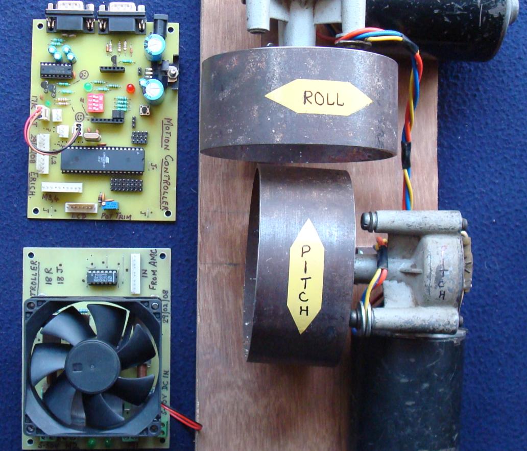

  17. tronicgr
    tronicgr
    Hi to all,
    We have two more verified AVR motion controller v1.5 users in the club! Erich and Rovor have their interfaces in fully working condition from today morning despite the difficulties they faced! :clap:
    I'll post more details about the steps it took, to help them fix their interfaces, so this information can help a dozen other A.M.C users and relief me from having to reply, all the time, to emails asking for help
    I'll give some new firmware, as well, with lower but more reliable 18.432Mhz crystal.
    Regards, Thanos

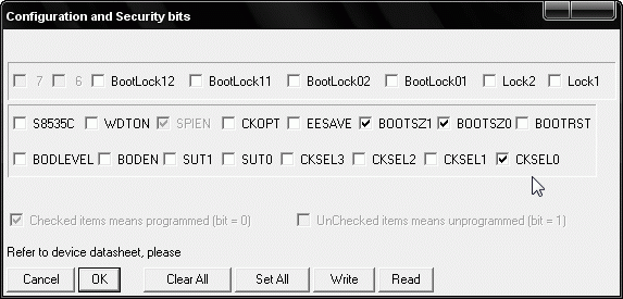

  18. tronicgr
    tronicgr
    Hi to all,
    With the help of Erich, I present you a way to fix the Device missing or unknown device -24 or the Write failed messages when using Ponyprog2000 to program my firmwares on your AVR boards:
    I think the most of the USO connection problems occured by using 24Mhz crystal. Cristian (Egoexpress) had exactly the same problem. Everything worked but no serial connection with his 24Mhz crystal! I remember that I fixed that by using the slower 22.1184MMhz crystal. The problem does not always appear. Just some atmega8535 chip batches seem too unstable above 18.432Mhz frequencies.
    But I got some emails from Erich too that he had problems getting his AVR start with a 22.1184MMhz crystal some times and he overpassed is by putting a 18.432Mhz crystal and swaping it later back to the 22.1184MMhz one. He also mentioned that he have to do some settings on his ponyprog to be able to program correctly the with slower crystals.

    Another fix you can try is to change a bit in the fuses, by putting a check mark on the CKSEL0, like in the photo below:
    This will alter the rising time of the crystal oscilator, and fix the sensitivity of RX port so it does not reset the chip in some cases.
    You really must be patience with it some times! I had faced some of these problems in the past but I was able to overcome them easily. Remember why I changed the Max232 section from the simple one to the more complicate one cause I could not receive serial data too? Sometimes a solution that works for me its of no use to others since different materials are used in first place!
    Regards, Thanos
