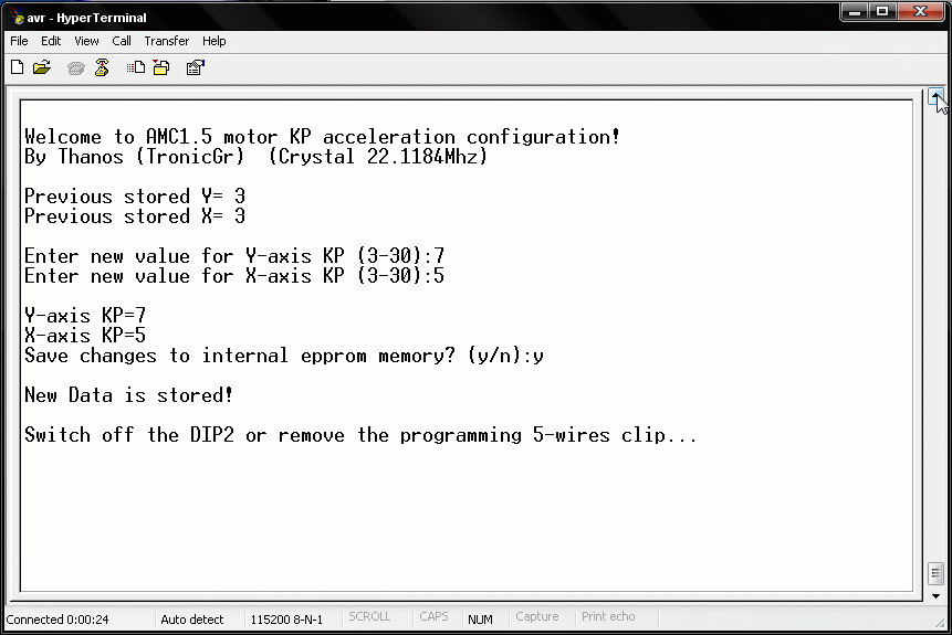

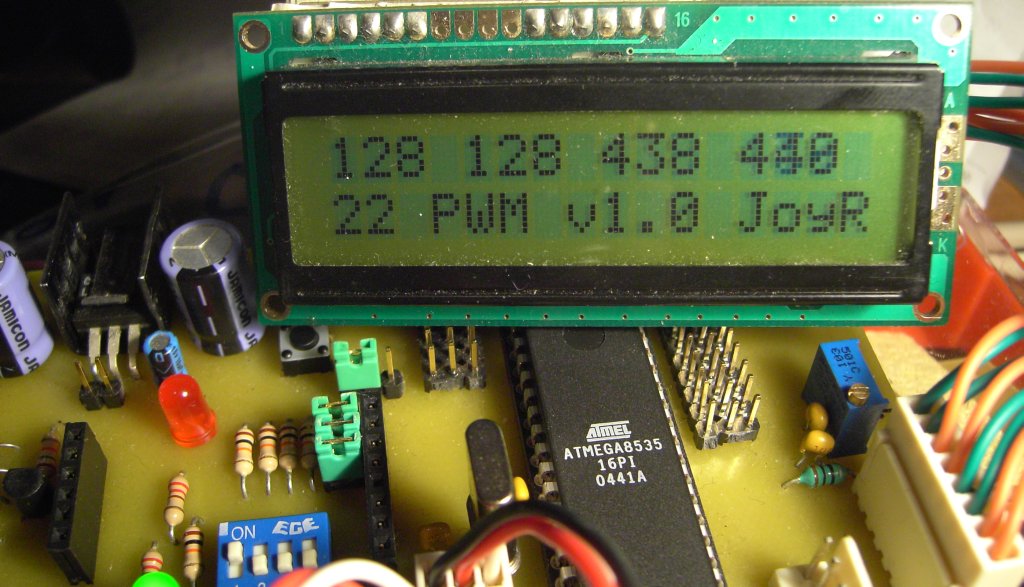

    I decided to collect all my code about AMC1.5 into one firmware that would be the first official release v1.0. It replaces all previous beta versions.
    For this reason I included the code for the two motion styles (Joyrider & SimforceGT) in it, and made it selectable between them with a jumper.
    But his isn't the only feature. I also decided to give to the users the ability to change the servo motor KP proportionality values through simple terminal connection:
    Anyway you can read all about it in the manual I made for it:
    PWM_AMC15_2DOF_v1_manual.pdf
    And of course the firmware that cames in four files, each one for the crystal speed you are using:
    PWM_AMC15_2DOF_v1 firmware.zip
    Regards, Thanos

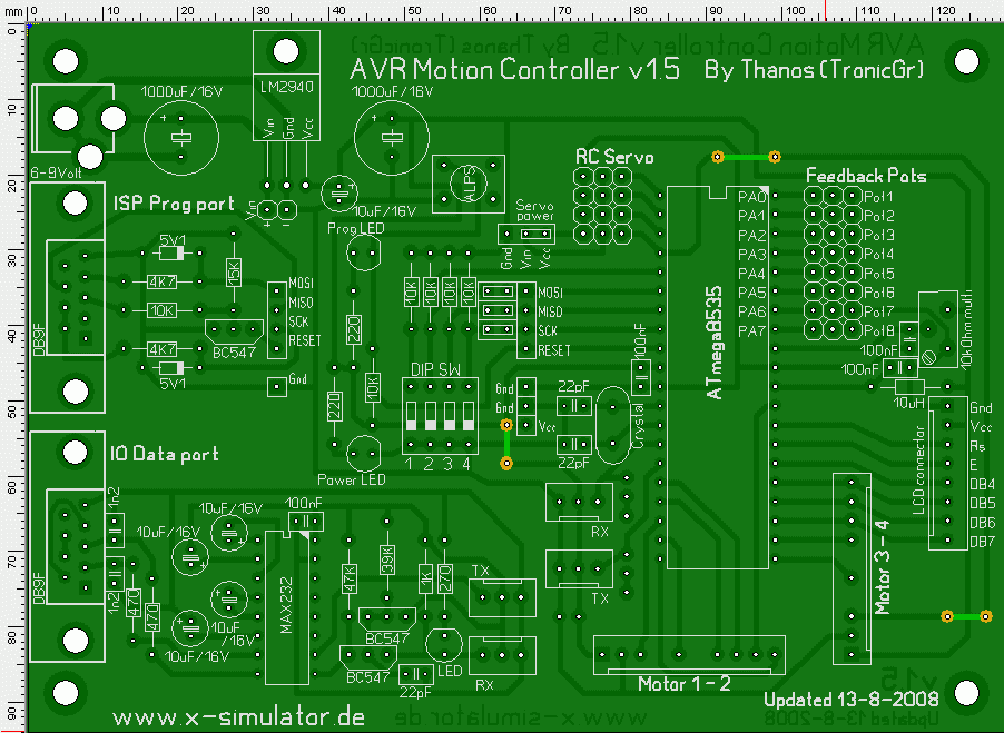

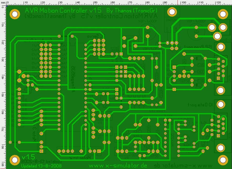

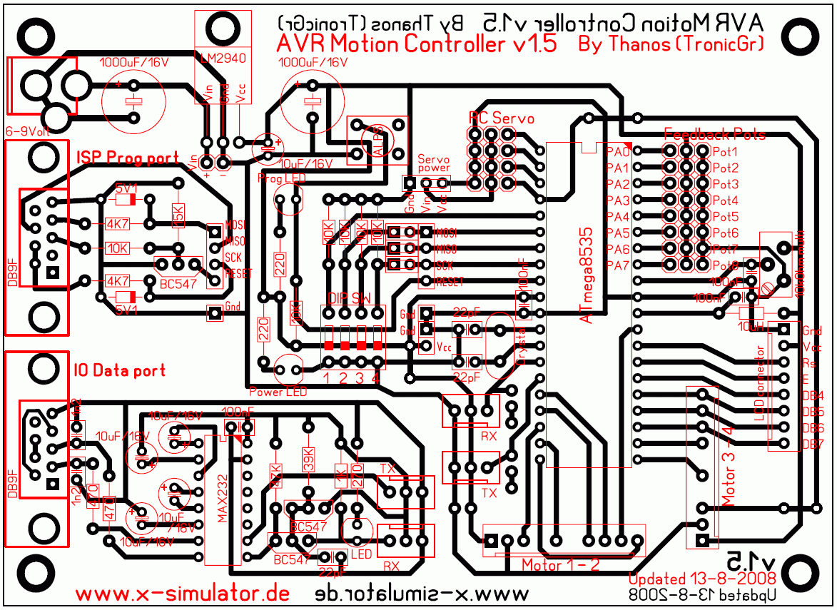

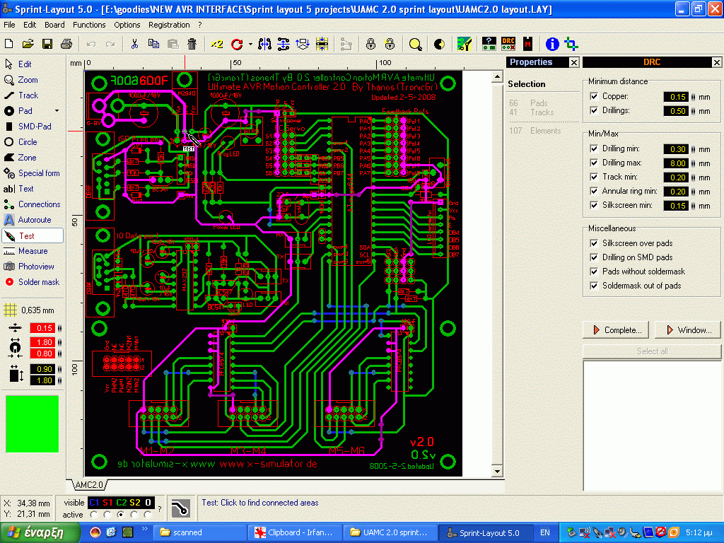

    I found a very cool layout program that was very easy to learn (record time only 2 hours!!!!!) and I converted most of my layouts to it! Its the Sprint-Layout 5!
    The best part with it is that it can export Gerber and Excellon data!! And it not the only thing it can do! It has a great autoroute function and DRC check of the layout! Look in the photo below how easy it is to test the connections on my layouts:
    Anyway I'll give you here the new improved layout of my AMC1.5. Its the same as the old one but with some more well placed line curves and gerber and excellon data!
    amc1_5_sprint_layout.pdf
    And bottom side only:
    amc1_5_bottom.pdf
    And these are the gerber and excellon data (I checked the gerber data and they are ok!). The gerber data includes Solder Mask layers for both top and bottom side of the board!
    AMC1_5_gerber_excellon.zip

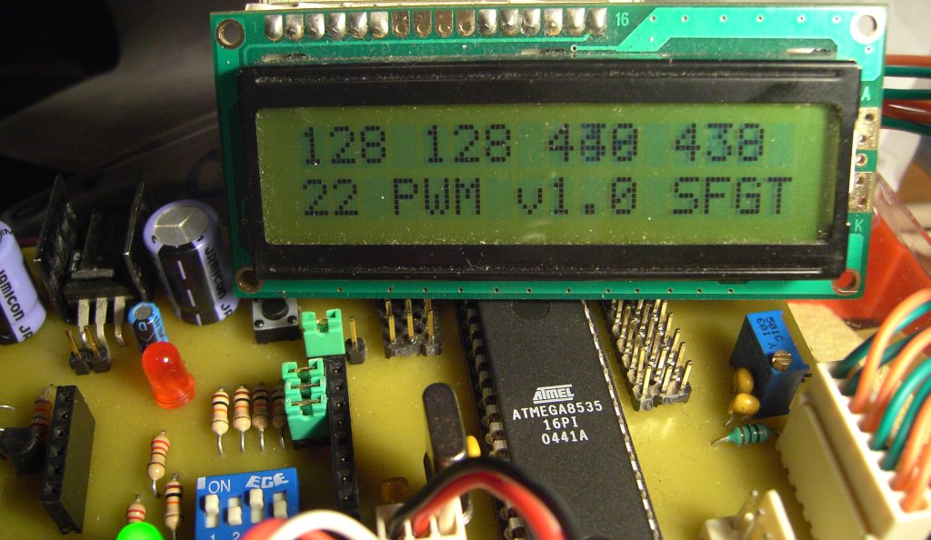

    And here are some photos of the board with the photo function of the Sprint layout5!
    Enjoy,
    Regards, Thanos
    (EDIT: FIXED the two errors in lines of the layout reported by R-eng)

    i am collecting the components to build this nice thingy.. :)
    i have found most of the components at reichelt.de with a good price. there are some things i am not able to find though.. maybe you ahve an idea:
    atmega8535 16PI (have found all models but not this one.. )
    crystals
    inductor coil
    dip switch (found it only with a different form and 5 euro.. )
    thank you very much! any place in europe is ok! the very best would be a single shop to order everything for a good price.. :D

    Yes, I know. The best shop that sell them in extreme low prices is here in Athens called FANOS !! I could not find any on-line source that can beat its prices yet! Too bad for all others, that it have no on-line ordering! And it doesn't even have website!!!! :rofl:

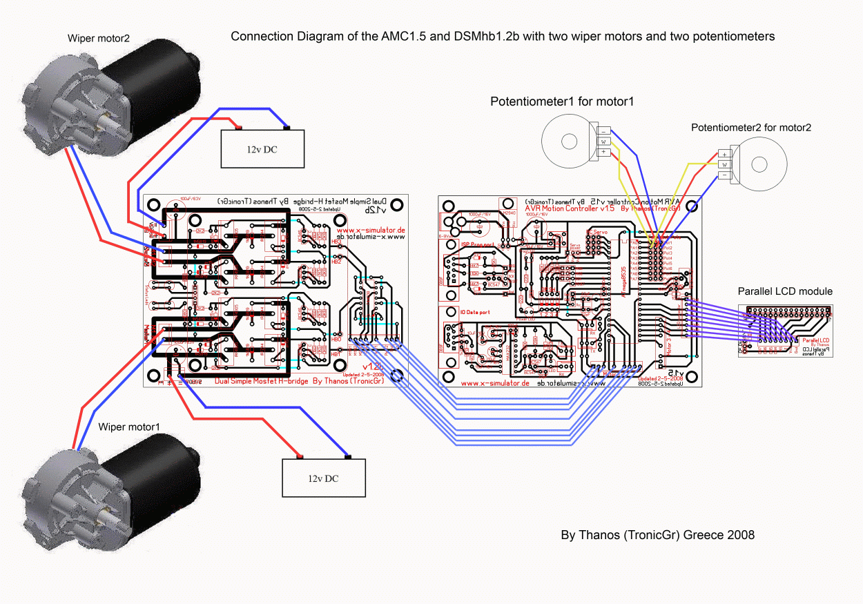

    After lots of requests for a new connection diagram for AMC1.5 - DSMhb1.2 with wiper motors, I made one:
    And here in higher resolution for printing:
    amc1_5_DSMhb1_2_wiper_motors_wiring.pdf
    Regards, Thanos

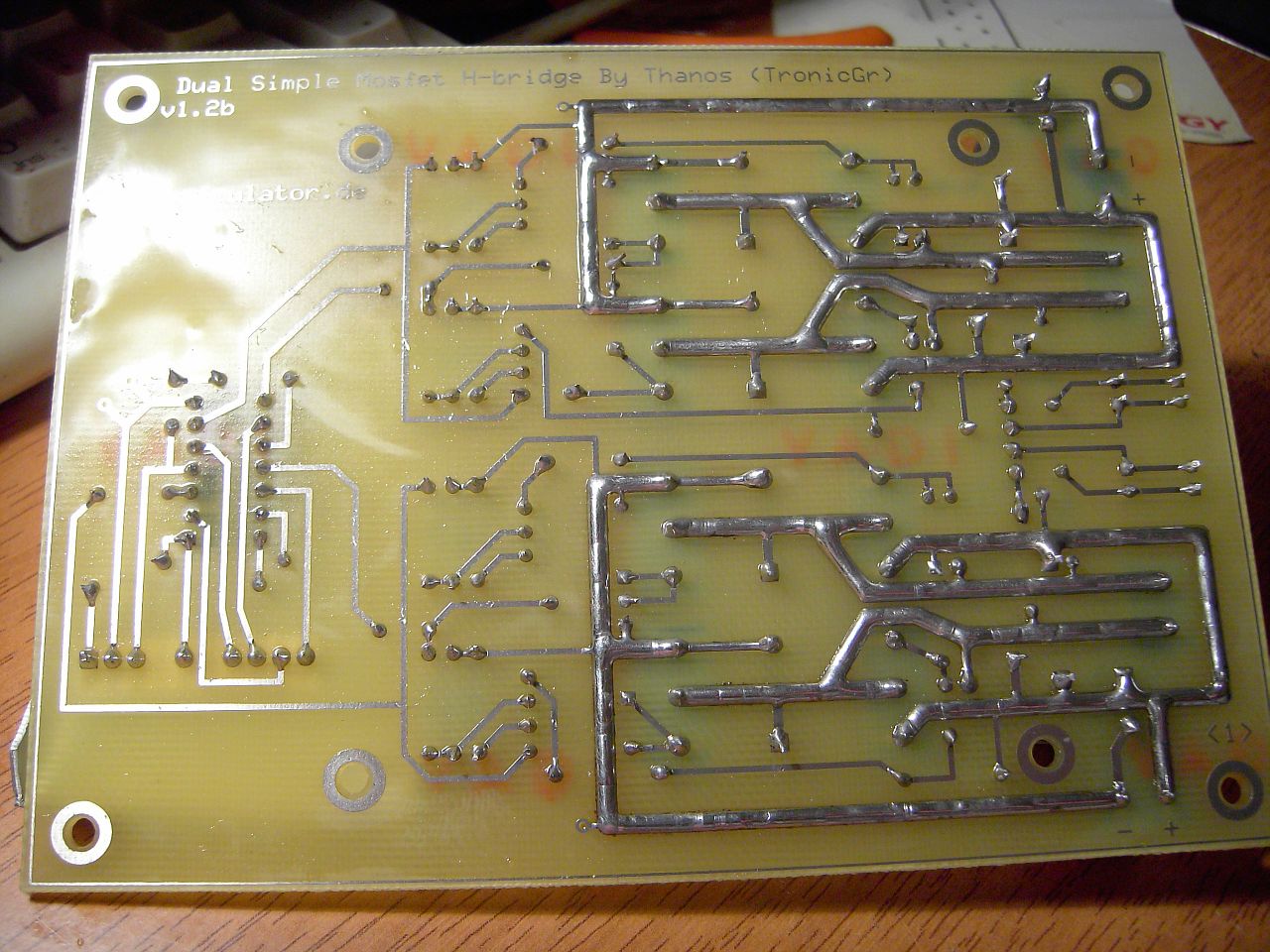

    A new one completly set, made for a fan in Poland. Please see the pictures on http://www.texma.home.pl/zzz/xmosim.htm
    The bottom was copied from .pdf to simply .bmp, then I changed the widht for the mosfet lines. A lot of work, especially with the cable connections. I think IDC connectors could be much easier to wire booth pcb's (they could be also directly connected via long pins) and the LCD. There are also many place for separate connectors for the trimmers. If I have time I try to make this projekt in protel
    Czarek
  16. tronicgr
    tronicgr
    Hi Texma,
    Its pleasant to see my creations made from other people around the world! But I disclaim any issues caused by your modifications on my design. Its easy for such things to catch fire or something especially the H-bridge part!!! I can give support only for circuits that I have built and tested myself!!! :eek:
    And some notes:
    You should re-enforce the DSMhb1.2b motor and power lines by pouring lots of solder on the tracks to be able to meet the 25 Ampere requirements of larger motors! Like on the next photo:

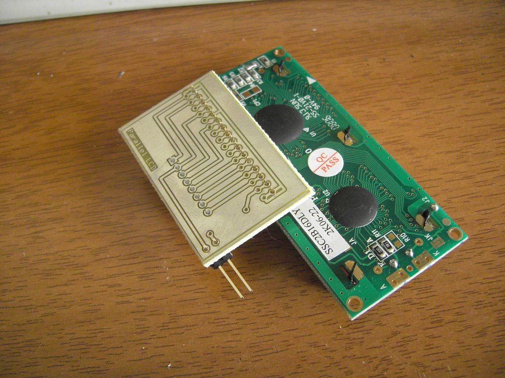

    And I noticed that you have plug the small LCD board wrong way! You have put Pin 1 of the board to Pin16 of the LCD!!!! If you power it as it is you will probably destroy the LCD!!! Here are some alternate ways of connecting the little board to the LCD:
    And more in this PDF:
    alternate_LCD_connection.pdf
    Regards, Thanos
