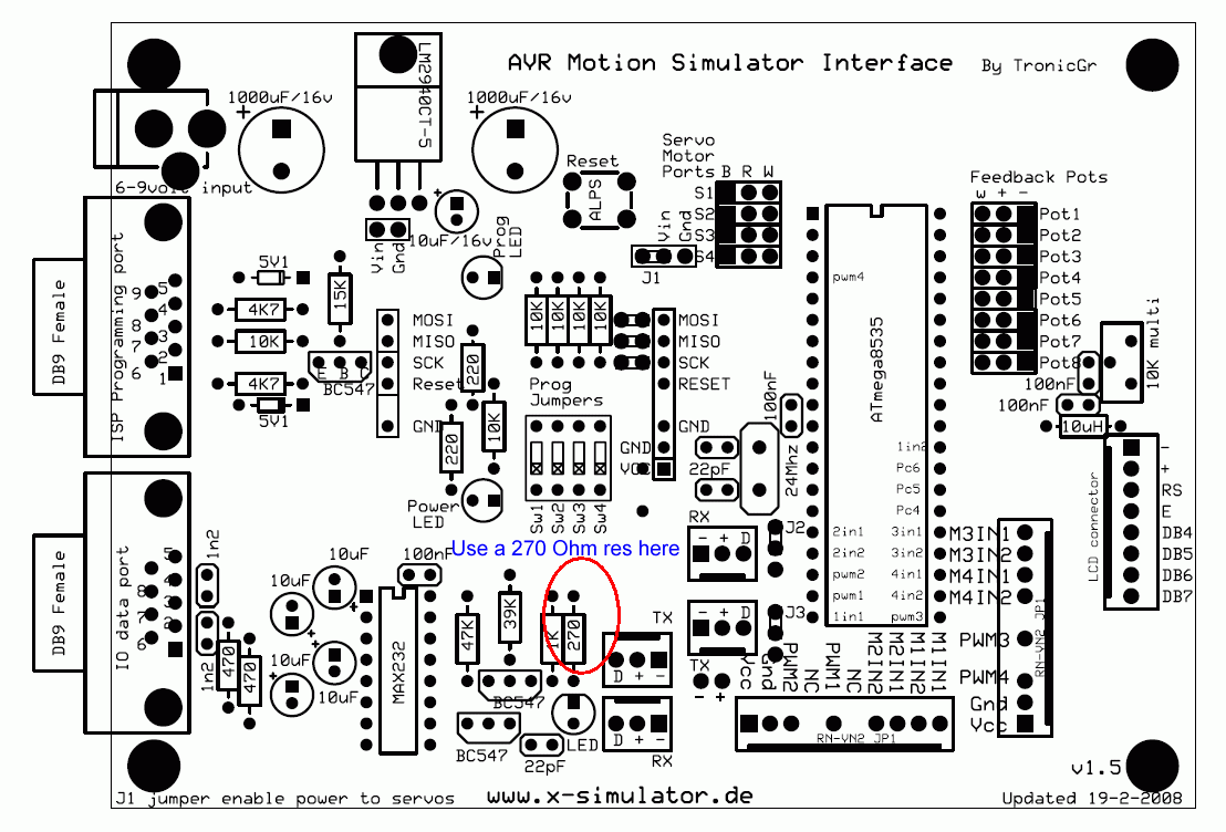

    You can find the latest version of AMC1.5 here:
    post7978.html#p7978
    And more particularly you need to use this file: amc1_5_bottom.pdf [75.31 KB]
    Regards, Thanos

  4. tronicgr
    tronicgr
    Oups, I forgot...
    Here is the latest plans for the DSMhb1.2b:
    post7981.html#p7981
    Use this file: DSMhb1_2b_sprint_bottom.pdf [61.68 KB]
    Regards, Thanos

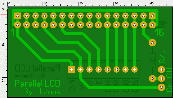

  6. tronicgr
    tronicgr
    @Jeroen
    I post here the latest layout for the parallel LCD board (made with Sprint-Layout5)
    In this PDF there are all related layers.
    Parallel_LCD_sprint.pdf
    And here is only the bottom side that you should give to an etching service to make it for you.
    Parallel_LCD_sprint_bottom.pdf
    GERBER FILES:
    Parallel_LCD_sprint_gerber_excellon.zip
    NOTICE
    All the PDF layout plans I give are meant to printed as 1:1 on printer paper (or transparent paper)
    Best Regards, Thanos
    (EDIT: FIXED the swapped RS,E labels)

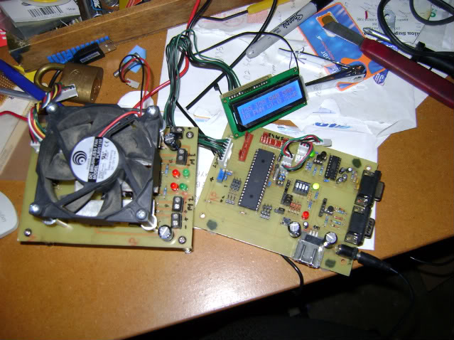

    I've just finished Tronic's AMC motor motin controller and it turned out ok for my first time.
    I'm using the 18Mhz crystal and was able to program it successfully. But I seem to be having some serial communication problem.
    First, when I use X-sim profiler to test the X,Y slider to see if the first two number on the LCD of the AMC would change respectively but nothing happens. After multiple attempts and powere on and off I was able to see those numbers change as I move the sliders in X-Sim profiler. But it wasn't consistent, it seems to be intermittant. Sometime it would work and sometime it wouldn't and sometimes only the X value would change and not the Y value and vice-versa.
    Then I try to see if I could change the Kp proportionality through hyper terminal. I followed the instruction on how to go in there and the setup changes and it doesn't seem to want to connect. What could be the problem here? Is it a bad crystal or my pcb?
    I thought I had bad serial cable, I went out and bought another one and same result. Sorry for all the questions?
    Here is a picture the AMC:

  15. tronicgr
    tronicgr
    Hi Faller,
    First of all, to be able to connect to hyperterminal mode you have to connect both RX & TX connector wires. Also be sure that the resistor right next to the LED in the MAX232 section is 270 Ohm!!! Does this Led light?
    Another thing you can try, is to avoid using ceramic capacitors next to the crystal. Use polymer (polypyrrole) type as they are more stable and accurate. I can't figure out the type you used from the photo, its small, maybe a larger photo? You can take even better detail photos with your SONY DSC-S750 ;)
    And the crystal should be 18.432 Mhz. Not just 18Mhz!!!!
    Are you using a native Serial Port on your PC or USB2Serial converter? Some USB2Serial converters dosn't work at all, and some require you to set the communication type (inside their device properties) as Serial Printer.
    What power source are you using? I see that you power the backlight of your LCD through the regulator of the AMC. I guess that the regulator (LM2940) must be burning!!! In any case try to use a 6volt 1Amp power source (or a set of four AA batteries)
    I hope that you didn't tried to power the DSMhb1.2b yet... You have placed the FAN UP-SIDE DOWN !!!! This way, it won't blow air on the mosfets!!
    Regards, Thanos

    Hi Jeroen,
    Here is the gerber data for the small parallel LCD board:
