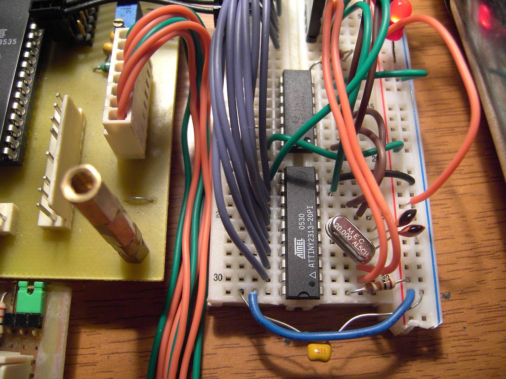

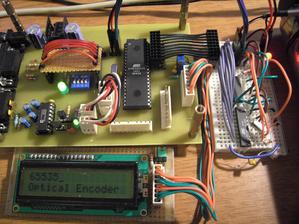

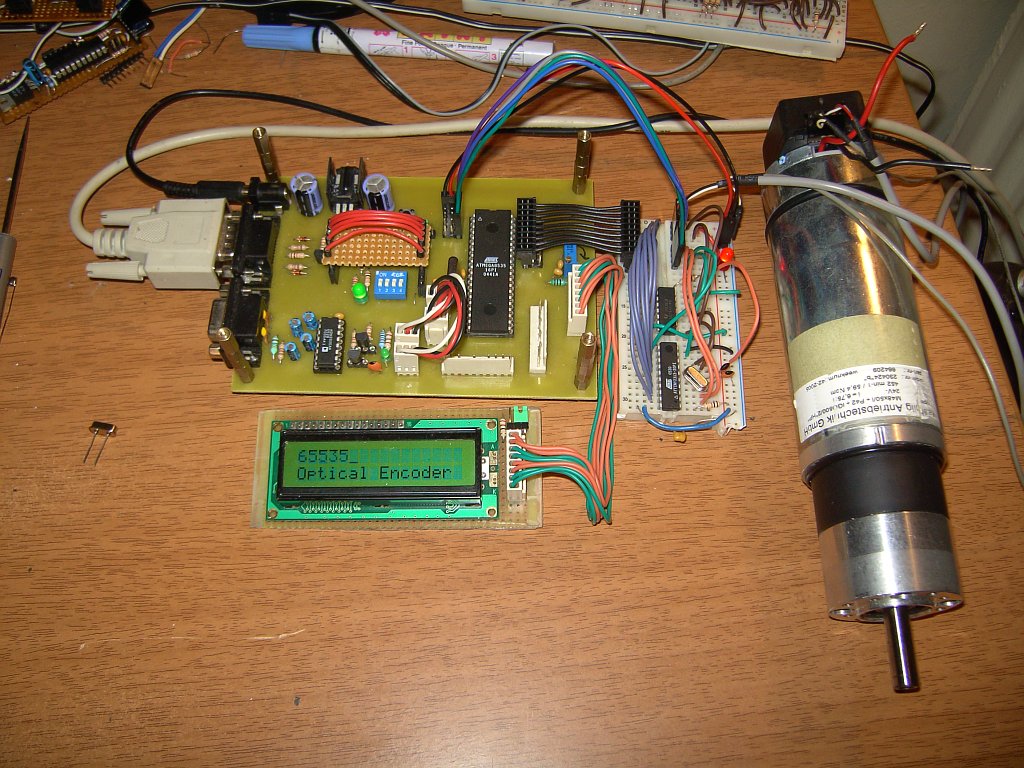

    I think that you may be pleased to hear about the progress on the development of optical encoder support for AMC1.5.
    I made custom quadrature decoder controller based on a ATtiny2313 that reads and decodes the signals from an Optical Encoder. The ATtiny2313 runs on 20Mhz crystal that means that can deliver 20MIPS processing power!!! Its output is parallel to be able to read it as fast is possible (I measured 20 uS access time for retrieving a 16bit value).
    I plan to interface it on AMC1.5 by using another ATtiny2313 that will be an I2C slave device with transfer rate of the maximum speed of 400kHz. Then with only two wires you could connect up to 8 ATtiny2313 quadrature decoder controllers in the same two I2C ports of the AMC1.5. Addressing is not an issue as each I2C slave device can have DIP switch selected address.
    As this decoder is 16bit and allows 65535 positions, I will also alter the AMC1.5 firmware to support 16bit input for the position values. As you may notice this will work only with x-sim² Profiler2, that its new USO module can send 16bit values (the old profiler1.8 can send only 8bit values)
    Anyway for the development I used an HEDS 9100 (500 cpr) quadrature optical encoder that is attached on a FESTO DC servo motor that Monast send me recently, to help me with project. As the motor has planetary gear ratio of 1/13.73 , I read 6865 positions per full revolution of the output axis. The datasheet of the motor which I took apart is this one: http://www.festo.com/INetDomino/files_0 ... PSI-US.PDF
    Now comes the fun part: The motor itself has 6096 RPM speed and since the optical encoder disk is 500 cpr I have to read 3048000 positions per minute or 50800 positions per second if the motor runs in full speed!!!!!! Guess what! I tried it and it works!!! The ATtiny2313 quadrature encoder controller doesn't miss a pulse!!!!!
    These are some photos of the breadboarded ATtiny2313 decoder circuit, interfaced directly (in parallel mode) to the AMC. As you can see it took all the eight ADC ports and all the four RC servo ports to interface it, that is impractically for only one quadrature decoder, that's why I will interface it thru I2C in the final.
    http://www.youtube.com/watch?v=8qmNt4erRXc
    For better resolution of the video click below and choose Watch in high quality
    Best Regards, Thanos :cheers:
