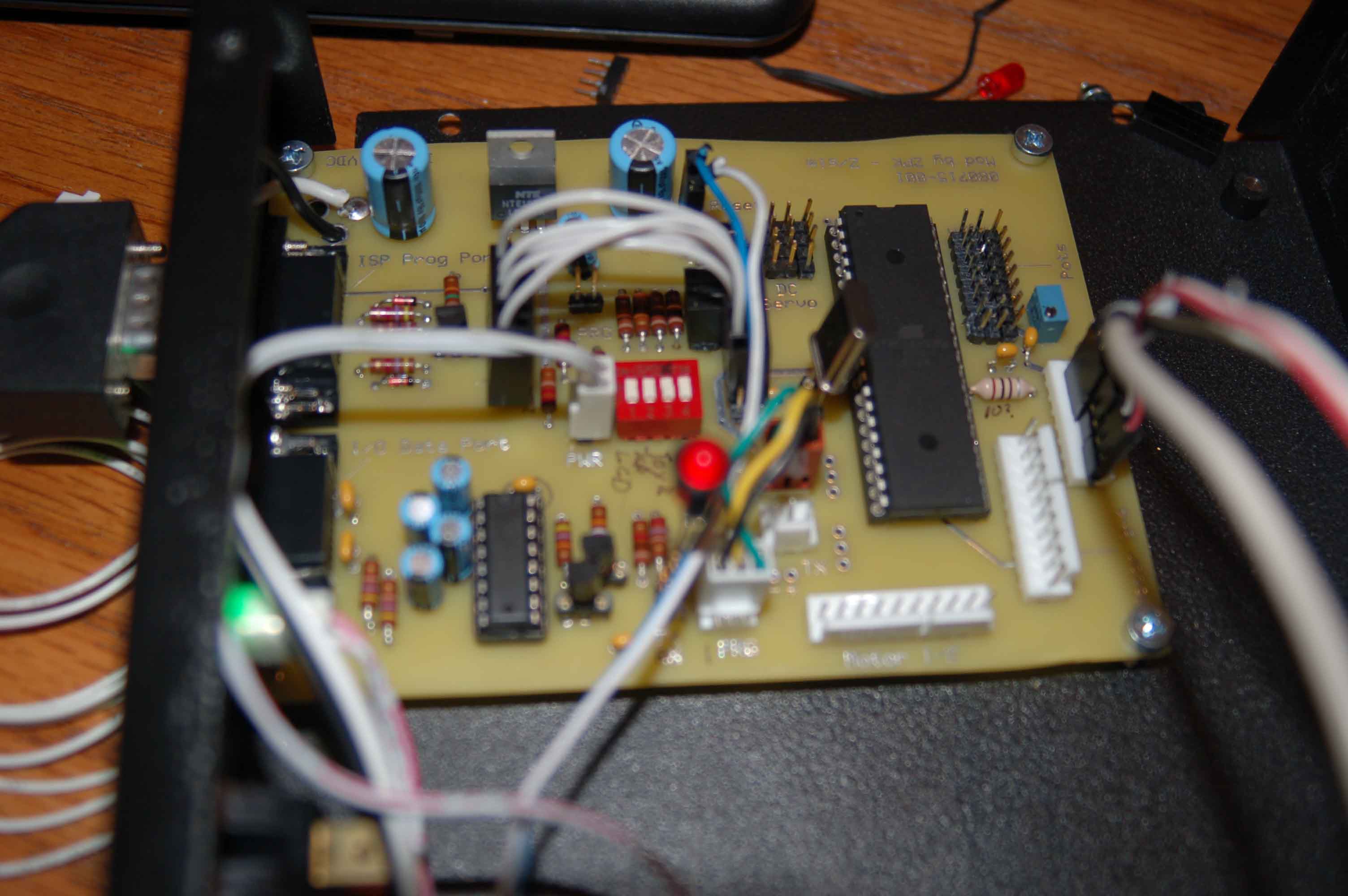

    If I am correct...? The + is the long wire of the capacitator. No the adaptor can not be switched.
    Gr. Jeroen
  2. egoexpress
    egoexpress Active Member
    Dec 13, 2006
    3,839
    Germany - Frankfurt/M
    421Coins
    +10 / 1 / -0
    PSU polarity switched...
  3. Michael N.
    Michael N. Member
    Dec 27, 2007
    274
    Germany, NRW, Düren
    611Coins
    On my 9V PSU you can change the polarity. For example, i can select the (+) in the middle or in the outside of the connector
    Yes
  4. Jeroen
    Jeroen DoctorXeno
    Oct 3, 2007
    121
    Holland
    - 49Coins
    What does that mean? Is it a minor problem that can be solved easily?
  5. egoexpress
    Dec 13, 2006
    3,839
    421Coins
    +10 / 1 / -0
    You should take a voltage-meter and check the polarity of your power supply connection. Capacitors explode due to wrong polarity, or if they are very old and dry. But I guess yours have been in new condition before placing them. And recheck your pcb by holding it in front of a strong light source (like the doctors when they watch x-ray pictures :D). You may have soldered a shortcut somewhere.
    Regards
    Christian
  6. Jeroen
    Jeroen DoctorXeno
    Oct 3, 2007
    121
    Holland
    - 49Coins
    Yes I have checked the powersupply and the + is the outside of the jack. Too bad I didn't check that...
    Do I only have to replace the capacitor that blew? Or might other components be damaged too?
    And must I buy another powersupply? Or can this be resolved in another way?
    gr. Jeroen
  7. Michael N.
    Michael N. Member
    Dec 27, 2007
    274
    Germany, NRW, Düren
    611Coins
    You must swap the cables on the connector from your PSU.

    Problem solved... I did not check that :?
    Thanks for the info.
    So, by replacing the capacitator and switching the polarity the problem must be solved?
    gr. Jeroen

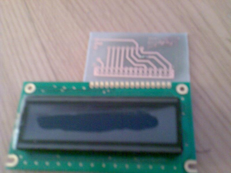

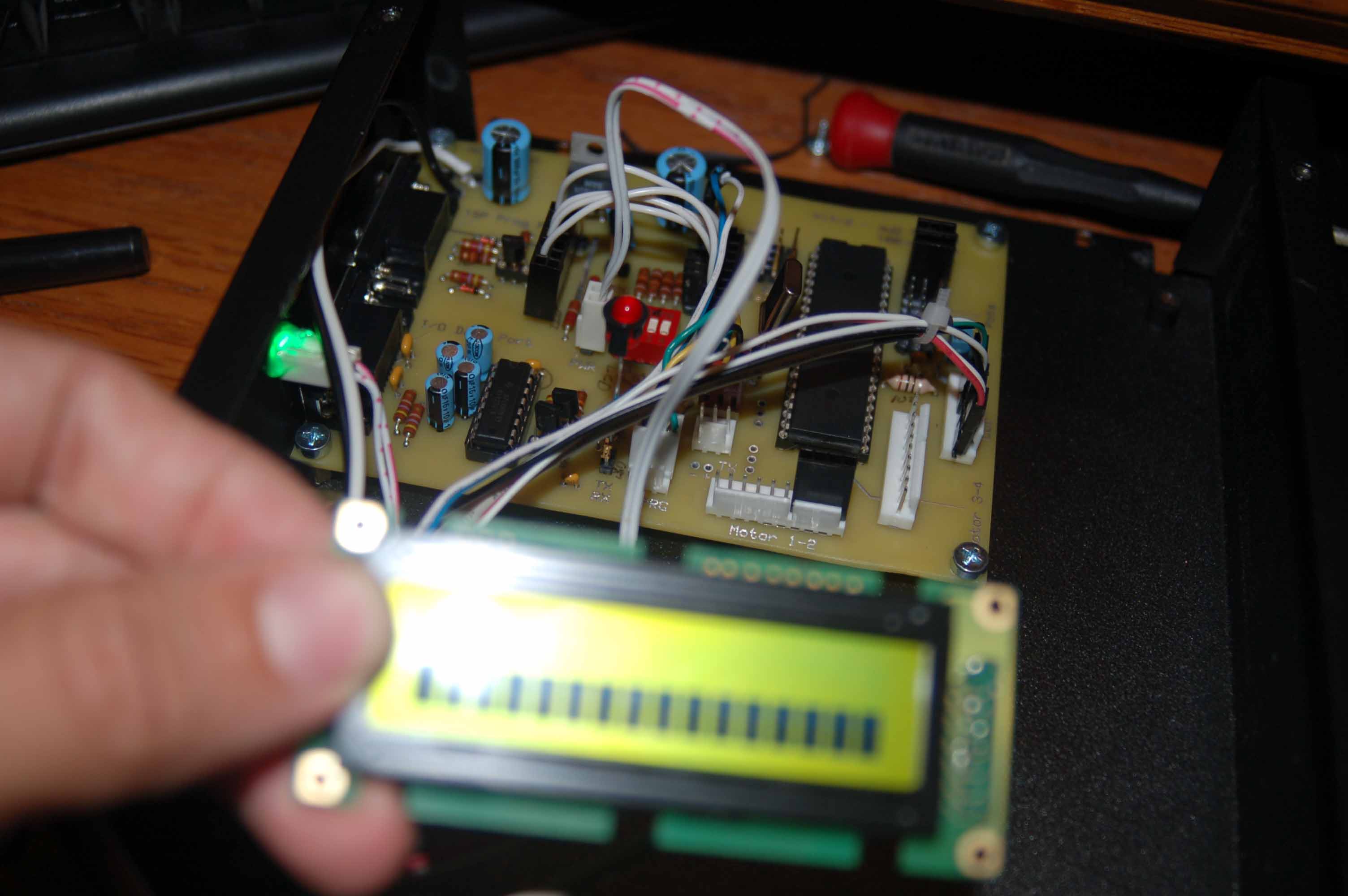

    How do I connect the LCD-pcb to the LCD? Like this...
    Or like this...
    gr. Jeroen
  11. tronicgr
    tronicgr
    Hi Jeroen
    The PCB has written on it which is PIN1 and PIN16. So you must align it with yours LCD pins accordingly. If you LCD doesn't have them printed on its pins, seek for the datasheet before connecting to avoid burning anything...
    Also be sure that the Pin15 & Pin16 ARE used for backlight power input. There where some cases that the pinout was different. Take a search in this thread for more examples...
    Regards, Thanos

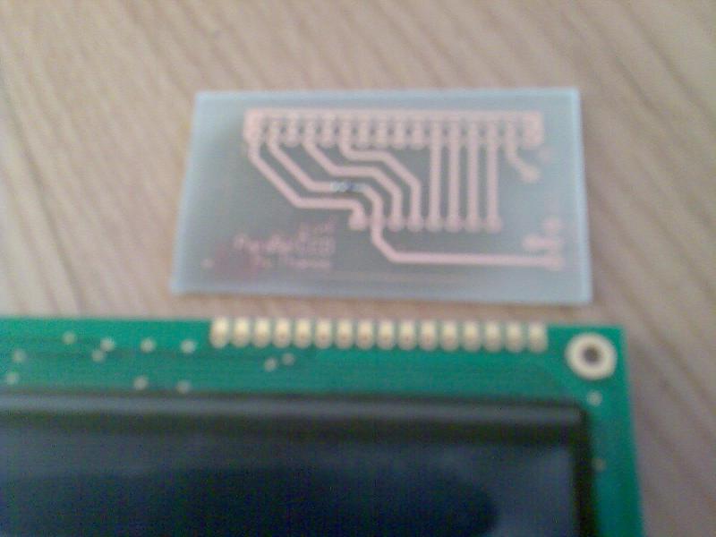

  12. Jeroen
    Jeroen DoctorXeno
    Oct 3, 2007
    121
    Holland
    - 49Coins
    The pins are like this 15 16 1 2 3 4 5 6 7 8 9 10 11 12 13 14 on the lcd.
    So if I connect pin 15 on the 1 of the pcb and 14 on 16 it must be the right way?
    gr. Jeroen
  13. tronicgr
    tronicgr
    Hi Jeroen
    Take a look on this post that seems to be the answer to your problem:
    <a class=postlink-local href=http://www.x-simulator.de/forum/post9045.html#p9045 onclick=window.open(this.href);
    return false;>post9045.html#p9045</a>
    Thanos

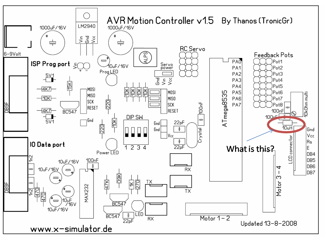

  15. adochoa
    adochoa New Member
    Jan 28, 2009
    22
    1Coins
    Thank you all for all this great work! I've come a long way learning slowly from all of you! Especially thanks to Thanos!
    I'm building my AVR controller and I must ask dumb questions as I have very little electrical experience. Can someone tell me what the below component is and where I might get it? In pictures it looks like a resistor, but I thought it might be an inductor?
  16. Mambo
    Mambo New Member
    Aug 5, 2008
    168
    Czech Republic
    288Coins
    Yes its inductor

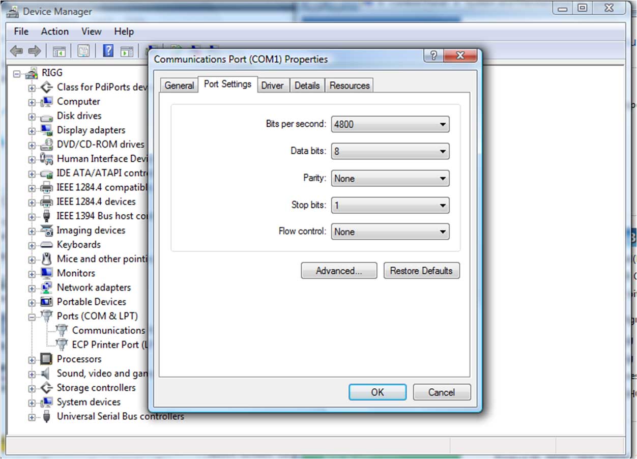

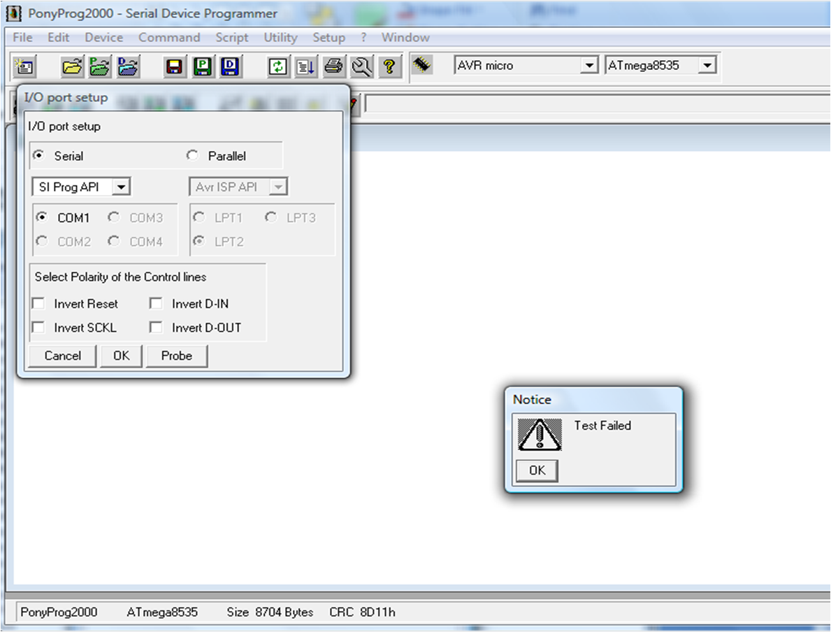

  19. adochoa
    adochoa New Member
    Jan 28, 2009
    22
    1Coins
    I am having the same problem as Wannabe...
    Unfortunately I have tried multiple computers and this does not fix it. They are all windows Vista though - has anyone used vista succesfully with ponyprog?
    What should my COM settings be? I have them default now.
    I have selected the Atmega from device menu.
    I'm trying to attach pictures but seems to be an error. I will try again later.
    Off for a holiday weekend, but this will be bothering me! please help guys!
    Thanks,
    DAve
  20. adochoa
    adochoa New Member
    Jan 28, 2009
    22
    1Coins
    some pics..
