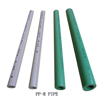

    Hello everybody i want ask you if in the plans for joyrider.? are some special changes in our joyrider with motors? yesterday i began built the cockpit but i saw the pipes on the tronics simulator. so i suggest to give the metal tubes into the plastic tubes.. to be more storng ..i want ask anybody if there are some big propblems on some par of this construction? can anybody help me with this?or say what is more important on the building?Thank you very much.. Mila from Czech.....

    Hi lotada
    I used these metal pipes to reinforce the smaller PVC pipes of the inner cockpit, since their size was too small to hold all the extra weight of the bucket seat and the LCD without bending a lot. You will not need those if you use the larger size PVC pipes I mention on my site. If you still want to use such steel pipes inside the PVC pipes, keep in mind that it will be hard to drill them and bolt them in such manner.
    Other than that, you can follow Oscar's excellent guide on building his modified joyrider here:
    http://www.x-simulator.de/forum/step-by-step-approaching-to-thanos-work-t1218.html
    Regards, Thanos

  20. lotada
    lotada New Member
    Jul 31, 2008
    41
    coffe Roaster
    Kralupy nad Vltavou
    248Coins
