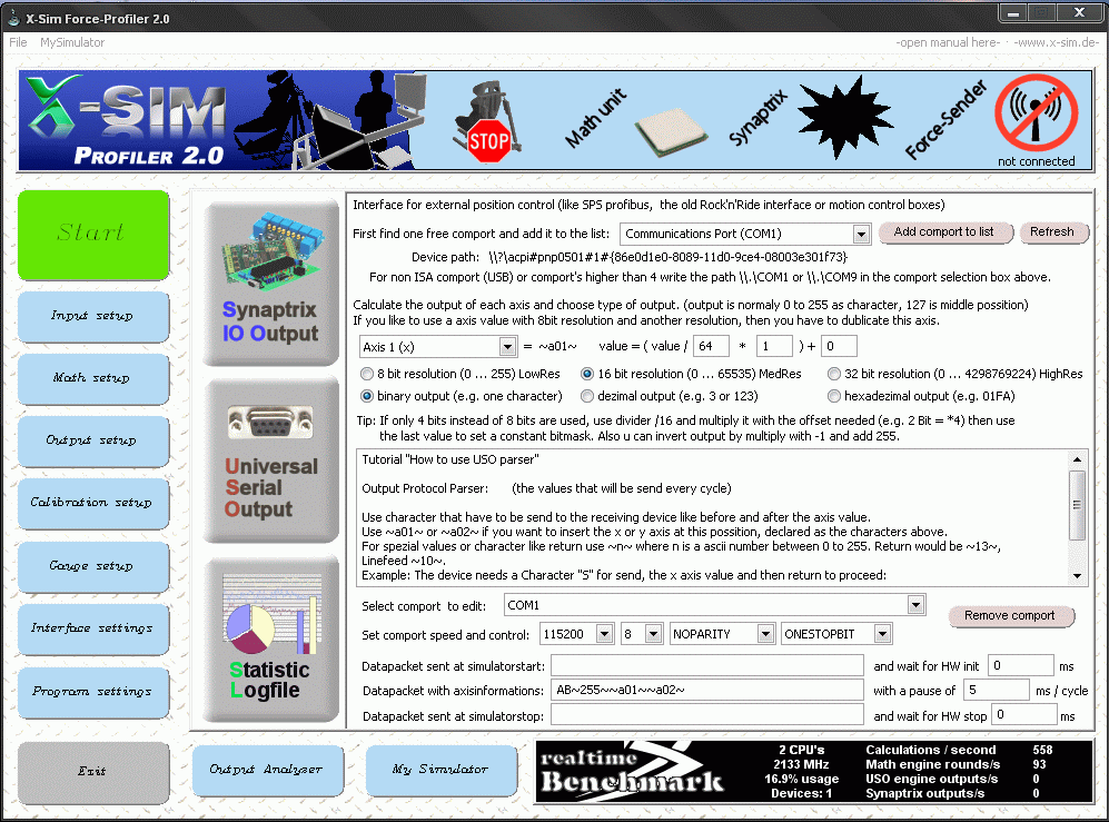

    the string AB~255~~y~~x~ is valid with the pololu too?
    Is there any way to test the profiler without the sender? Sometimes i have dead times at my work and i don't have a joystick there...
    Regards and thankyou, like always.

    Yes, it is the same. This string transmitts only position data, and has nothing in common with the type or model of h-bridge.

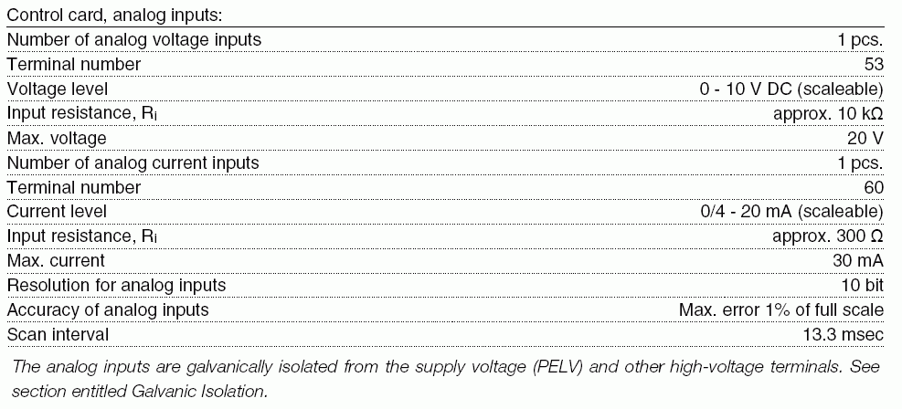

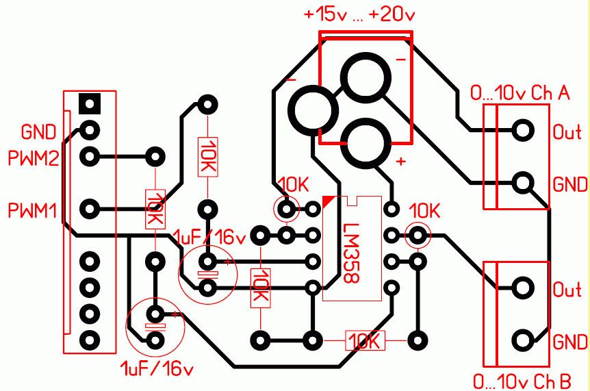

    Hi everybody.
    I have finally figured out a simple way to convert the PWM signals of AMC1.5 to proper voltages that can be used as input for heavy duty industrial actuator drivers.
    The present circuit will attach directly to the existing motors connector and will use only the two PWM signals and the ground. Since it will output 0 to +10V, it will need an external power source that can be between +15V and +20V.
    PWM_to_10v_analog.pdf
    PWM_to_10v_analog_layout.pdf
    A special firmware was written for driving this little circuit. The motion is proportional and still uses the potentiometer feedback for position control. It uses true 10-bit PWM signal and the input for each axis is true 10-bit. That means that will work only in x-sim2 profiler2.0 USO with each axis declared as 16-bit and divided by 64.
    I will not share the firmware just yet, not until I have some good news from Monast testing it on his Proportional Directional Control valves for a pneumatic setup he is making. Here is the datasheet of his proportional valves:
    PDF_EN_MPYE_EN.pdf
    So, if there is someone else out there that has access to some heavy industrial Variable Frequency drives (VFD) for AC motors, post here the datasheet to see if we can use it there too. One requirement with current circuit is that the driver should take input in such way that the 0V would full speed to one direction, 5V stop position, and 10V full speed to the other direction.
    But I might do a revision later for -11V , 0 , +11V input VF drives.
    Any comment is welcome!
    Best Regards, Thanos

  9. tronicgr
    tronicgr
    Hi Briut,

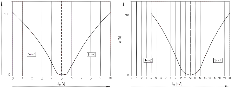

    I suppose that your VLT 2800 can take as input 0-10V too. In that case you can use the circuit I made without modification. But I'm not sure if it can output in the range of 4-20mA yet, I have to make some tests first.
    Can you describe me what effect in motor direction has the following voltages / mA values to your VLT 2800?
    A. 0V / 4mA
    B. 5V / 12mA
    C. 10V / 20mA
    This is important, as most of the manuals don't describe if you can reverse the motor with just the analog input or its just used as speed control level!!!
  10. tronicgr
    tronicgr
    Hi Briut
    I looked again the VCL2800 datasheet and it seems you can connect the above circuit (0v-10V output) that I gave, by connecting it to terminal 53.
    But if you still need to use the current loop input method you can use the next circuit (schematic):
    PWM_to_4_20mA_analog.pdf
    Its tested and the current output 4-20mA is ok !! (I'll do PCB circuit later)
    @all
    I have good news from Monast. The 0-10V circuit and the modified AMC firmware I gave him, work fine!!!!! He will use his proportional control valves on a motion system the next days so I guess I'll publish by then the modified AMC firmware for analog output. The really nice thing is that now we have a way to interface to large industrial AC motors and their Variable Frequency drives without need for specific bus protocol etc. Virtually all VFD drives with analog input will work with this simple interface!

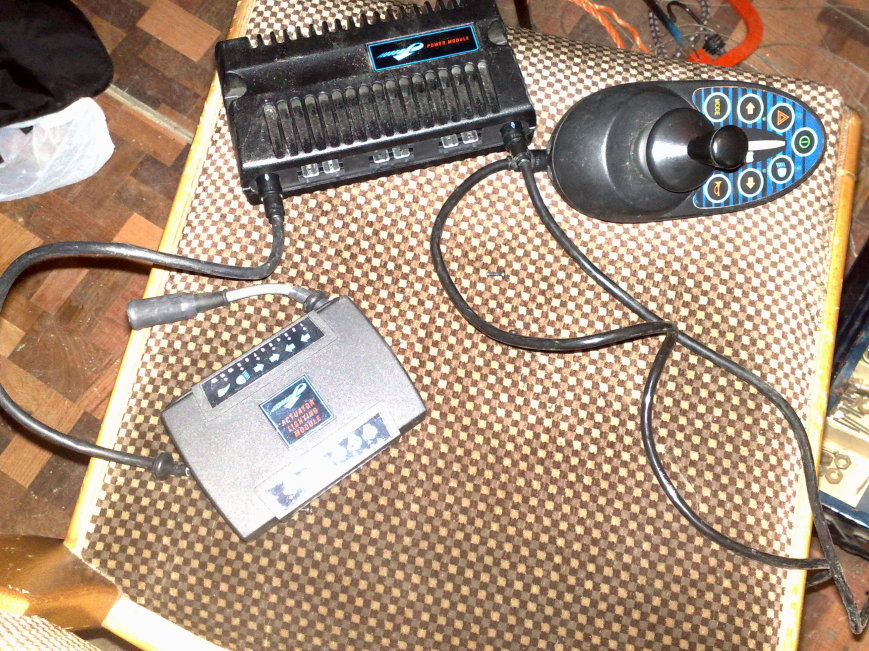

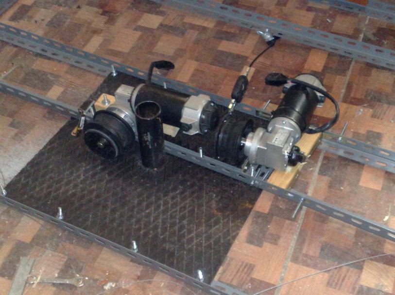

    Tronic Hi! My name Denis.I finished my simulator, I need your help, you will be truly grateful. Unfortunately they are not good with electronics and can not build a (better) just like yours. As you can see from the photos, the engines are at 24 volts, are engines of old wheelchairs that throw in a landfill. I have recovered and tested and work perfectly.I have ordered the K8055 of Velleman, when I asked at the forum told me that a relay card or H-bridge as your. I do not know what to buy, you can help me? I have two units (see photo) for the on-off of the engines controlled by a joystick (photo) where I can set the speed. Can I use one of these connected to the k8055 for controlling my motor. If it were possible, how they should be connected? With much gratitude, Denis.

    Hi Denis,
    May I ask you a few questions?
    1. The joystick is ANALOG? I mean if you get variable speed on the motors or just on-off??
    2. The Motor Controller I see in the photo is the one that was used on that wheelchair that the motors came off??
    3. Can you measure what voltage signal (from joystick) your wheelchair motor controller needs to activate either motor?
    I was thinking that you could use the PWM signals from my AMC1.5 controller (converted to analog voltage) to set the speed of each motor and use simple potentiometers fixed on your motors as position feedback! This way you may not need to also construct a h-bridge (DSMhb-1.2)
    I don't think you can use K8055 although is has analog voltage output. It lacks position feedback!!!
    Regards, Thanos

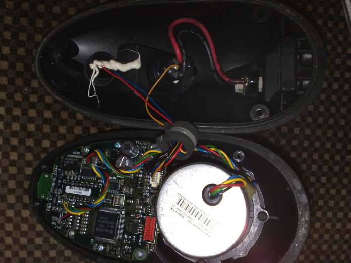

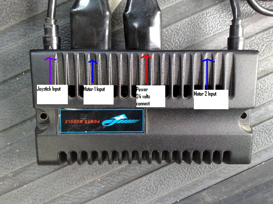

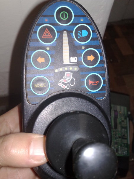

    Hi Tronic and thanks for the quick and precise response! The Joystick (photo) can modulate the speed of the engine by pressing the MODE button and setting the speed, but that before then operate the lever then the speed will be constant and on-off. The motor controller was dismantled by the same wheelchair and is of the same manufacturer. As you see in the photos I've also added a unit to control actuators or motors other than the two main engines. This unit is still manageable by the joystick. In internet I found this article to interface the joystick to the PC. If you read it you definitely understand more than me. However reading I saw that the ability to handle the commands from PC's. One last question: I have to throw the VM110? I bought for nothing? I also have 2 elettrics actuators 24 volts, may work with VM110. I want to make as simple as possible since they are not very good as you. Thanks for your attention. With admiration. Denis
    Circuit interface between a PC and a wheelchair The joystick is equipped with the wheelchair sends
    information on a digital data bus to a control unit for
    command of the engines. The electrical specifications and the protocol
    communication of the data bus (called DX BUS) not
    are known and the manufacturer of the control system
    wheelchair (Dynamic Control) is not made available to
    provide for research purposes. The only possibility of
    interface directly to this channel of communication
    with the control system of the engines was to make
    a reverse engineering specifications and the protocol.
    Another possible solution consists in replacing
    the control system of the engine with a stage
    power developed ad hoc and controlled by an interface
    communication standard. Whereas these solutions
    complex to implement and risky for the reliability of
    system, it was decided to use another
    approach to take control of the wheelchair and in particular to interact indirectly with the data bus
    of the control system of a wheelchair. In particular, analyzing the circuits inside the joystick
    the wheelchair, it was noted that it was possible to separate the system in order to isolate the gear from the joystick
    rest of the board. Analyzing only the handle and the electrical signals present on it was discovered
    which they were made up of tensions continue directly proportional to the position taken by the leverage
    two forward-backward and right-left. The presence of a connector that connects the signals from
    joystick lever to the rest of the circuit is an access point to interface with the control system
    the wheelchair. It is therefore thought to make a board that will replace the joystick lever
    simulating tensions continue to be produced and that it was controlled by a computer through the door
    Serial RS-232. In order not to squeeze the lever joystick control of the wheelchair was chosen to
    develop a portion of the circuit tasked to interpret the signals produced by the tension lever
    joystick and communicate to the computer, again via the RS-232, the position of the lever itself. The software
    control may use the information received from the circuit to see the position of the lever and
    Illustration 2: Inside the Joystick of wheelchair
    highlighted in red on the lever connector
    Illustration 1: The wheelchair Otto Bock Rabbit
    therefore given by the command and control the wheelchair based on other information in its
    possession (eg, presence of obstacles, commands from other devices, etc..).
