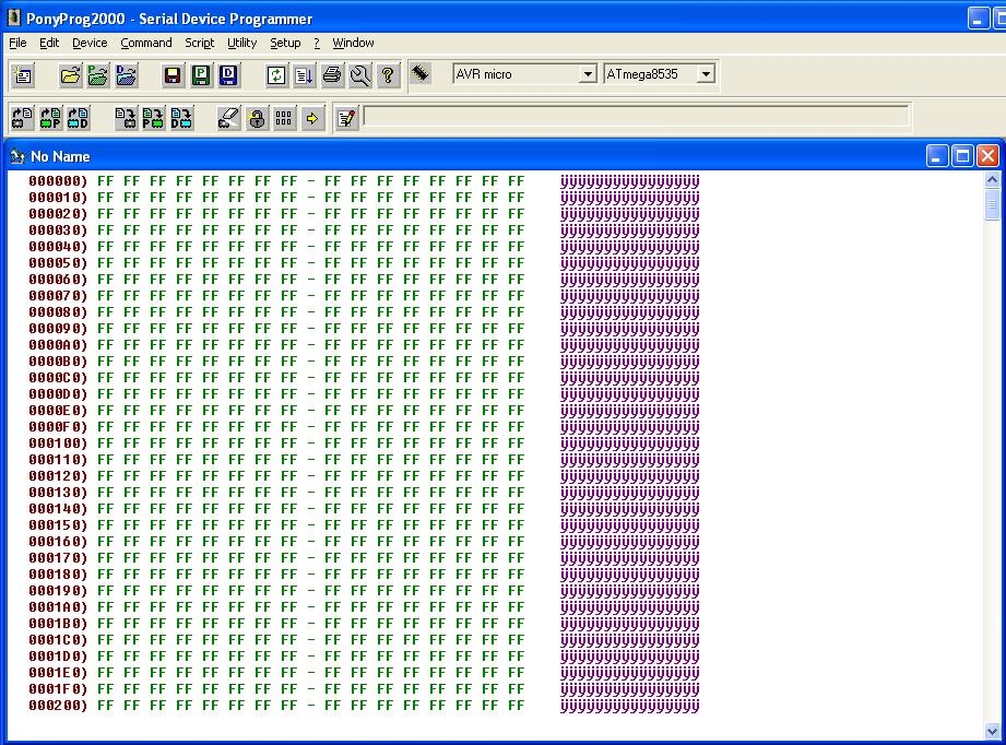

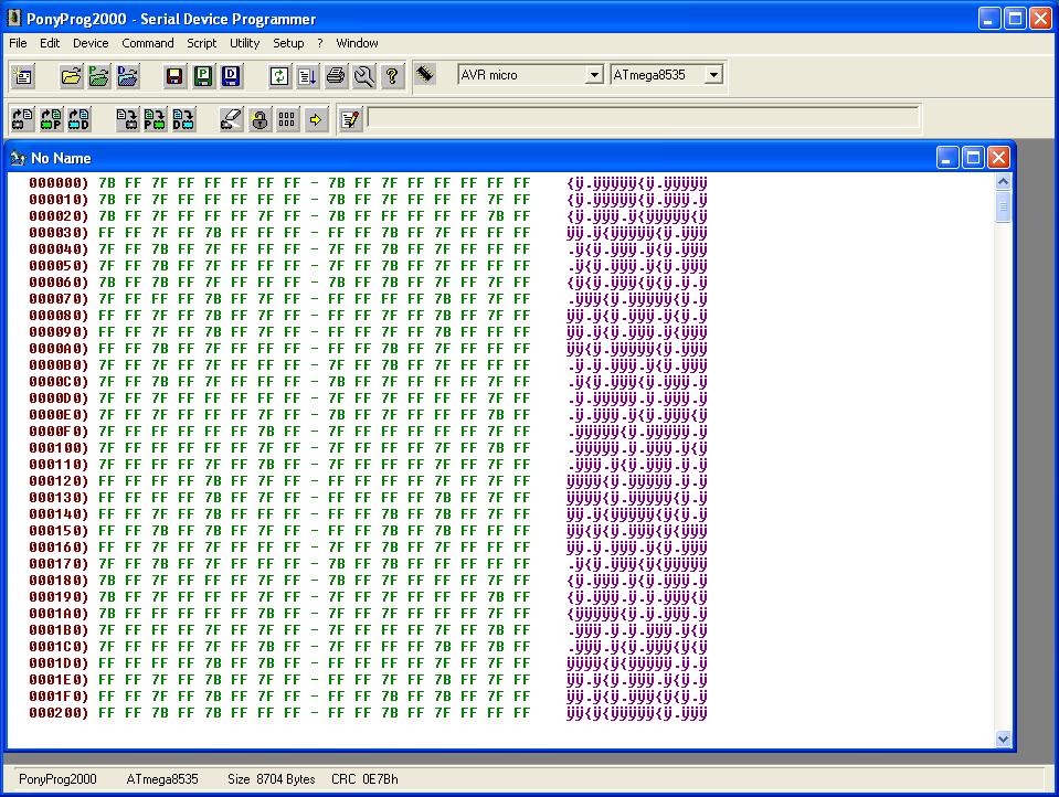

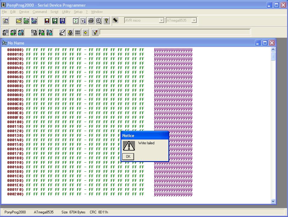

    In the first try I write succesfuly the program beta002_lcd_op.hex :clap: . After that, I fix the LCD back light problem. I connect the lcd pin3 to ground via 5k ohm resistor and it was usable :thbup: . After the lcd problem ( 2 day after) I want write v1.0 firmware for making some tests with mini rc-servos. when I Program the atmega its writes write failed I try with different oscilators, but result was same. and I fill the memory with FF (see on pic 01) write the flash again and same error (see pic 02) And I read the writed data on the flash, but there is something wrong (se pic 03).
    1- is this a communication parameters error or serial cable is not good ? and how can I fix?
    2- Atmega 8535 is heating aprox 55C degree, is it normal? I can feel the hot when I touch the atmega.
    3- when I work with beta_002_lcd firmware screen like 128 128 950 950 but 950 value can change 800 to 1100. is it normal?
    4- in the beta firmware I cannot control the rc-servos, which firmware can suitable for 3-4 axis servos?
    5- Sometimes atmega is crashing and I cannot connect to profiler again, After power off and then on is solve the problem. anybody living this problem?
    Regards
    Suleyman

  4. suleyman_trk
    suleyman_trk New Member
    Jul 1, 2009
    0Coins
    Hello Again;
    Still I can't solve the problem, anybody can help me?!.....
    Regards
    Suleyman

  7. tronicgr
    tronicgr
    This is the correct cable to use:
    DB9 FEMALE to DB9 FEMALE:
    Pin 1 ...........................Pin 1
    Pin 2 ...........................Pin 2
    Pin 3 ...........................Pin 3
    Pin 4 ...........................Pin 4
    Pin 5 ...........................Pin 5
    Pin 6 ...........................Pin 6
    Pin 7 ...........................Pin 7
    Pin 8 ...........................Pin 8
    Pin 9 ...........................Pin 9
    Also search for the ponyprog fix suggestions by Eric in this thread.
    If all else fail you can use a STK500 USB programmer (20-25euro from Ebay) and program the firmware with AVR Studio4 (from Atmel).
    Regards, Thanos
