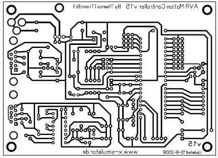

    @ all,
    I`m finally ready to start building AMC and DSMhb!
    I`ve read all post about Thanos`s great work, and off course all posts explaining various issues that other simmers encountered. I fully understand this concept and I`m getting into building both PCBs.
    I will use two standard WW motors and customize my existing sim chair into SimforceGT like motion simulator.
    For ones interested, you can look my rig built not long ago. Page is written in Serbian, but pictures tell more than words :)
    http://sites.google.com/site/igorfermevc/
    I`m planning to use Thanos`s DSMhb, cause I can`t acquire no commercial motor driver. I want to use design with connectors for MOSFETs, cause I think it`s better for maintenance.
    I need to ask just one thing and hope that many of you can answer,
    please point me to the right pdf for PCB layout for AMC and DSMhb, there were so many upgrades so I`m not sure if OP contains latest info. Another thing is final part list and which micro-controller to use. Links to relevant files or posts are enough.
    Thanks in advance and BR, Igor

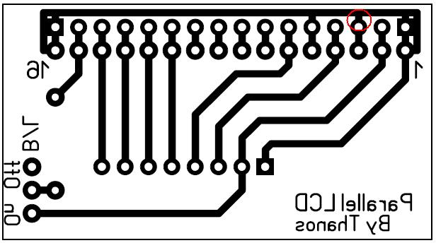

    A second question: what is the use of the jumpers with the white circles on this picture(what happens if I dont put them ?):
    Thanks again.

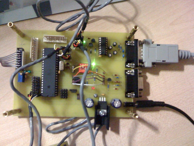

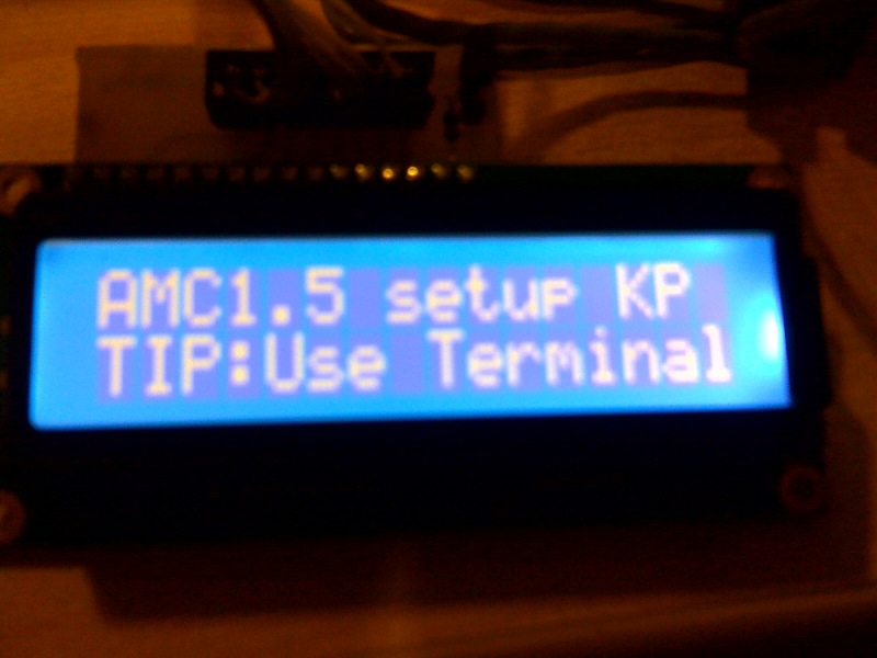

    I have finished my AMC board. And i have problems doing it working.
    I follow the video guides and i found these problems:
    -Nothing happends on the LCD, it doesn´t even light up
    -When i reach the Ponyprog stage where you have to config the Security and configuration Bits, it fails. Both green led light up when i plug it, the red led flashes when Pony Prog tries to read from ATmega8535 16PU, but i get an error Device missing or unknown device -24.
    I tried with 24Mhz-18pF and 18Mhz and 22pF but nothing...
    What can i do?
    Edit: this morning i got LCD working (the line of black squares was displayed), but now it´s not working again. How can i check if LCD is damaged?. Any test circuit?.

    Hi Thanos, hi all,
    thanks a lot again for all you do.
    I have finished my boards. Ponyprog ok, LCD ok, but i can't connect on it with hyperterminal.
    I use the Atmega644 with a 22,1184MHz crystal.
    I test with the Atmega 8535 and the same crystal, but it's the same problem.
    I verify the card, and all seems ok.
    I use windows XP, so no problem with hyperterminal.
    I test with another computer ...
    I don't know why i can't connect on it ...
    I see in another post (http://www.x-simulator.de/forum/tom...wipermotors-t1456-50.html?hilit=hyperterminal) that it could be the capacitator.
    Can you help me ?
    I use this PCB :
    Thanks a lot
    T4zt00n

    Hi all,
    I tested my serial cable and it is ok, I tested on a third computer, I changed the MAX232N and i have the same problem ...
    I don't understand why I can't connect on it with hyperterminal ...
    Information for all : when i connect my LCD the first time, i couldn't see anything on the screen ... I thinked the LCD wasn't good, but in fact, it was a contrast problem. So I tested with a resistance between the contrast adjustement and the PCB, and now it's work.
    For test, you can make a stripe with a cutter and sketch with a carbon pencil at this contact :
    For my LCD (WH1602B) i need to use a 6k.
    Mariano,
    could you use hyperterminal ? if you can, i think your card is ok.
    So look the Thanos video guide for test with X-sim.
    Regards
