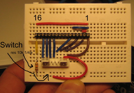

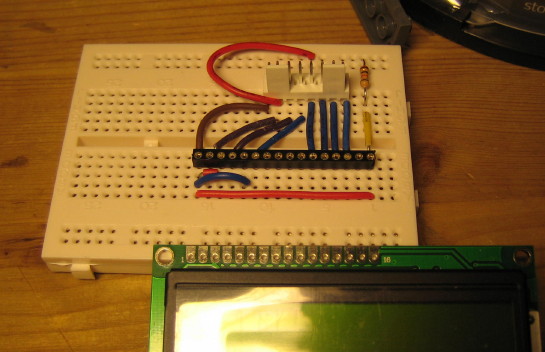

    LCD-connector. I have tried to make a lcd connector on a breadboard. I would like some feedback on it before finish it and I test it! Does it look right on the pictures? Go to my blog http://articsimulator.blogspot.com/2009/11/oppdatering.html for highres pictures.
    Do I need the 10k resistor, is there an alternative (forgot to order...)
    Fred

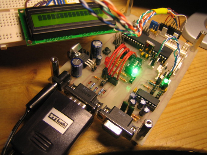

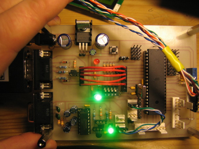

    Hello. Now i have soldered my AMC, and tried to follow thanos ponyprog-guide and program the Atmega 8535 with ponyprog. i get the unknown device message (24) as others before me, but i cant find a solution on other posts here at the forum. I will do my best to give you some information, and i am hoping for some help. First some pictures of my amc:
    I am using Crystal 22,1184 Mhz but have also tried 18,4320 Mhz
    Power adapter: old jvc VHS camera power-supply with 6.3V 1.8A
    Both green power leds and the backlight of the LCD light up when I connect my power-adapter
    Calibration in Ponyprog is OK (Ponybrog 2.07a)
    Interface in Ponyprog recognise com1
    Probe with SI Prog API says: Test OK (and Free Serial Port Monitor reqognise process)
    Probe with SI Prog I/O says: Test Failed (Free Serial port Monitor does not reqognise process)
    Read data and write data gives unknown device error message 24 (Nothing on FSPM)
    Red led lights up when reading/writing
    I am using a Serial to usb converter from ST lab (USB Serial -4)
    I have tried to check the soldering.
    I might try to find a seriel cable and test it with my old Pentium-pc.
    (Yes I have removed the three jumpers)
    Hope some of you can give me some advice on this!

    Hi Fredspeed , Does the red LED flash when you try to programme ? I was successfull only after using the 14 Mhz crystal with the the 22pf caps removed , then i was able to use the 22Mhz crystal with the caps installed. CHEERS Nick

    Thankyou Nicko. I will try that! I am building this, but do not really know the mission of all the components. Do you know why it works without the 22pf caps, and is there a risk removing them? And yes, the programming red led lights up when I try to program with Si Prog Api setup, and it tries to read or write for about 30 sec before error message. With SI Prog I/O the error message comes imideatly amd no red led!..

    Thanks for the advice 914atom, but I have been there, and there must be contact with the com1 port since the programing led light up with SI Prog API setup, dont you think?

    I am not sure why it works with the smaller 14 Mhz crystal without the 22pf caps I dont know enough about electronics ,but once I got it working I then fit the 22Mhz crystal and the 22pf caps . I then re-programme it with 22mhz Hex ,there are more posts about this issue on this forum.
    CHEERS Nick

    Hello again, Thanks for replies! I have now connected AMC to an old pentium with serial com ports, to be shure about the ports. Now the probe in both SI prog I/O and SI prog API says probe ok. (Thanos Guide tel us to use I/O) The connection now must be ok, and the red led also light up when i use ponoprog to reset device. I will now try to remove 22pf caps and use 14 mhz as you did Nick, but I have a question: Do you make a connection with wire instead of caps, or do you leave it with nothing?

    With nothing,
    the caps go stright to ground, the christal wold be terminadet !!!
    I also have a successfull evening, i replaced my 24MHz with 18MHz an the connection could be established.

    So this means that if I want to try what Nick did, i must replace caps with a wire. (If my questions sounds stupid, its because i am doing this with minimal knowledge about elektronics :))

    First try the 14 MHz Crystal with the caps , if that is unsuccessful then remove the caps . Do not make a wire connection where the caps were , this would create a short circuit (as Tom said )
    CHEERS Nick
