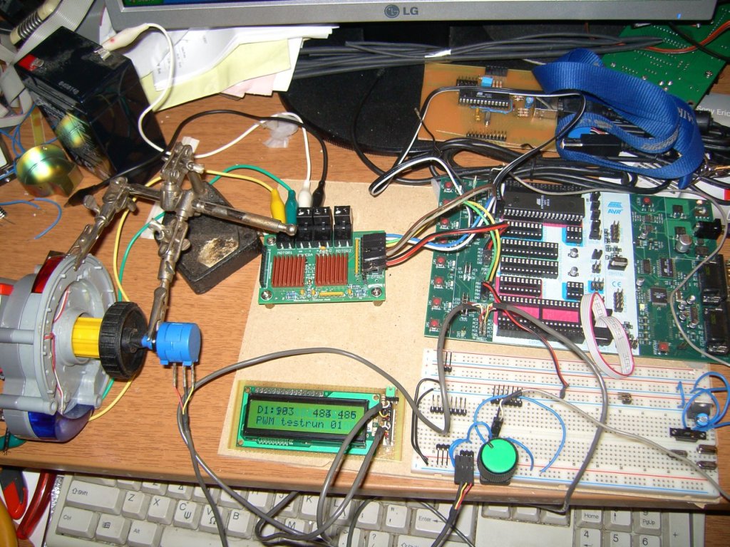

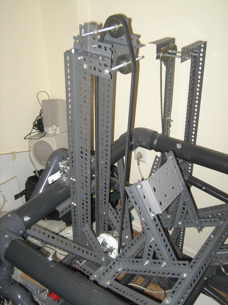

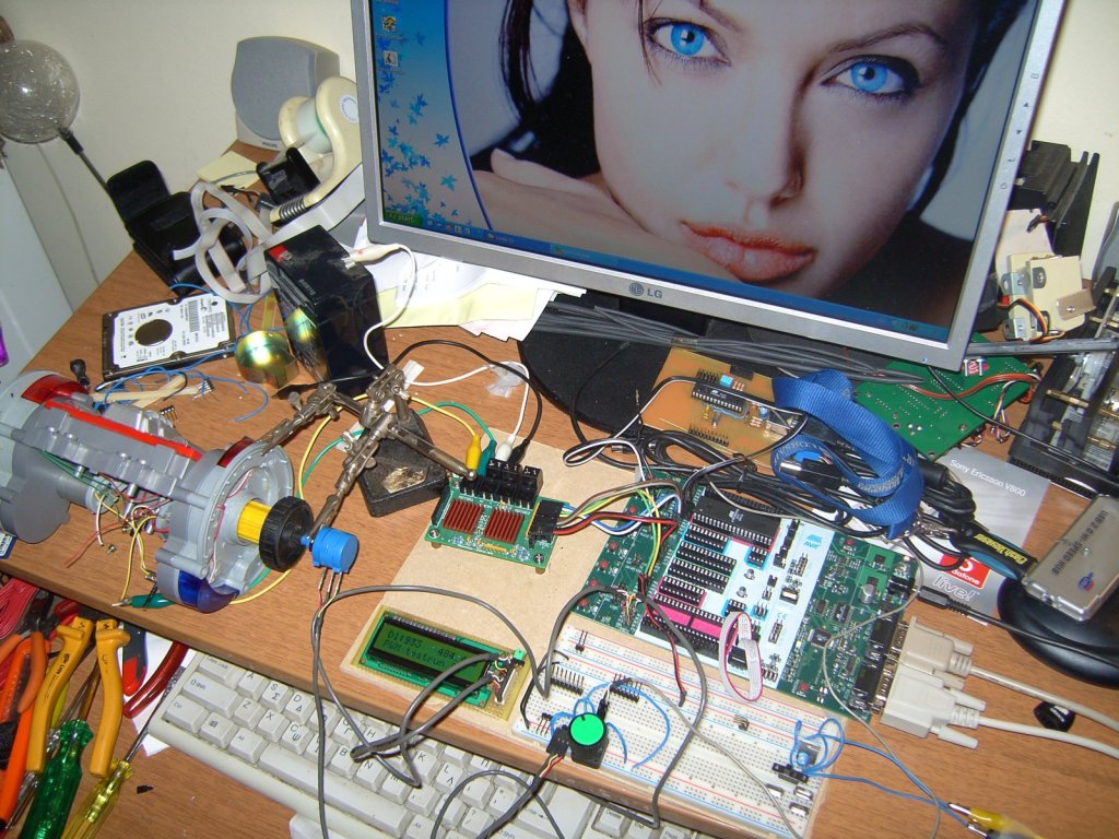

    I wanted to have something more meaningfull to show to you but since you keep asking for news I cant deny you.
    I took a short video of the PWM control tests I've made so far. I took some pics too to see the condition of my office with all these electronics taking all over and the mess is keep growing.
    http://rapidshare.com/files/64146451/PWMtest1.wmv
    In this video I controlled the position of the motor manually with a pot to show you the rapid changes of direction. The crappy dc motors (with gearbox) are from a toy and produce lots of whinning sounds with PWM. And their gearbox tended to keep rotating cause of the inertia even if I fully reversed the direction. I wonder If the same happens to the wiper motors...
    I now use these crappy dc motors fom a toy because I had a little drawback with the DC motor I used (the one with the encoder). I was trying to remove the ball bearing on the tip of its axle and after much try I was getting angry and started hitting it with a france wrench. But after I tryed to get it back on work I found out that I had also braked its commutator carbon contacts inside it!!! :-( I'll try to get another cause I really liked that it had its own encoder. But I may not get the chance to dissasemble such large printer that contained it soon so I will search the local market for such motors or just the encoders if I get lucky.
    Anyway I had not much free time to implement much more because I also had some hard work to be done on the joyrider. I changed the steel pulley cables with a BUS type engine belt. It turned out real pain in the ass because the belts I bought was 10cm longer (I could not find excactly 2meters long that I needed) and I had to add more pulleys to archive the proper tension. And I had to unbolt many, many, many bolts to pass the belt thru the pulleys! Now I have yet to buy some large clips to be able to hook the frames with the belts too. This conversion is nessasary to keep the joyrider in one piece when I hook on it the new controller for pwm tests on its motors cause I little fear of the new angry pwm motor controller!!
    After all, it looks good and its thousand times more durable than the simple coated wire that needed tensioning after some hours of using the simulator.
    Regards, Thanos

    Thanks for your update. LOL :razz: You must forgive my enthusiasm in asking you for updates, I think your PWM controller will be very cool.
    Is that a pic of your lady friend on your comp...very niiiice :roll:
    Your office is a lot tidier than my den so I wouldn't be shy about it!
    In the video are you only demonstrating speed control and not the servo function? When the motor changes direction have you coded the H-Bridge to act as a brake as well, I am wondering why there is inertia?

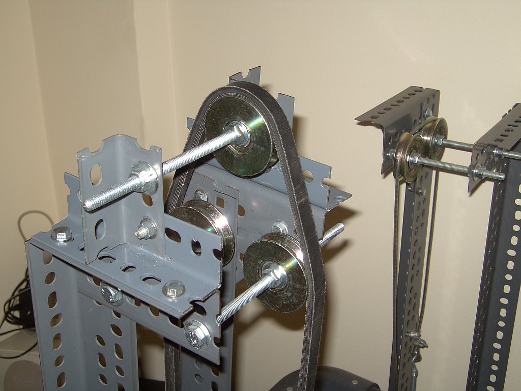

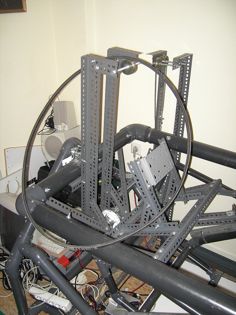

    Where did you get those pulleys? I am trying to find some too. They're not the sort of thing you can find in a handyman store.
    You must have a heck of a job making sure all those nuts don't unwind with vibration! locktite?
    You are right your sim looks a lot more meaty and staunch. Really cool.

    I don't mind asking me for updates. Sometimes I focus building things and forget to inform you guys how it goes.
    The pic on my desktop... I wish! I thought you could recognize Angelina Jolie!! :D
    In the videos I did demostrate servo control using the toy dc motor with the multiturn pot mounted on its axle. But since the pot needs many revolutions to reach each end, it seems like doing speed control, check closely...
    I didin't had the chance to do servo tests with the pot on the older dc motor (that included encoder) before I broke it. So only speed control is showed on this.
    The link you gave me is refering to a dc motor with encoder. Anyway any type of optical encoder is good as long as it has A & B channel output 90 degrees out of phase.
    You mean those small golden pulleys with ball bearing? Yes they are very common here, many hardware store has them, they cost 1 euro each!! Generally all the parts of my simulator are bought from more than 10 different hardware stores!
    And yes I used locktite on every sigle nut on the simulator (we are talking for more than 200 bolts and nuts!!!!)
    The belt I used is from a Mercedes BUS (2 meters long!) and is usually used inside an engine! I found it on a local shop that sells bus parts. (I was repairing their computers and gave me two such belts for 10 euro... :) )

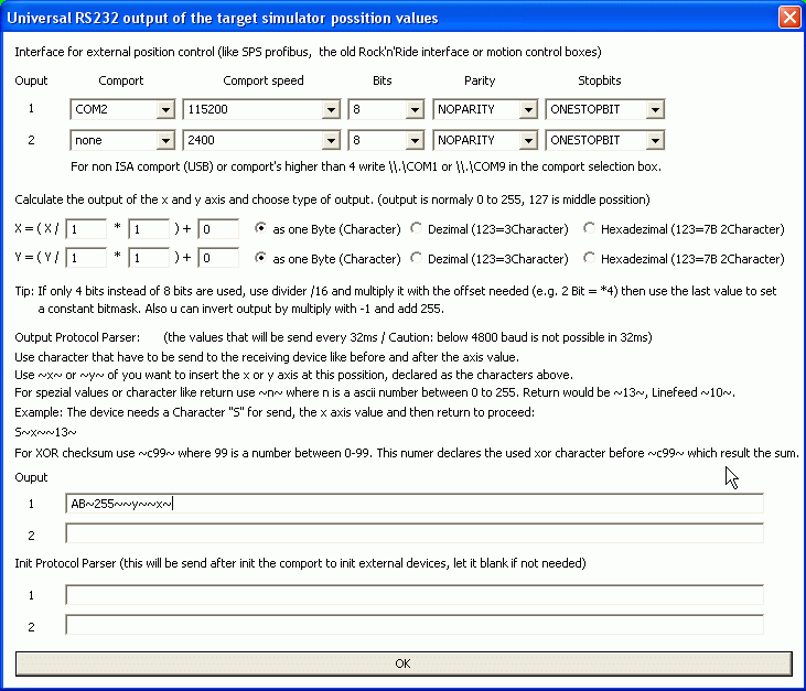

    -It runs on serial speed of 115200 and you have to enter the setting of the following photo in the profiler USO to get it connected right:
    The format of the output string is “AB~255~~y~~x~”
    The ~255~ is there for compatibility reasons to be able to also test with Ian’s BFF 3DOF driver!!

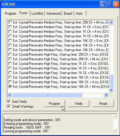

    -As you know I have overclocked the Atmega8535 from 16Mhz to 24Mhz. To be able to run on this speed you must change the fuses to allow external crystal clock source as seen on the next photo:
    Since the AVR controller has its own serial programmer included (ISP) you can use ponyprog to easily program the flash firmware on it and set the proper fuses for the crystal speed. I will show you in a next post how you can use ponyprog.

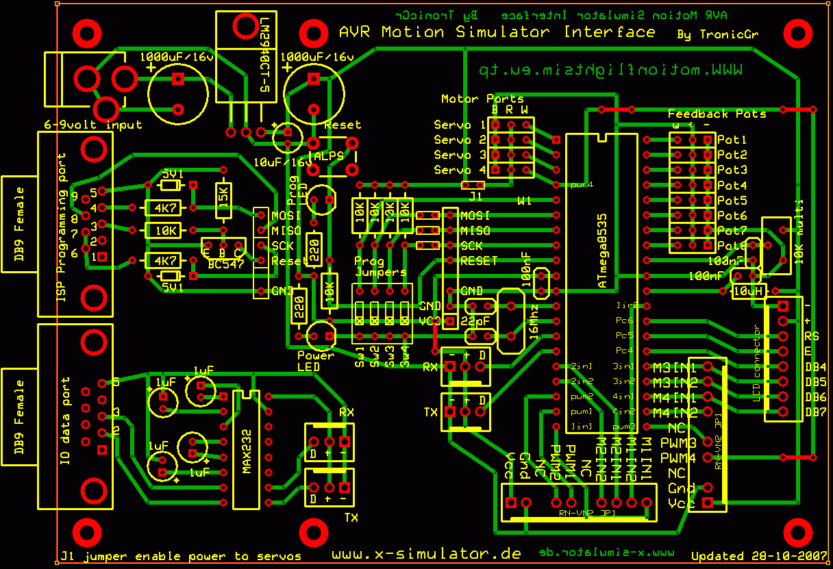

    Below you can see the new layout I made to be able to follow the RN-VN2 connection standards. PCB plans are included to built this board if you want. Over this layout I’ll add the rest software features to make it able to fit to every type of motion simulator. Other PWM motor controller can be used too since they use the same basic connections (PWM, Enable1, Enable2) just different layout of the connection stripe.
