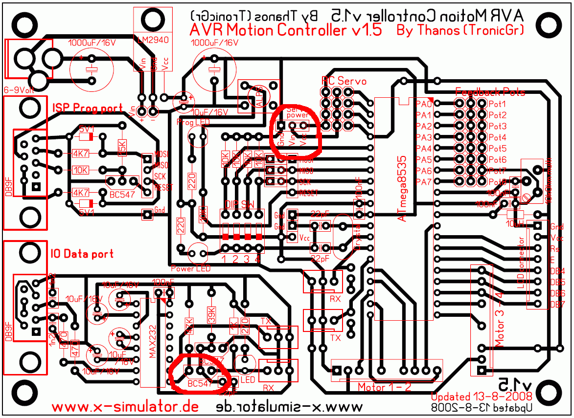

    Which transistor did you bridge? There are a lot of unnecessary components on that part of the AMC. If you inspect the schematic you will see that the transistors don't really do anything in terms of logic, maybe invert the signal and invert it back (or it wouldn't work).

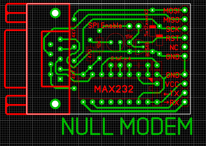

    Here is my little circuit that has BOTH the serial programmer circuit and the RS232 level converter circuit for RX/TX. Measures 4.5 x 3cm, but without the connector I made it even smaller on a perfboard. As you can see there are only 4 capacitors that you need the MAX232 to work.

    i take again a look at your firs post an the picture of your board.
    1. try to solder the trasistors direkt to the board, eventualy there is a problem withit (the sokets are not necercery)
    2. your power adapter is 6.3V 1.8A ? your imput voltage is maybe to low ?!
    on the datasheet http://www.datasheetcatalog.org/datasheet/nationalsemiconductor/DS008822.PDF side 2 you can read, the minimum input voltage vor the LM is 6.25v.
    When you hit the elektronic store maybe buy a cheap socket 'multivoltage AC-DC adapter' and try it with 7.5v or maybe 9v.
    an if this ALSO will not work...... i have no more ideas
    tom

    @niko,
    Would you mind posting a picture of the amc board showing which transistor you bridged out? Maybe that's my problem too. I would appreciate it tremendously if you could do that mate!
    Also, once bridged, did you leave it like that, and when you open up force profiler, does the program detect your x and y axis?

    Hi everyone . The transistor I bridged was the very bottom one on the board.On the RX line.Currently i am placing the transistor in backwards to make it work :? What I also found was that my Dip switch No 2 was not functioning properly .I could feel it was not clicking as well as the other's .I was carefull not to put too much heat into it when I soldered it but I suspect it being of poor quality,they were cheap :thbd:I also noticed that J1 (servo power jumper) marked as Gnd,Vin,Vcc are inverted, correct me if I am mistaken.Some of the earlier drawings are correct.Also noticed some of the hex files the crystal numbers dont match the crystals on the parts list that I used.I dont know if thats important. Keep the posts flowing every little bit helps CHEERS NICK
