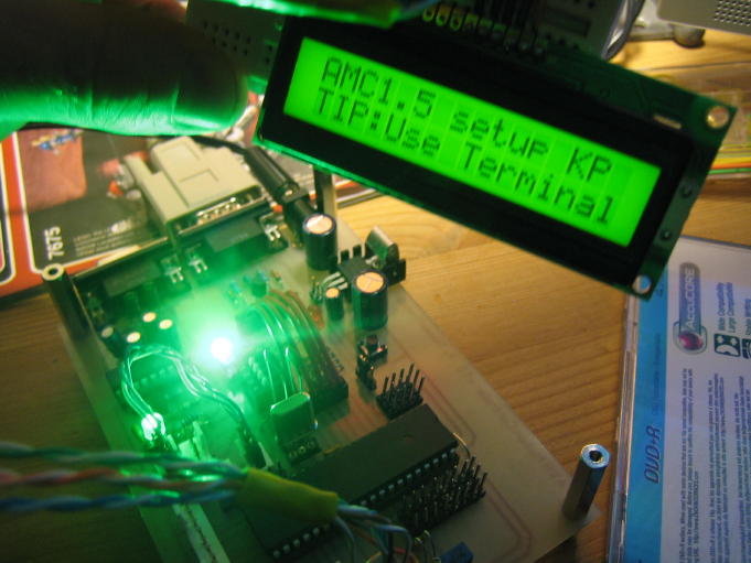

    Update :In the process of playing with the wiper motors I managed to blow up some fets.on the H Bridge (they go off like bullets) Yesterday I recieved my blue LCD display and manged to connect force profiler :clap: , when I move the pots the second set of numbers move up and down,when I adjust the sliders in profiler the first set of numbers move up and down(I think this is all correct so far) Now while I wait for my new Mosfetts I want to try MS Flight sim and work out how it connects with profiler

    Hello folks. I am so happy right now, so I must share it with you. I replaced the ATMEGA with a new one, an was then able to program it. I first choose the 14 mhz chrystal, but I guess I can reprogramme it and try with another crystal? Anyway, it seems like the first atmega I purchased was bad! Now I am ready to move on to the next step. Thanks to You Thanos and you other good helpers, I guess there is more challenges ahead, but this was a big step for me!!! :yippiee:

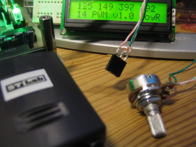

    Hello Pippo, seems like we are at the same stage. I have loaded the 14 mhz firmware with sucess last night, but have not managed to make it connect to x-sim yet. I take one step at a time, and will try later this weekend to read some posts about it and try to make it work (to busy with other commitments...) I will post my progress with it here, and I guess there is a lot of folks on this forum that can help us with the next step!
    Edit: Now i have sucsessfully followed thru Thanos amc guide and hyperterminal guide and tested my amc with x-sim. I use a usb-serial adapter from ST-lab, and i am able to make the lcd show the numbers in x and y axis when I am moving the sliders. I have also tested a potentiometer on the amc and i can see the changes on the lcd, but after a short while the potentiometer gets hot, (and smokey) I believe I have missed something about pots. It is a 250k but i also have 100k, and I will try that too, but why does it get hot?
