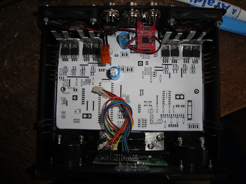

    thanks ne02005
    the bord have programmer, now I don´t have must time to finish the job but I will put here what I'm doing, will be beautiful in the box :)

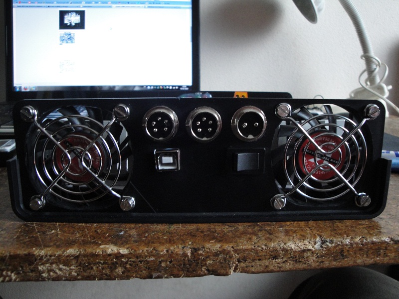

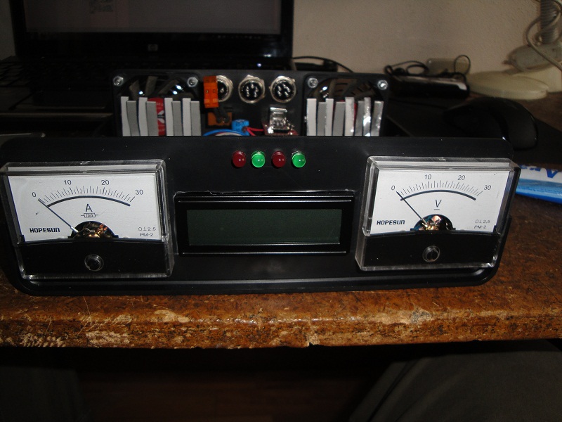

    hello today arrived the ft232bl, more pictures :)
