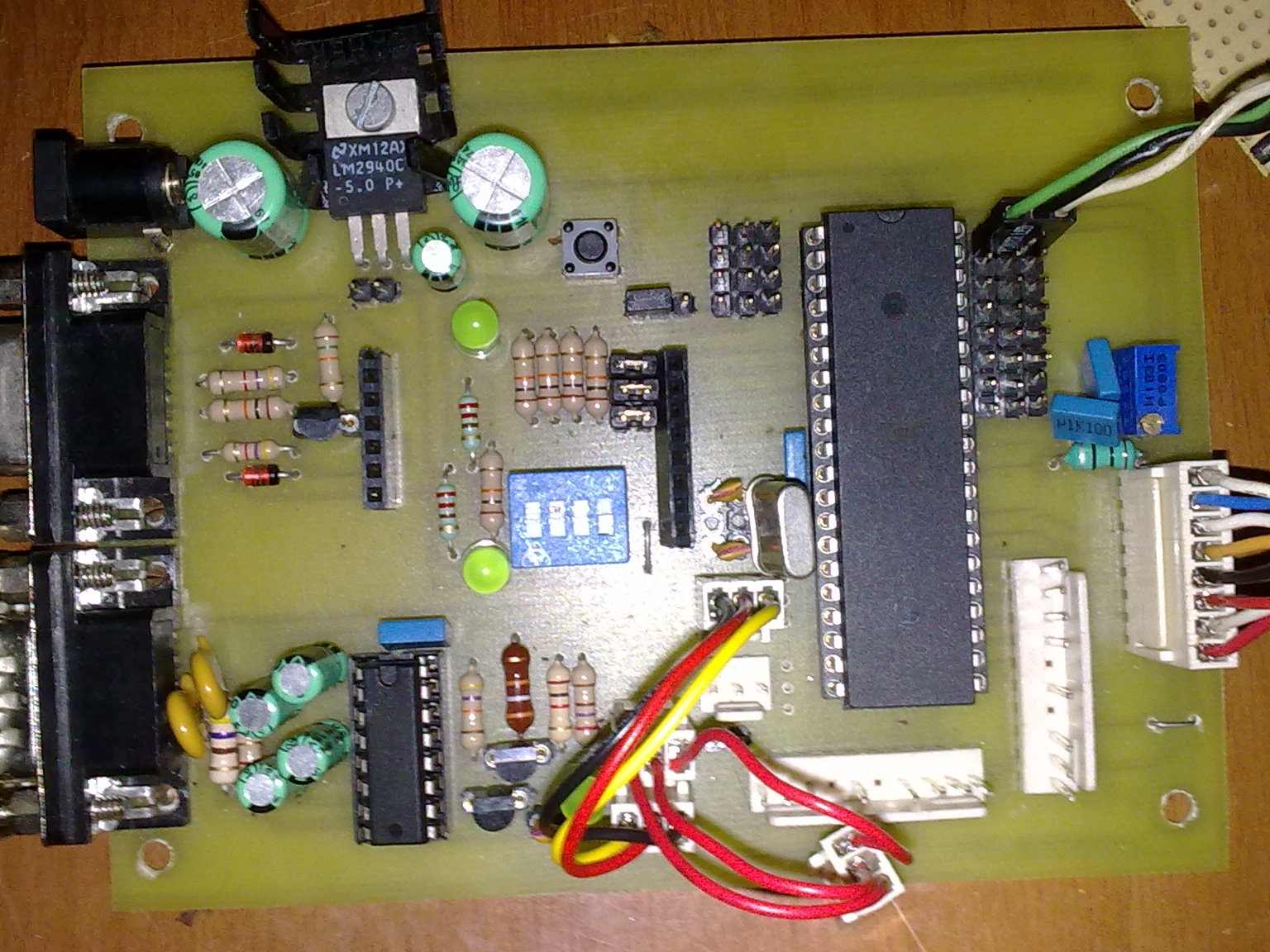

    hola a todos, he construido una placa amc 1.5 tengo un problema no puedo configurar en el terminal el kp. he probado en el force profiler y no se mueven los numeros del LCD al deslizar la X y la Y. He seguido el video de thanos pero le he dado mil vueltas ya. una ayuda por favor.
    google translator:
    hello all, I built a plate amc 1.5 I have a problem I can not configure in the terminal kp. I tested on the force profiler and do not move the LCD by sliding numbers X and Y. I followed the video but I gave thanos thousand times already. Please aid.
  5. momo194
    momo194 New Member
    Jun 3, 2009
    11
    0Coins
    I exactly have the pitulo's problem, all the other stuffs are ok !
    Could someone help us ?

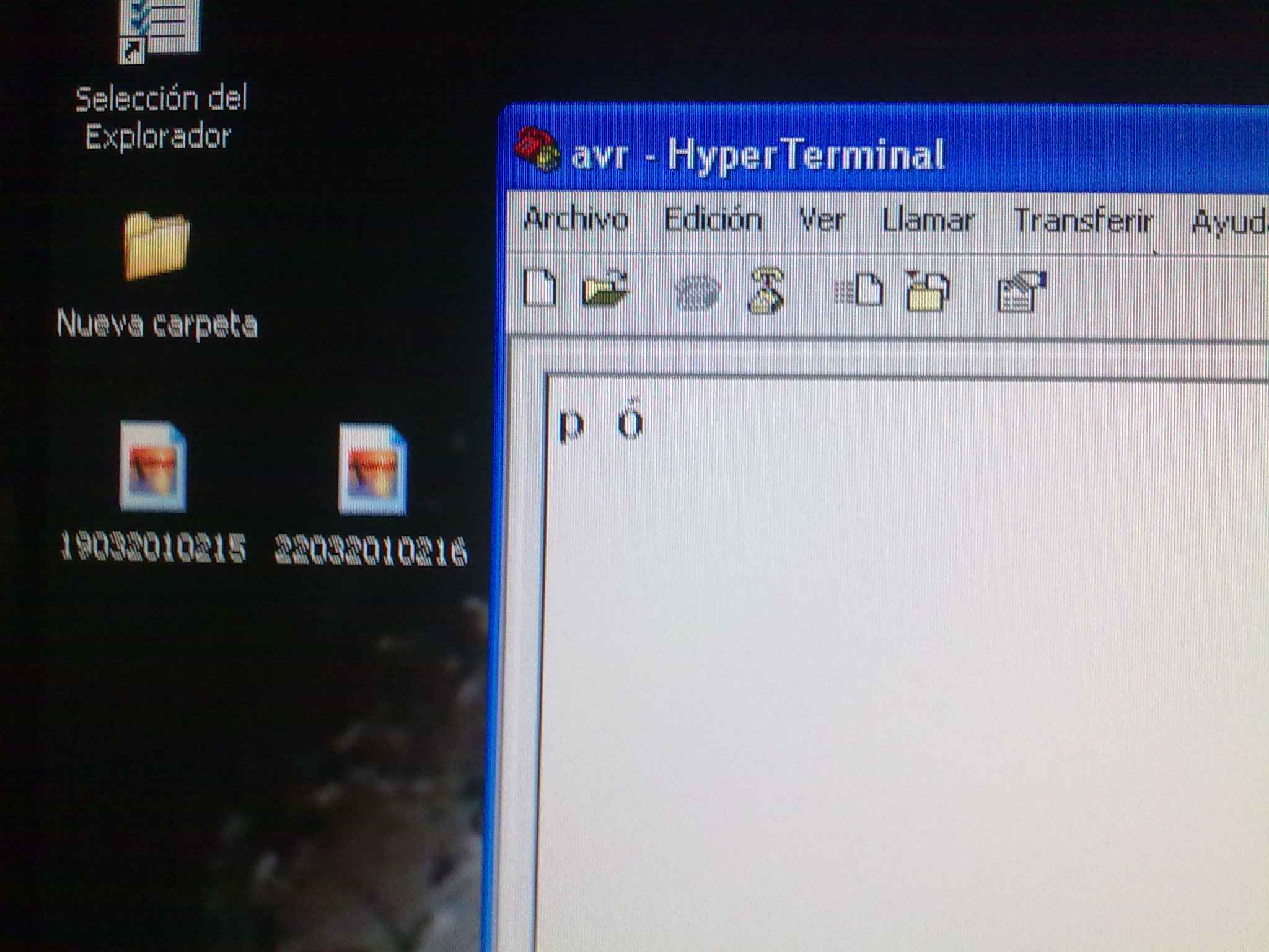

    I had that problem too, when trying to set up the Kp values in Hyperterminal, I couldn't send the value to the controller, but the welcome text appeared.
    This is from the manual Thanos wrote:
    The steps to start and use the Windows HyperTerminal are:
    1. Open HyperTerminal.
    2. Enter a name for the terminal window (I called it “AVR”)
    3. Select the COM port you are using
    4. Set the bits per second as 115200 and Flow Control to “None”
    5. From Menu, select View, Font, and increase the system font to size 12.
    6. Now set the DIP2 switch to ON position and power-on the AMC1.5 board.
    My problem was fixed by setting the Flow Control to None. If you already have the connection, make sure you are not connected, then change this and save the connection.
    Now every time I try to send data to the controller with the Profiler, it keeps resetting and acts weird. Anyone with this problem? :D

    the hyperterminal does not give the welcome text, I followed the detailed steps of thanos. In the LCD all the changes appear, but I can not set the Kp and connect with profiler and force him to start move the slider as shown in the explanatory video and does not move the values of 128 128. Another problem I noticed is that the values of the potentiometers are always up and down without stopping.
  10. Frakk
    Frakk Active Member
    Apr 15, 2009
    1,144
    328Coins
    By how much does your value move? +- 1-2? That is normal.
    Your problem is in the hardware, the controller is not communicating with the PC. Make sure you connect your TX wire, proper jumpers, and also check your circuit for physical faults. Check your hyper terminal and set it up properly. Other than that I don't know what else to do, I am having problems with it too.

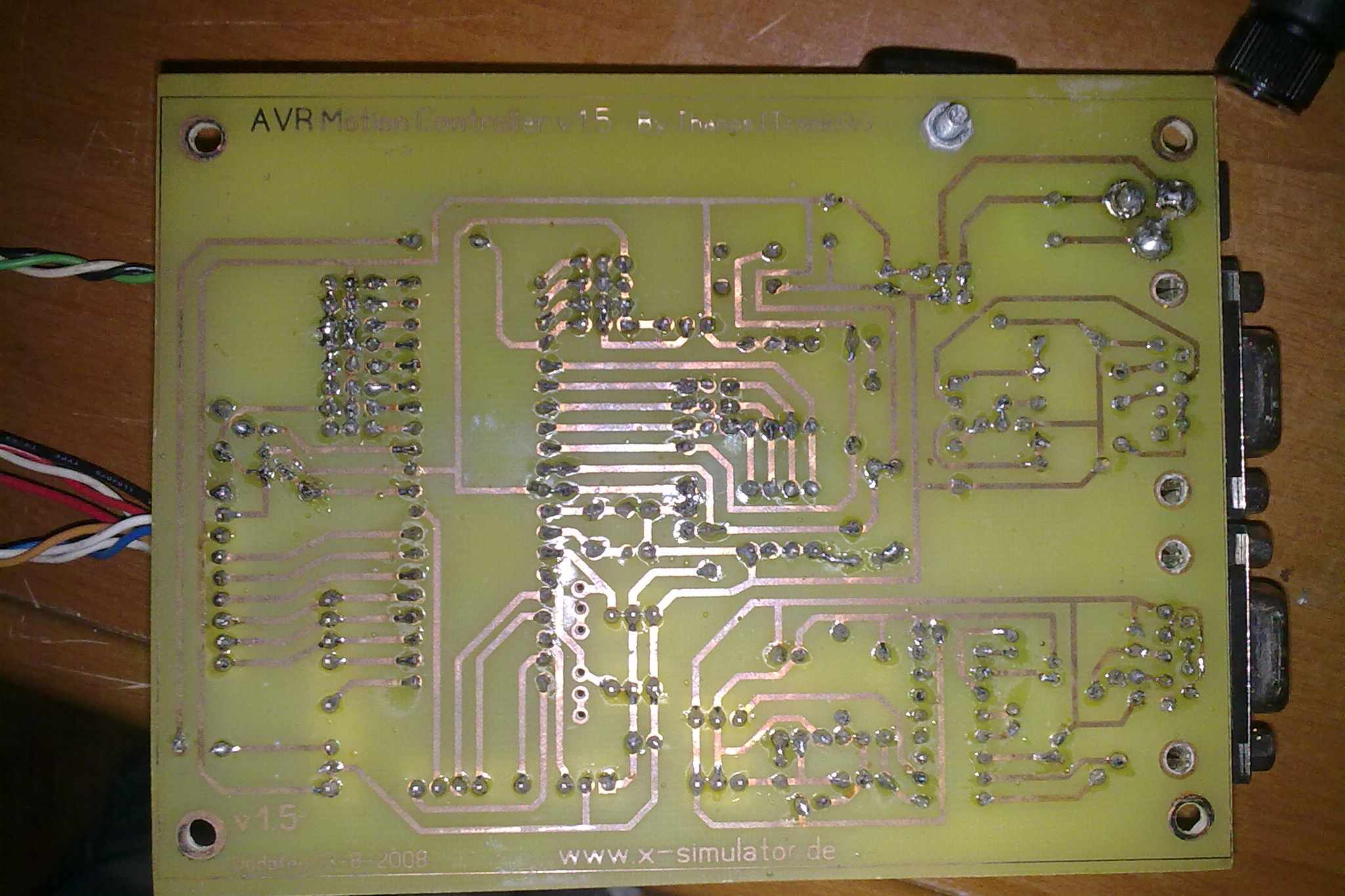

    Hi guys,
    My Kp setting problem is now over: the 2 switch from DIP-switch seems to be out of order. So I connected the first and the sixth pin (starting from the top) from the right 5-wires clip base (the right one). Doing this, everything came into order and now I'm able to set both KP-X,Y into HyperTerminal or Putty !.
    My FlightSimulator is a wooden made, and only one motion (roll) is made. Pictures Soon !
    Thanks again !
    Momo from Belgium

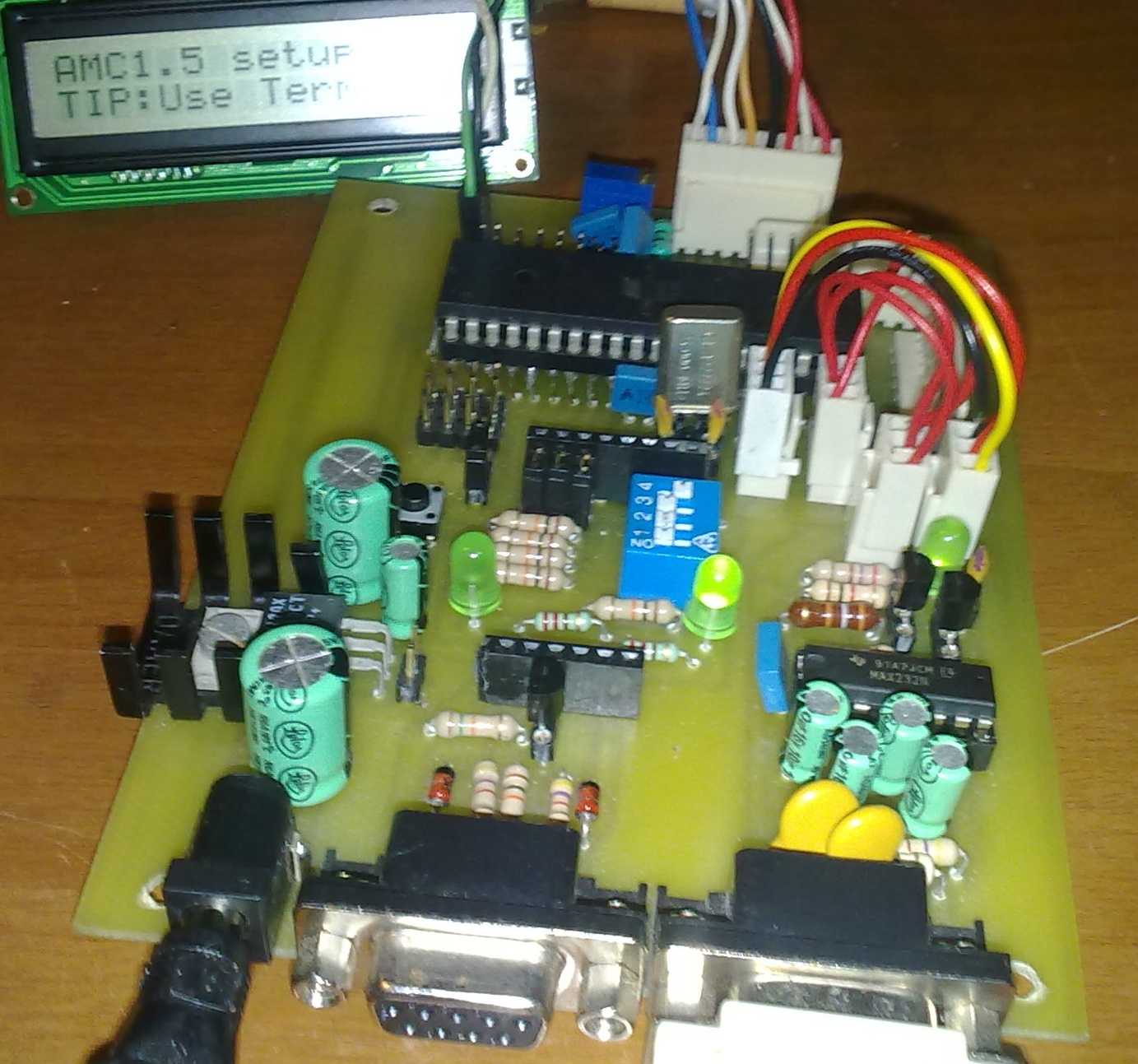

    hello all, I followed all the steps to set up hyperterminal and Kp in the putty, but the information I give is incorrect. on the LCD screen all ok, but I can not connect to the PC. I'm working with 24 Mhz crystal, would be that a problem?
    momo. I do not understand what you mean, a picture or something similar could upload thank you very much.
  17. erichans
    erichans New Member
    Jan 20, 2008
    55
    6Coins
    Hi Pitulo,
    I had lots problems here as well!! Please see Page 38 (you need to change the value of one resistor on the AMC Board) & Page 32 of this thread which has some info on problems with crystals. Thanos was kind enough to post the info I sent him. My board would not run at 24 MHz at all and was unstable at 22.1184 MHz. It was perfect at 18.432Mhz. It makes sense, esp. if you have a lower value crystal on hand to try this to get things stable. Of course it means reprogramming using Thanos' appropriate firmware for your crystal. Best of luck!
    Regards, Erich.
