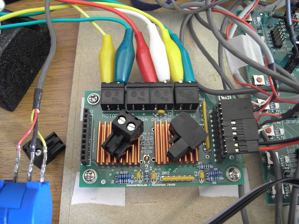

    Ok, I used a frequency meter to measure the exact PWM frequency of the AVR controller and I found the the actual PWM frequency that it drives the RN-VN2 is 23,47khz !!!!!!!! I expected this to be 20 or top 21khz but 23,47khz is more than good!!! Thats why the high pitched noice is totally disappeared!!! I wonder, though, how the RN-VN2 continue to work in this frequency since the datasheet states that the maximun is 20khz. Anyway I don't see any difference in performance so I guess it can run fine with 23.47khz after all!

    Does anybody had the same problems with the motor (and power) connectors of the RN-VN2? I had to discart the connectors with the bolts cause they had poor contact.
    Now I use directly cables with crocodile clips, but I have to figure another way to mount the thick cables I use in the joyrider! The motors can draw lots of current and can burn the simple crocodile cables!!

    Yes Thanos, the connectors were described as quality connectors, but i don´t think so! At my RN-VN2 they shake and does not fit exactly into eachother. Only question of time, when the contact loose. We should replace that connectors with kind of this ones:
    LINK
  14. tronicgr
    tronicgr
    The connectors on the link are good but it whould be better if they were atleast 15amp rated!
    I have measured surges of 18amp on my motors under load!!!!
    Thanos

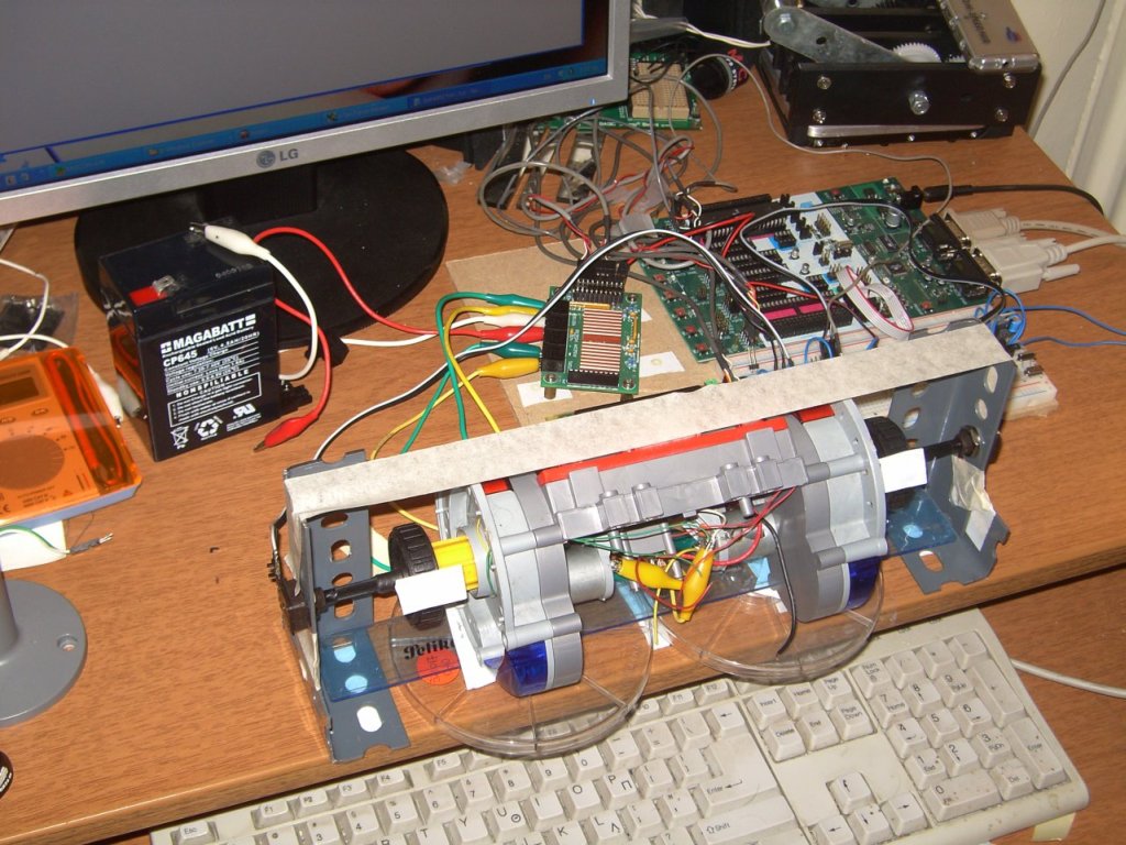

    While waiting for your input on the performance of the beta001, I developed a SimforceGT (frex-like) motion beta version for Egoexpess and everyone else with simular motion cockpit!!!
    [​IMG]PWMBETA002FREXkp3.zip (2.32 KB)
    As the name of the firmware states, I coded Kp=3 (proportionality constant) in it as it seemed me fast enouph with the simple pots. Just test it and ask me for greater Kp contant firmware if needed.
    Motor assignements are as follow:
    Motor1 connection (on first RN-VN2) is the right motor on the simulator.
    Motor2 connection (also on first RN-VN2) is the left motor on the simulator.
    Again potentiometers are used for feedback on the motors: Motor1 --> Pot1 , Motor2 --> Pot2
    I took a demostration video with LFS to see how it moves on my test table dc motors. I wanted to hang a large piece of paper to be moved like the car seat but the rotation of my motors was 270 degrees. Yes I used simple 270 degrees pots attached directly on the axis of the motors and had great positioning precision and fast moves! The motion is limited in half for left-right as I reserved the rest motion capability for front-back motion! Seeing frex like motion in action makes me wanna built a full scale model to try how it feels! :)
    Beta002SimforceGT.wmv
    Regards, Thanos
