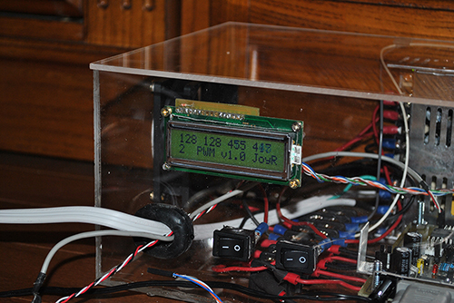

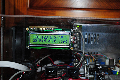

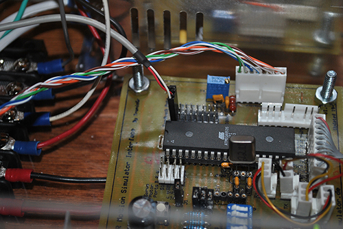

    Hey everyone. Well after taking a long time off I'm back on my project again. Hopefully I can complete it and finally get some fun out of it. Anyhow, after making a new box and re-assembling everything I think I'm having a problem with the 10K Trimmer Resistor for calibrating the pots. Without the pots connected everything looks normal as in the second photo. Then when I connect the first pot it looked strange as in the third photo. I noticed when I turn the pot both ways nothing happens and the numbers do not change. I'm wondering if the problem is the Trimmer Resistor? Everything was working the last time I worked on it. The only thing that has changed was moving everthing to the new box.
    Specs: Atmega8535-16PI Programed with firmware (PWM_AMC15_2DOF_V1_CRYSTAL22.HEX), 22Mhz Crystal

    As I recall, shouldn't you flash (program) the ATMEGA with appropriate FW according to Crystal frequency?
    I think Thanos made several FWs and in the name of FW is Crystal freq. as you pointed out yourself.
    I could be wrong 'cause few people have mixed FW and Crystals, and if this is your setup from the beginning (before moving to new box), than you've messed up pot wires (or some other wire).
    EDIT: I`m confused by looking at 3rd photo. It says - 22 PWM ... and you are probably using FW for 22MHz, so my responce is not making any sense, sorry :blush:

    Thanks for pointing out the error fermevc. It is programed with the 22 hex file.
