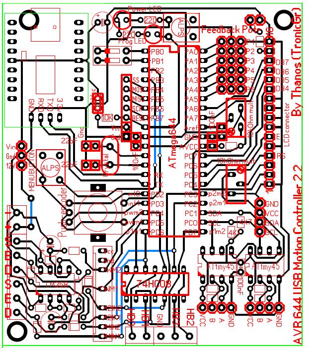

  17. tronicgr
    tronicgr
    Here is a quick preview of the new AMC controller (some lines still missing). Dimensions of the board will be about 80mm x 90mm :D
  18. Frakk
    Frakk Active Member
    Apr 15, 2009
    1,144
    328Coins
    Good job! :clap:
    How close are you to the first functional board?
  19. fermevc
    fermevc Member
    Jun 16, 2009
    126
    Networking and telecomunication
    Serbia
    5,956Coins
    +60 / 0 / -0
    Slick and compact :clap:
