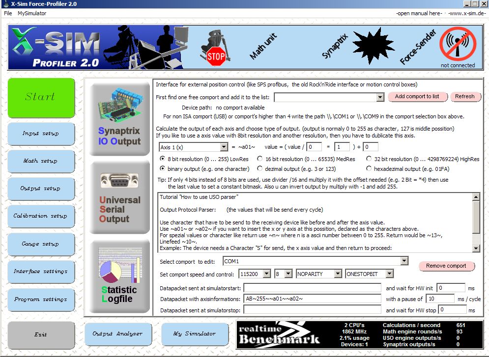

    how are the correct USO settings for the AMC at Profiler 2 for my Joyrider?

    If someone would upload a highres screenshot, it could be implemented into the OP.

    This is what i have. my sim is not ready, but it works with the test tablet, and values changes on my display. Hope it helps! ;D uso.jpg

    Thanks for the screenshot!

    @ATSP&fredspeed, I do not know if it can be useful, but 1 * 0 = 0 and the value / 0 -> 00 (infinity), then perhaps we should add value / 1 * 1 +0, I also do not appear above the COM port!!!

    I have a Error Parser Error check the universal serial output parser strings!Check used axis numbers and count
    AMC set error, or Software :-/
    Edit I take a new Profiler Pc ,
    Editit the same with the new Profiler Pc
