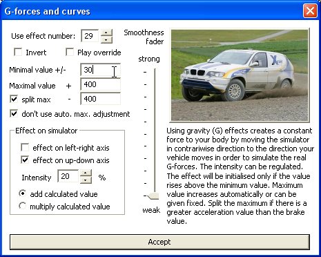

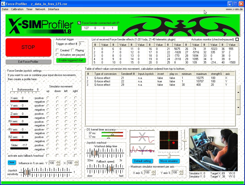

    After a question about feeling bumps and curve curbs on a SimforceGT (frex-like) motion system using my avr motion controller, I searched more carefully the parameters of x-sim Force Profiler and managed to mix the z acceleration forces to the y motion data.
    The result is awesome! Better than I was expecting!
    I took a short video to see the difference in motion with bumps and other heave motion also mixed in it.
    SimforceGT video
    When running fast most of the bumps are absorbed by the sustains of the car so you get less fast up-down vertical motion than in low speeds.
    Anyway here is the profile to test it for yourself:
    [​IMG]z_data_in_SimforceGT_LFS_profile.zip (0.53 KB)
    I haven't tested the range of these values on my simulator yet so if the motion is too intense you can always reduce the % strength.
    I getting to like frex-like motion systems more and more. I might attempt making one if I can save enouph money for it! :)

    Can you explain better what do you mean?
    Limiting the motion travel inside the controller? The software (profiler) can limits this.
    Regards
    Thanos
