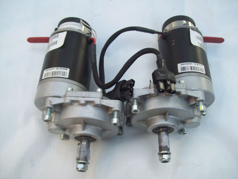

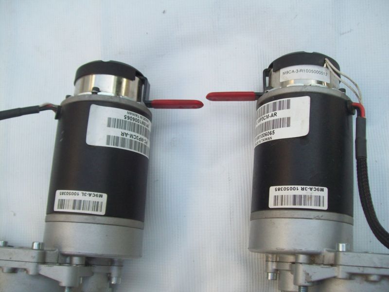

    Hey guys!! :hi: I'm wanting to start buying components for my sim but I have a few questions. Will this controller run wheelchair motors? I have 2 wheelchair motors on the way that I bought off of ebay. Im guessing they are between 30 and 40 amps and draw over 150 volts I think. These numbers are just guesses from other motors that I was able to find specs on that were very similar. If this controller will work will I have to modify it in any way? Thanks Guys.
    These are the motors. The auction said they were Merits/Dalton Power Chair Wheelchair Motors. The guy also said they are up to 40 amps and 24 Volts DC.

    Ok so far I have read page 1-50 of this thread. If I understood correctly this controller will support up to 40amps if I bridge it or something? So to run two 30amp motor like I have posted above reliably I will need two controllers? I think that is correct please let me know if I am misunderstanding. I really need to use these stronger motors since I will be mounting 3 screens to my sim.

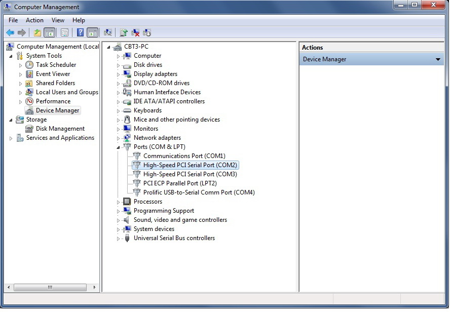

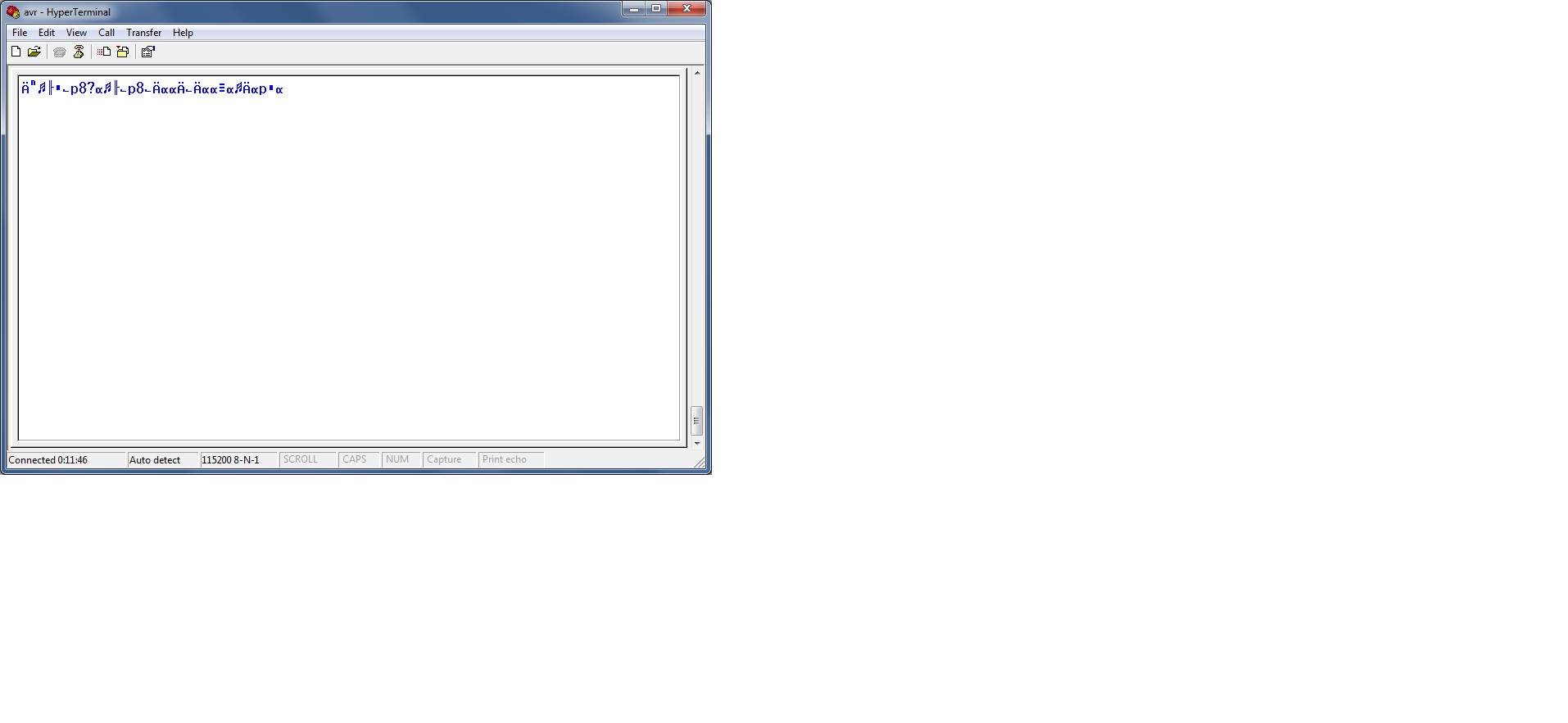

    Dear all,
    before thank to Thanos.
    i have finished my first assembled AMC1.5 using 24 MHz crystal but still have problems
    could someone to help me. when i connected to hyperterminal to setup there are bad character and also can not connected to x-sim
    i am using windows 7
    thank you very much for your help
    regard
    definal
  18. fermevc
    fermevc Member
    Jun 16, 2009
    126
    Networking and telecomunication
    Serbia
    5,956Coins
    +61 / 0 / -0
    Try using slower crystal (eg. 18MHz), and tell us are you using physical COM port or USB2Serial adapter.
    In order to communicate at 115200, many things need to be considered, try reading earlier posts, you'll find the solutions for some issues other encountered.
    BR
  19. definal
    definal 2DOF Platform
    May 24, 2011
    6
    Bandung
    - 373Coins
    Dear BR,
    thank you very much for your response.
    I have tried to replace with new 18.432 MHz and 22.1184 MHz crystals but my AMC could not be programmed error 24 and replaced again with 24 MHz and it's OK. i was using internal card high speed PCI serial port and have speed maximum to 128000 bps.
    thank you
  20. fermevc
    fermevc Member
    Jun 16, 2009
    126
    Serbia
    5,956Coins
    +61 / 0 / -0
    First to tell you that my name is Igor, and BR = Best Regards :yippiee:
    Why don't you use COM1?
    I really don't know what is High-Speed ... port (never seen that before).
    Please read earlier posts or use SEARCH for error 24, I'm sure someone had that problem.
    EDIT: Are you getting Device Missing Error -24? If yes, try changing your Atmega IC. Check this topic - http://www.x-simulator.de/forum/amc...own-device-24-t1390.html?hilit=device missing
