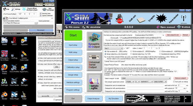

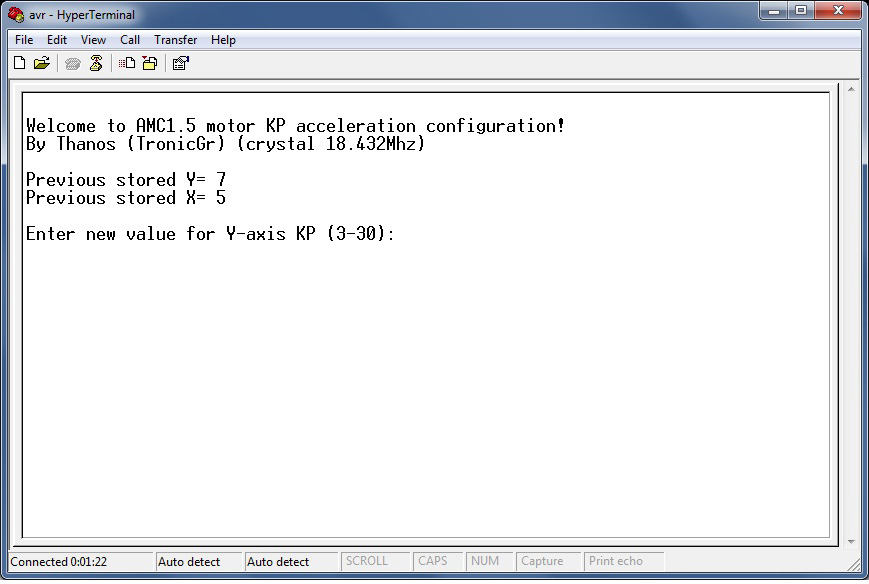

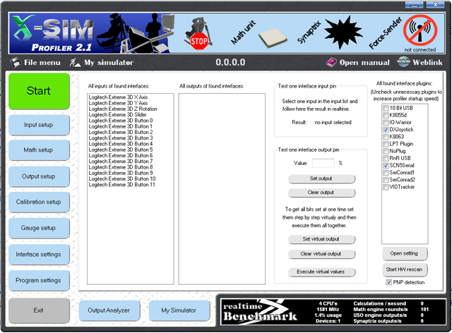

    Dear Thanos, Fermevc
    i'm very happy right now due to my amc1.5 was success to communicate with hyperterminal using crystal 18.43212 MHz as image below. thank you very much to Thanos and Fermevc for help. Now i'm still assembling the DSMHb and i hope for this week will be finished.
    I have a question when i connect to X-sim profiler, my amc1.5 cannot detect as output interface. Did the DSMHb should always connected to amc in order to detect with x-sim profiler?
    Thank you very much for your help
    regard
    definal

    @definal
    I can't help you with X-Sim because I never finished my simulator (I only did some basic testing using generic profiles for LFS) :(
    I think that AMC & DSMHb can't be autodetected, you need to do the setup in USO section of X-Sim for specific COM port that you're using.
    Try to search in X-Sim thread on how to setup and test.
