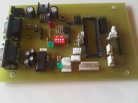

    hello my name is christian :hi: and I write from Venezuela, I'm building for thanos avr card, I think a great job on their part, the problem is that in my country do not get the ATMEGA8535-16PU, but if I get the atmega644, I would like to know if I can use the card without changing anything, or should modify any component? the crystal I'm using is 18,432 MHz, if I can help I thank you, my knowledge of electronics are very poor :blush: and I'm making the best effort to understand this project, excuse my English but I am using a google Traslator of :)

    Hi Christian, to use the crystals of 22 MHz or more will have to change the capacitors of 18 pf (in the list of materials makes clear), with respect to the microprocessor can not tell you if the 644 will work, my experience is reduced to 8535 .. . if there is no possibility of getting another one I would try with atmega644 ... but, patience, someone will answer your questions on the forum ... I take many months to build my simulator :D

    You should only use 16MHz and up processors, therefore if only the ATMEGA8535-16PU is available to you, use it, but only with 18.xx MHz crystal with matching caps, and firmware.

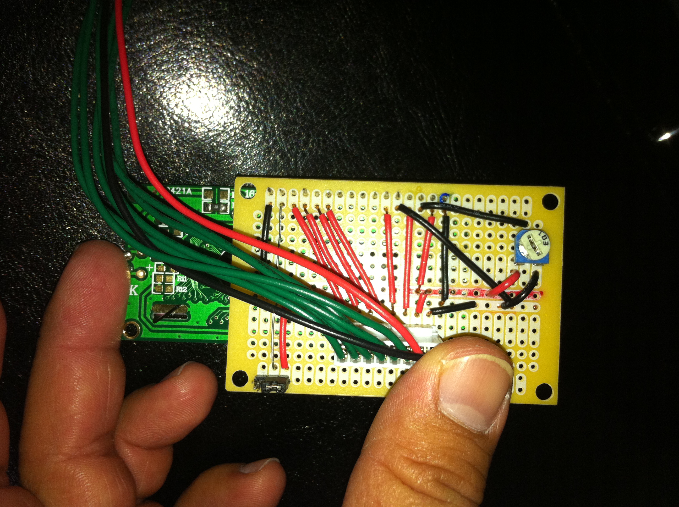

    Quick question, does anyone have a diagram on how to connect a pot to dim the lcd ?
    I bought a blue lcd and its hard to tell the characters.
    Also what value should the pot be?
    Once again thank you for your time!
  12. tronicgr
    tronicgr
    See this thread: amc1-5-connection-problem-t1440.html#p13837
    The potentiometer can be 10K up to 100K...

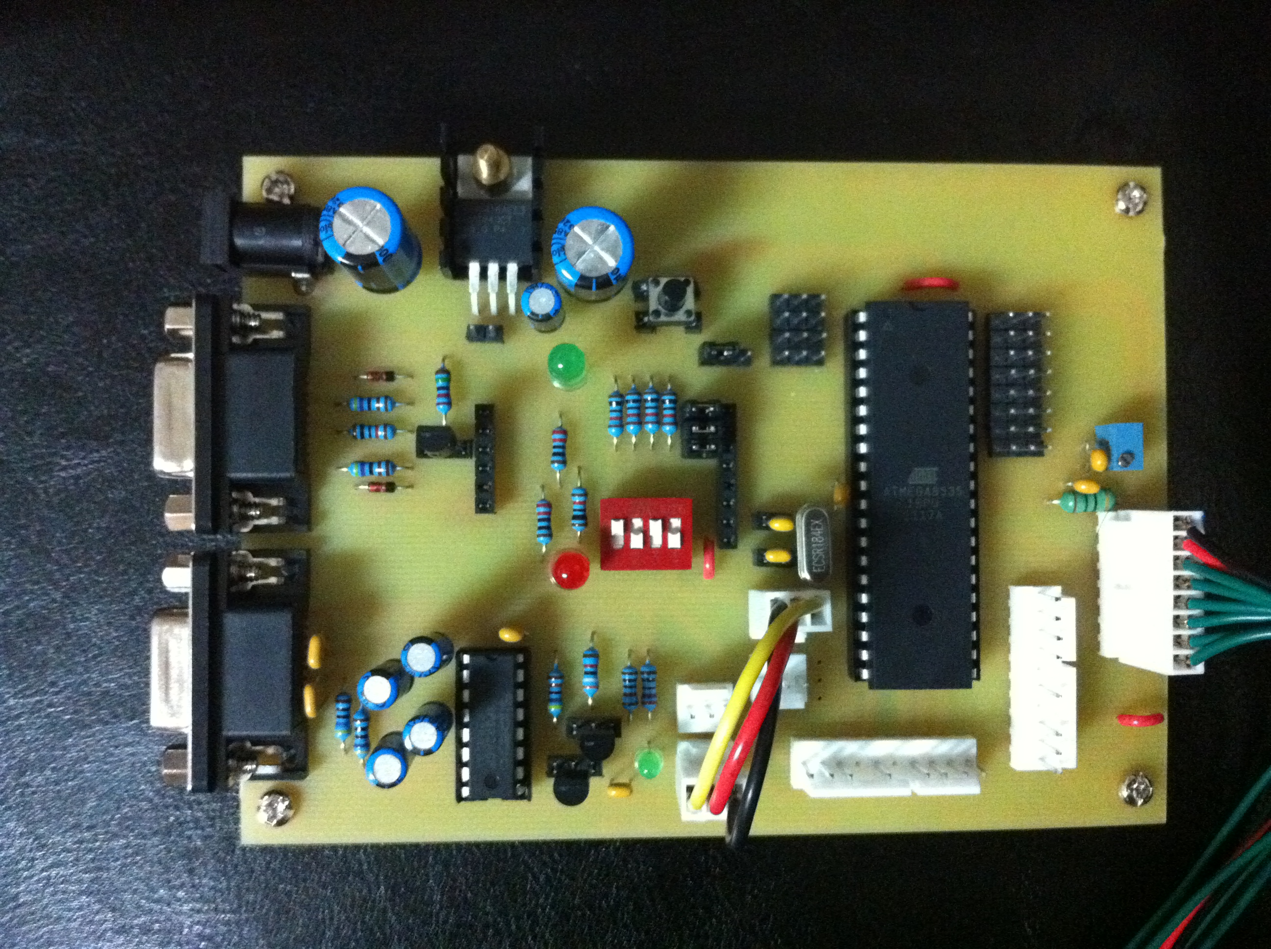

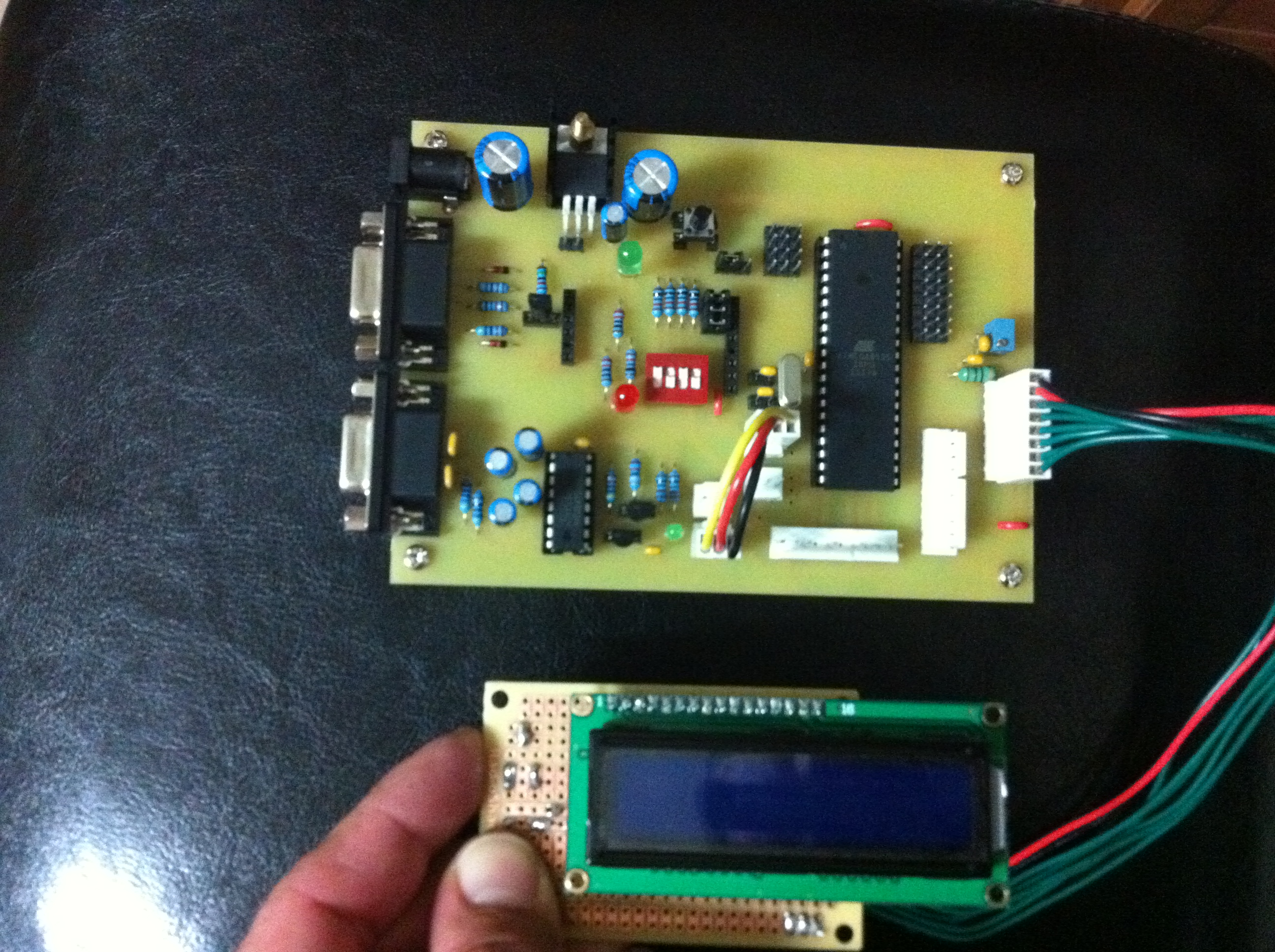

    I have follow your work for few moths now, gather all parts and finally assemble the AVR and got it to Power up. downloaded the firmware CRYSTAL18.HEX . I also ordered the Blue screen LCD and at angle can see he character just great, but looking at it straight looks like characters are in black boxes.
    Will try the pot as soon as I get the pot!
  14. xtech007
    xtech007 Member
    Aug 4, 2008
    58
    29Coins
    Got the miniture 10k pot! Works great!!!
    Here are some pictures of my board.
    Yup I messed up on the programing led. I installed a green instead of red!
    Also might be worth to new members thta when communicatlng with pony prong software i also got a error-24 .... After checking and changing crystals I notice the crystal was loose on the terminals I welded, re-seated same crystal and tried it again and this time it worked fine!

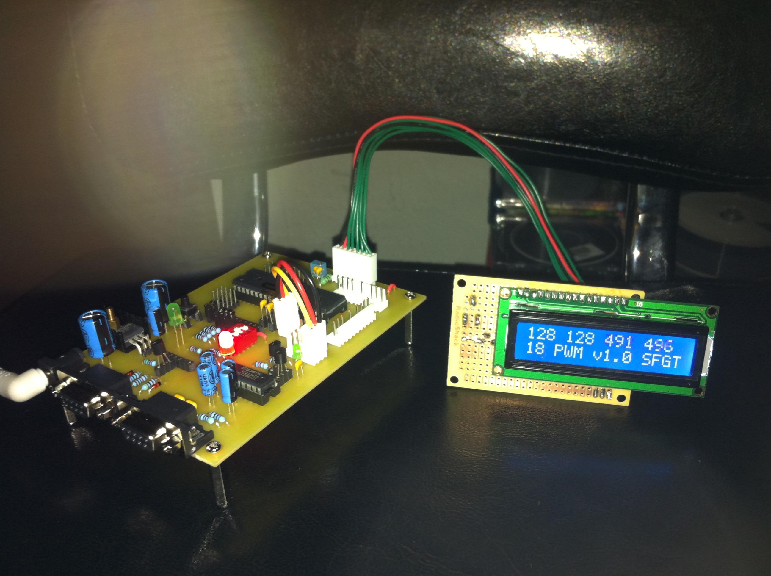

    Here are pictures of the board and LCD running!
    Now attack the H-bridge.
