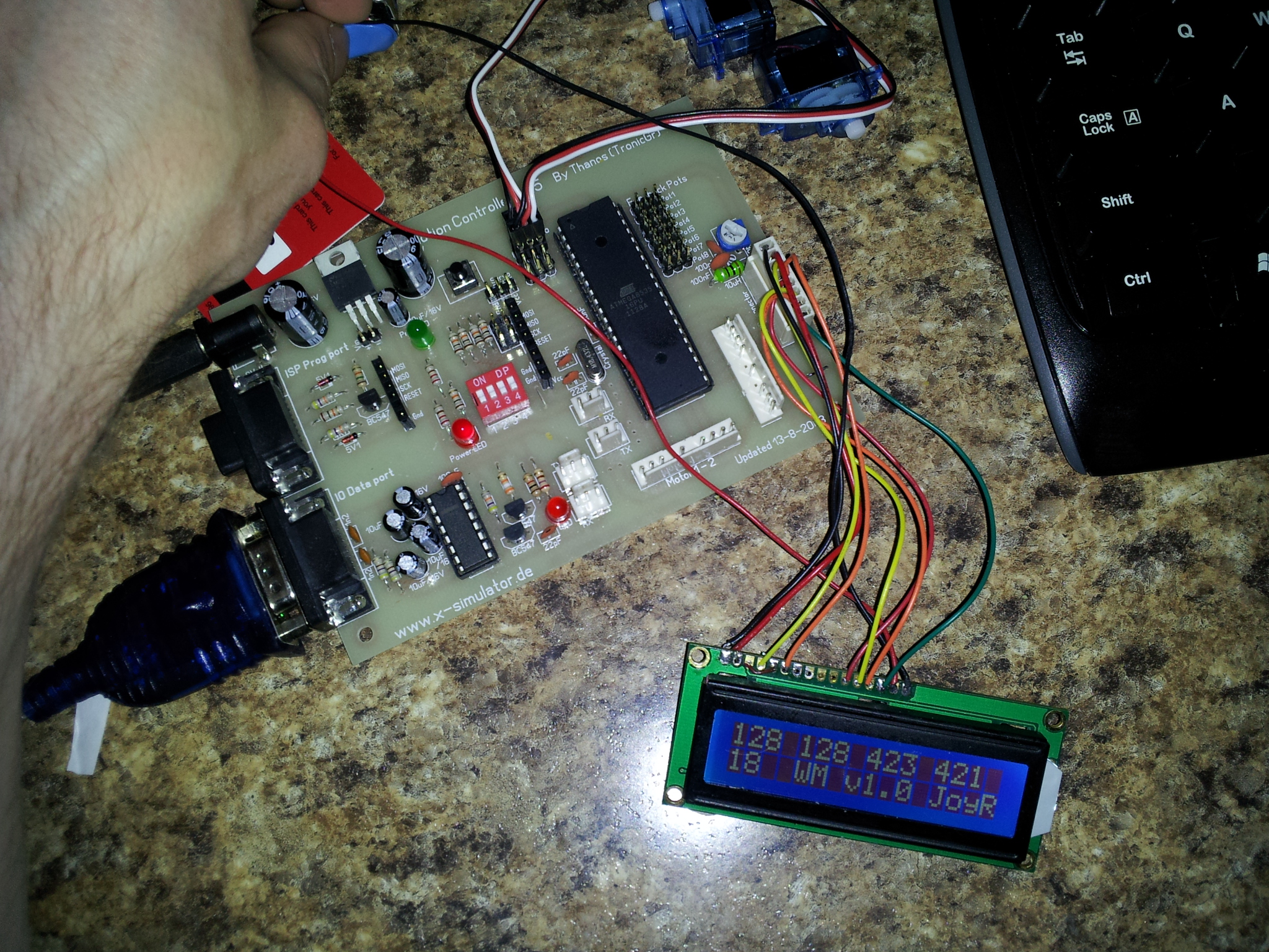

    I have finished my AMC 1.5 and successfully programmed. I start the force sender, then the profiler as in the video. I then loaded the Thanos AMC 1.5firmware into Xsim2 profiler but when I move the math sliders I do not get a response on the LCD. The first 2 values remain at 128. I've noticed a couple people early on have had this problem but I haven't seen a solution that works for me. Attached are pictures of my com settings, uso output settings and board. I've been trying to figure this out for days so any help would be much appreciated!!
    Thanks,
    Matt

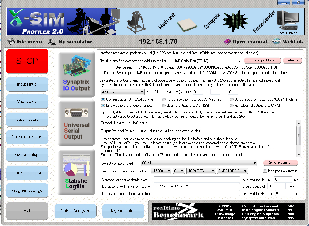

    Select comport to edit: should be also set to COM2

  12. tronicgr
    tronicgr

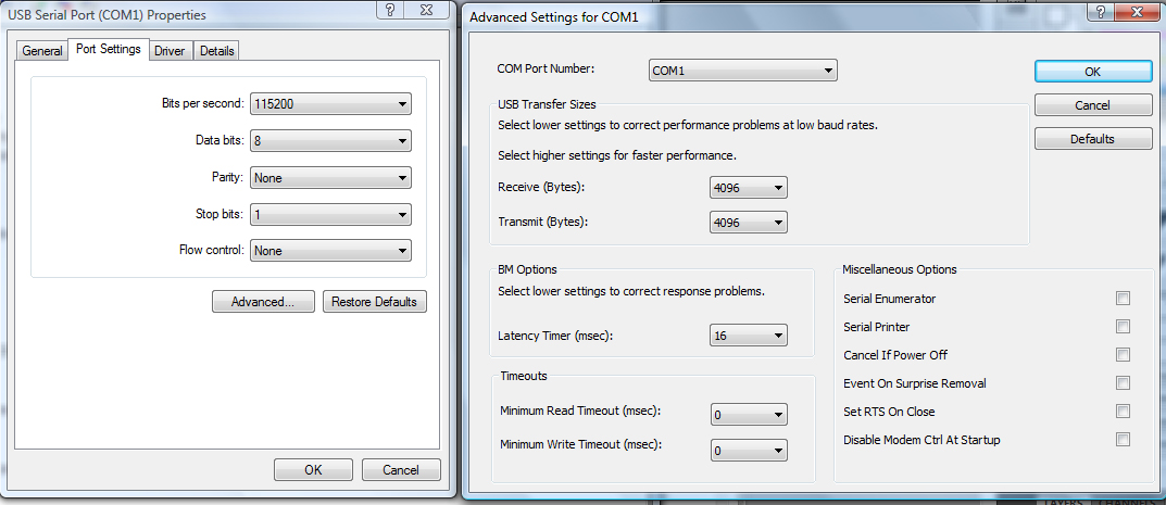

    You are missing the RX/TX cable jumpers...
    Also in USB comport settings Serial enumerator and Serial printer must be checked!

    Thanks for the quick response! Tried both of your suggestions but still nothing. I should be moving the calibration offset correct? Is there a way to check if my hardware is running correctly? It seems that there is no communication with the AMC. I have another computer with windows 7 32 bit that I'm going to load xsim2 on and try on that. I'll let you know if I have any luck but am open to any other suggestions. I'm so close just want to see some results!!

    Tried my other computer but same results. I'm using xsim version 2.1. AMC 1.5 (updated 13-8-2008). I have dipswitch 1 on and the rest off. I have rx jumper on. (also tried adding the tx jumper). Everything seemed to program fine. There were no errors and the LCD seems to be working fine. when I adjust the pots, the values on the right change. I triple checked the solder connections and everything looks good. :sos:

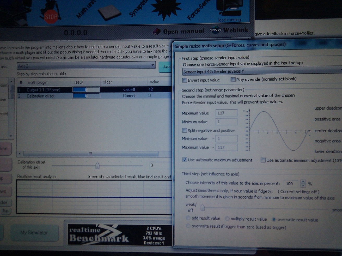

    I was having similar troubles and could not get my numbers to move with the sliders either. After reading everyone's posts on here and all the links, I decided to try to remove my axis and then re-add them to the math list. After I did that and re-added the output 1:1 math and set it to the correct sender input from the drop down menu. Finally I clicked on the start button and to my surprise it started working with the sliders and with my steering wheel. I am having trouble hyperterminaling into mine still. but at least the steering wheel information is getting to where it is supposed to go. I figure I can worry about my KP settings when I actually have a simulator built.. Still working on getting all my software/hardware up and running.. Just what to finish getting all of this tested. Now off to test my H-bridge. Also need to test make sure it's receiving the information from games too... So much to do. Good luck..

  18. tronicgr
    tronicgr
    For AMC1.5 you should use USO interface only. It doesn't have plugin for autodetection by the interfaces yet.

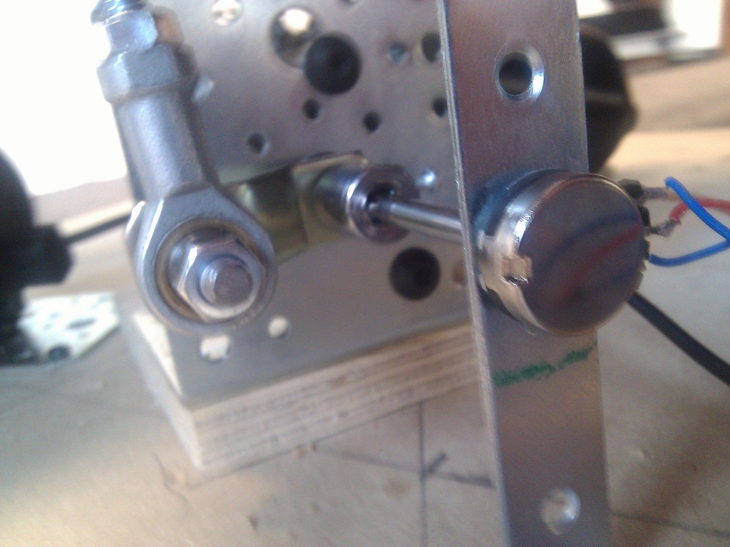

    So everything seems to work for me....i can move all numbers on the lcd.
    But when i connect my potmeter to the shaft of the motor and for example i step on the gas the motor moves one way but keeps turning that way....so i give some gas and it goes in onedirection.
    if i brake from center position it goes the otherway too but alos keeps turning....
    I made the Sim like Sato the switch nr 3 should be on, right or should it be off (joyrider)
    Both dont work by the way. I'm sure it is something stupid, but right now i cant see it.
  20. tronicgr
    tronicgr
    Swap either the two motor power cables or... either swap the Positive - Negative cables of the potentiometer...!
